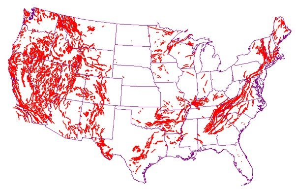

The SW deserts are on the San Andreas fault. There are literally hundreds of fault line fingers running off of the main fissure. The soil is mostly sand and rock. No doubt that added $150 cost to pour a bond beam accross the 2 doorways at the weakest point in the structure is a reasonable caution in my opinion based upon 35 yrs building experience in this SW desert area. I've lived through more big quakes here in the last 45 yrs than I can name including the 7.3 Landers quake.
I think you are referring to SW CA, but SW high deserts occur many places in the 4 corners states, and these are not earthquake prone regions.

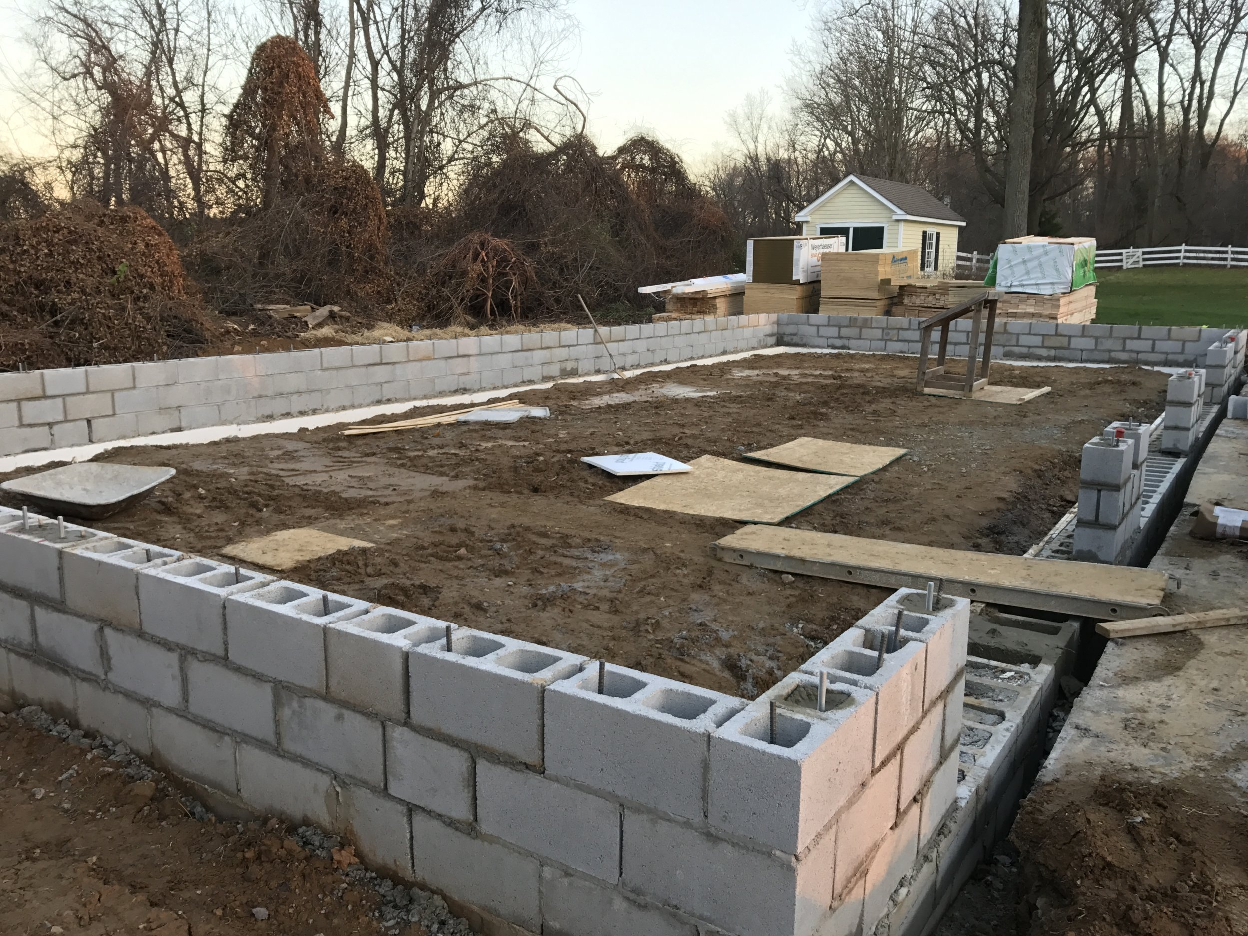

Yeah that’s understandable. A lot of the old school guys did that, but then you only had 2-3 ton cars going in and out. I always view construction from a commercial or agricultural aspect and we always did a continuous wall with rebar. I think we even left out a course of block and poured the entrance part of the slab thicker- like 12” thick across the mouth of the opening for a few architects. Always was an ”overbuilder” and some of my subs hated me for it. lol
Here’s a 60’ x 30’ I built with 30” footings and 12” block below grade filled solid and vertical bar. Switched to 8” filled solid above grade
If I was building an actual shop I’d build the floor sturdier but when I’m building a residential garage that’s only getting 8ft tall doors there’s zero possibility of dump trucks or something else heavy. I’ve set pallets in the garage with my skid steer though and I’ve never cracked a floor doing it.
I suppose you are correct so long as you do not live in one of these areas (see US fault map)
