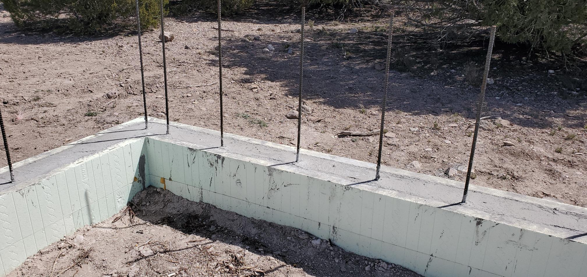

Did my pour yesterday. All went well. 35 yards of concrete (4,500 psi winter mix - achieves 1,300 psi within 24 hours). Got kind of crazy with 3 concrete trucks all up on the property at the same time (plant messed up the truck spacing - was supposed to be 4 trucks total with 1 truck every 30 minutes).
Total concrete cost = $6,800 (that also includes house footing - as I am building both at the same time)
Temps in day at 43F and night at 22F. Concrete stayed at 40-42F even at night.

   / Detach 48x28 Garage - Footings #24
About to break ground on my 48x28 detached garage and on my engineering footing schedule it doesn't show any footings where the two 18' wide garage doors are. I know they are not "required" as there is nothing being supported wall wise there but someone told me that it's "better" to pour the footing under those doors as to keep the whole garage footing as a rectangle, making it stronger. One would run the horizontal footing bars but no vertical bars would be run since there is no wall being stacked on top of that area.
Is that true? Should I run a continuous footing underneath the garage doors or stop at the door area, and then restart again?
My engineering calls for a footing that is 18" below grade, 24" wide, 12" tall, with three #4 rebars at the bottom of the footing. Garage will be ICF (Insulated Concrete Forms) so I will be stacking ICF (6" concrete core) for the garage walls. I am using 4,500 psi concrete footing pour.
Ifn' ize you, I'd wet set them blocks in the footing. Lay them until just above top finish grade of slab. Then I'd pour the first blocks full of Crete directly out of truck. Pop chalk line around inside and pour away. You can tie wall to slab with rebar. Tie block to footer with rebar. I have been building with ICF since early 1990's.
