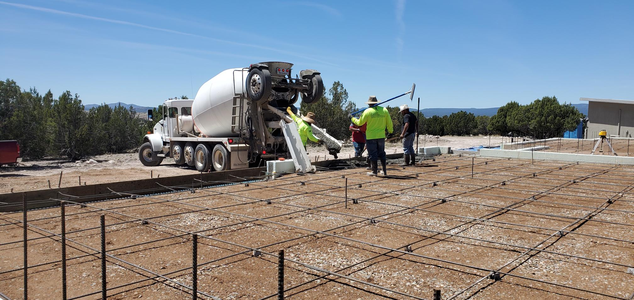

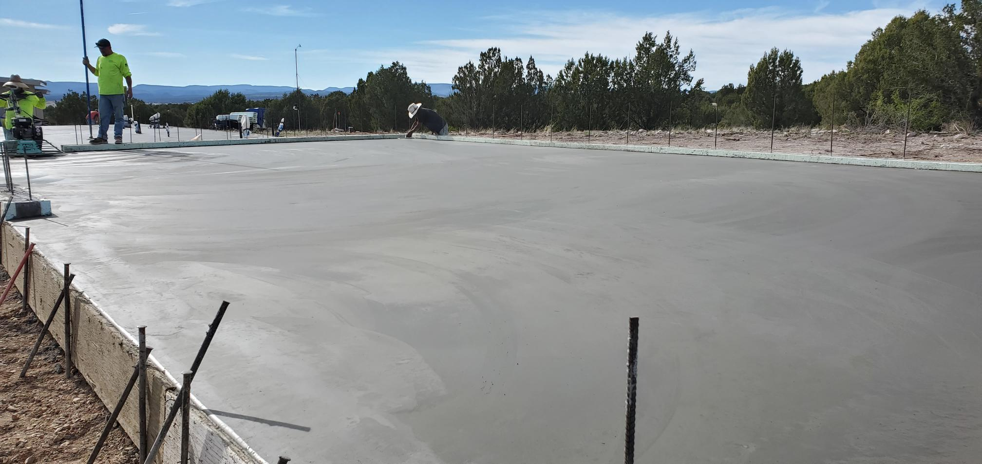

30 Yards total - 4,500 psi mix - 6" thick slab
$6k in concrete

Looks nice!
I don't think that cold water on warm concrete should be an issue. A sprinkler should be fine. I would just check that the corners / edges are staying wet.
For a different perspective, on the last job here, concrete was running closer to twice what you paid.

$6k was just the concrete cost. Labor was additional, around $2,500 for the garage labor. That included installing & compacting the AB under the slab, rebar install, pour work, and finish work. Crew of 6.
I didn't want to pay extra for a boom pumper ($1k) but the chute was just long enough to work.
