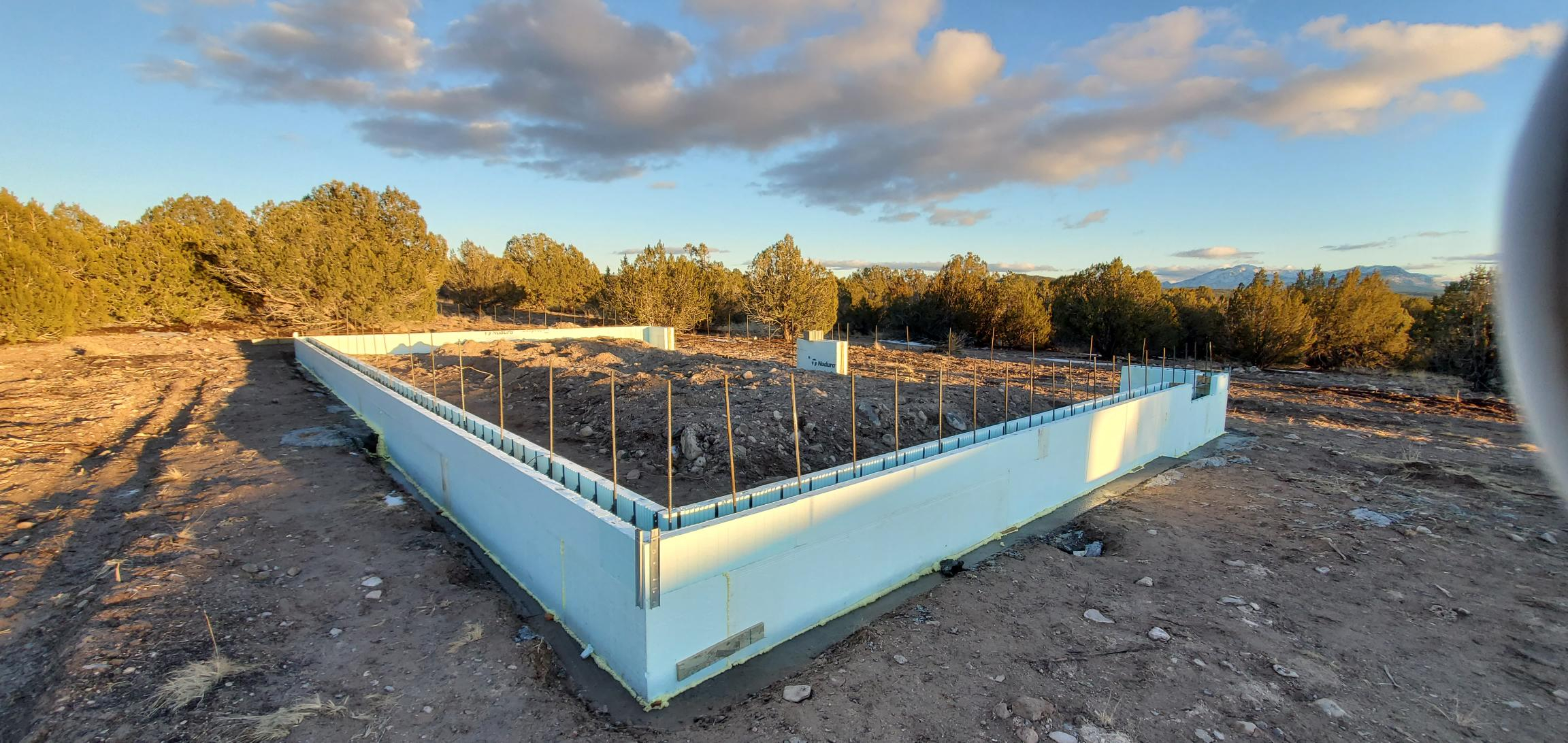

Are you pouring footing and then slab ? Or slab and footing at once? Yes, either way full perimeter footing. Either way I would break it into two 24x48 sections with a piece of keyway. That slab will crack if you don't. Use re mat and not just fiber. Okay re mat and fiber, re mat only is fine, but not fiber only. A slab that rectangular is going to crack. Keyway is cheap and easy to install.
Aw it prolly won't crack... Ask them to put that in writing or put in that keyway.
I might would do a grade beam if doing two pours. Are you wet setting the ICF or leaving vertical rebar and spray foaming blocks to slab above grade ? Lots of energy loss at footer if above grade which defeats the purpose of ICF to begin with. I always poured inside the blocks, I mean set the blocks on below grade footing, popped chalk line and poured the slab. I have glued them to top of an existing slab when adding a safe room. You could be doing for storm resistance, but with garage doors, I think not. They'll blow out if a tornado is in the county somewhere. I was in a shop fixing to skedaddle out of there and a drum door blew out. So much for hurricane doors. But, it was a 14' drum door.

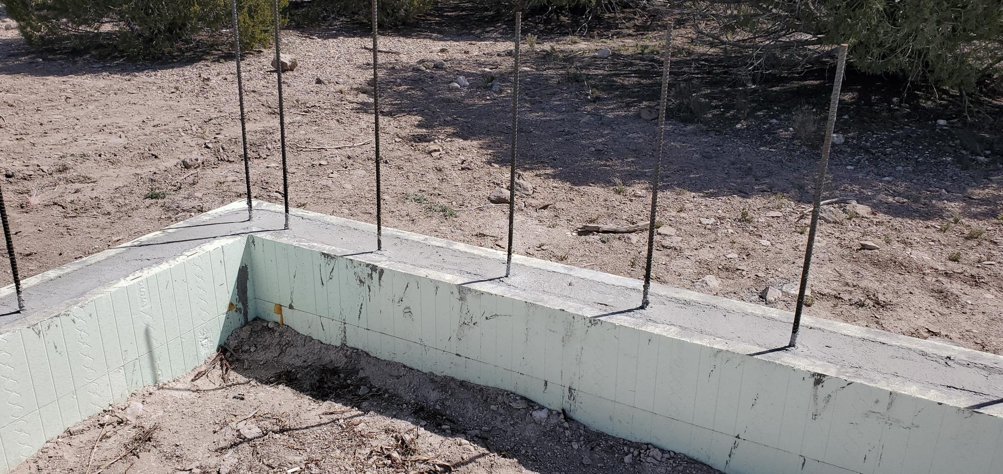

We glued the ICF to the footings with spray foam and then poured the stemwall. Filling in the garage with AB and compacting before we pour the slab.
   / Detach 48x28 Garage - Footings #44
I always made a wooden trough that fit the top of blocks. 4' long and top flared out. I'd have concrete truck drive around perimeter and pour the blocks to just above slab top grade. Once you pop your grade line, you can go around with 18" or so rebar pieces and stick them through foam and wall concrete will tie to slab Crete when it's all done. You may can lay another row of blocks before any more pouring. Just as long as they can reach over from outside and trowel concrete to hold the chalk line around edge. When they get a grade beam established, they can finish the slab. Make sure if you have any electric, gas, plumbing, do it now. It you think you might in the future, make extra wall penetrations. I run them through wall and hit an inside wall so I can conduit from outside all the way to the attic. That's one of them oh we don't need that, oh we are so glad you did it.

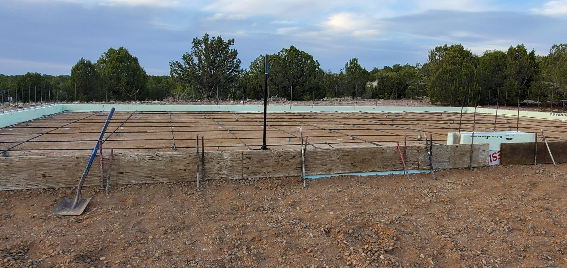

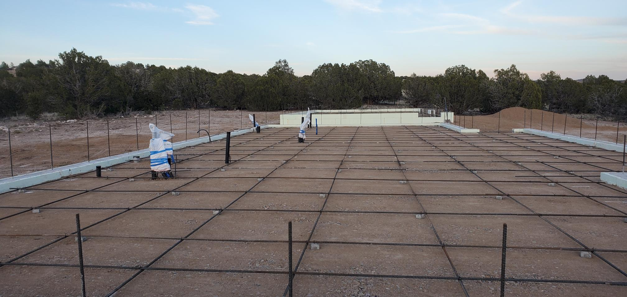

Going to do my pour tomorrow.
6" slab on garage with 4,500 psi mix - #4 rebar @ 36" oc
12" turn down on garage entry
4" slab on house with 4,500 psi mix - #4 rebar @ 36" oc
Almost 50 yards total of concrete.
