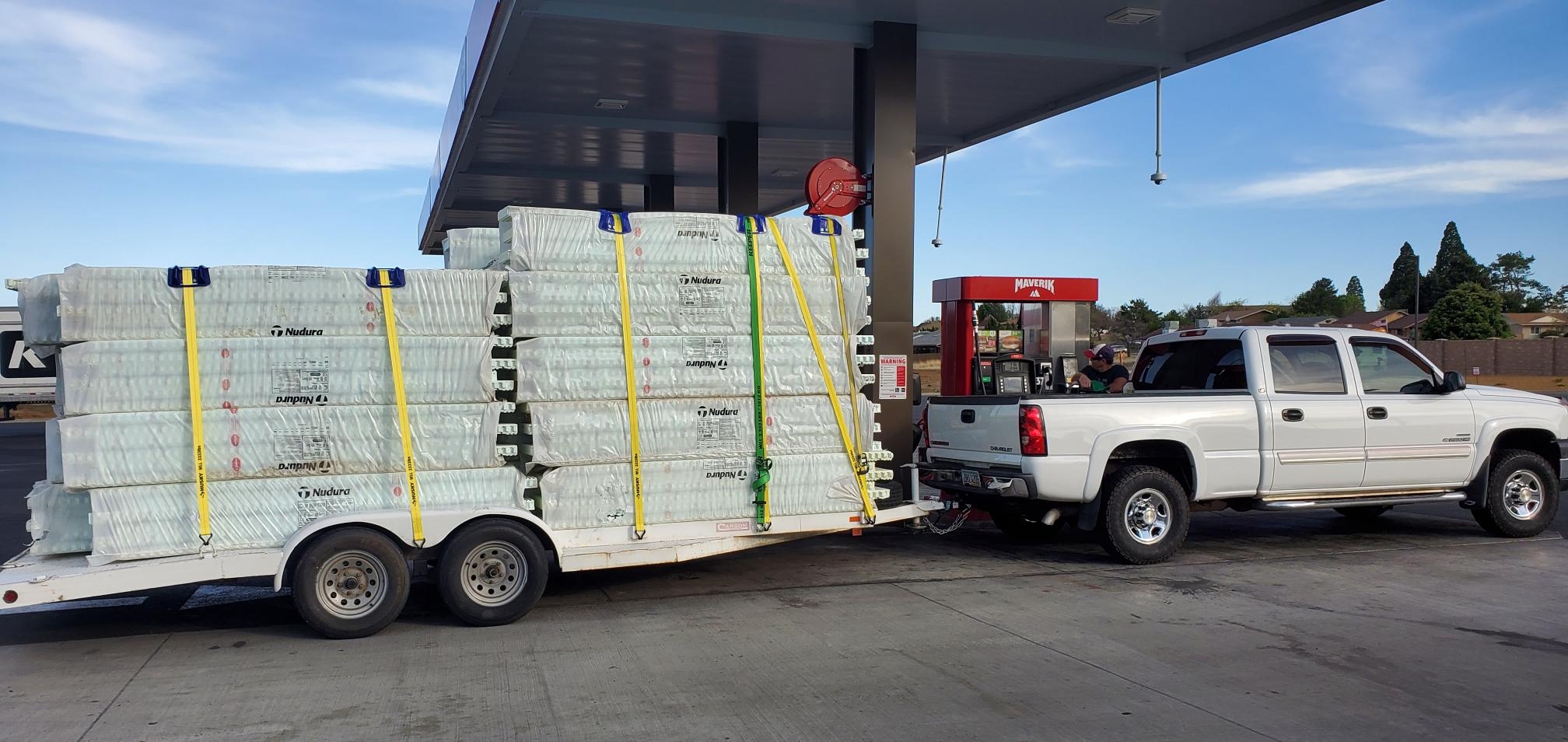

The 53' semi trailer can't make it up my driveway. So I was think of unloading on the street and placing the 48' beam on the 18' long trailer (see pic). Of course that means 30' will hang off the trailer but if we strap down the beam to the trailer, I don't see an issue going 10mph up the driveway.
   / Detach 48x28 Garage - Footings #79
I’ve been down this road before….32’ door on 20’ trailer
Put some pallets/cribbing on the tail of the trailer
   / Detach 48x28 Garage - Footings #80
negative tongue weight?
