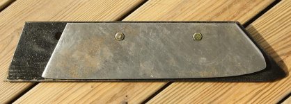

There's only 2 holes in the share that's on there. I took it off and straightened the frog with a few whacks of a 3lb hammer. I'll see about getting a different share. Need some more bolts too, had to take them off with a cutoff wheel.

I don't think it uses a ford share. This Leinbach says it uses Ford parts. Notice how the 3rd bolt is offset from the other 2? On mine, they are all in a straight line.

The pictures show your plow is NOT "just fine". As you apparently already realize, there should NOT be a gap between share and frog. And there is OBVIOUS wear on the leading edge of the share. 99 times in 100, that'll be the cause of a plow not wanting to "suck" into the ground.
Once you find out what share will fit your plow, look for a "rock share" or "deep suck share" to fit it. They'll have a little "nose" on the point that starts the share to digging in under tough soil conditions.

Took the plow to the New Holland/Kubota dealer today and he said the bolt pattern wasn't anything he'd seen before and the old share didn't match up to anything he had in the back. He suggested trying Tractor Supply. They didn't have anything and didn't list any 12" plow parts at all in their printed catalog.
The JD dealer took my share into the back and came out with a 14" JD share that fit the 2 bolt pattern on the old share and said to just cut off the back 2". For $15 I thought I'd give it a try. Think it'll work? Thought I'd mark where the 3rd bolt would go and see if the machine shop could drill and countersink it for a full head plow bolt or a regular countersink bolt. I doubt any of my drills could cut hardened stuff and I know my countersinks would just round off.
Here's a pic of them bolted together to show the difference in the profile. --Ian
