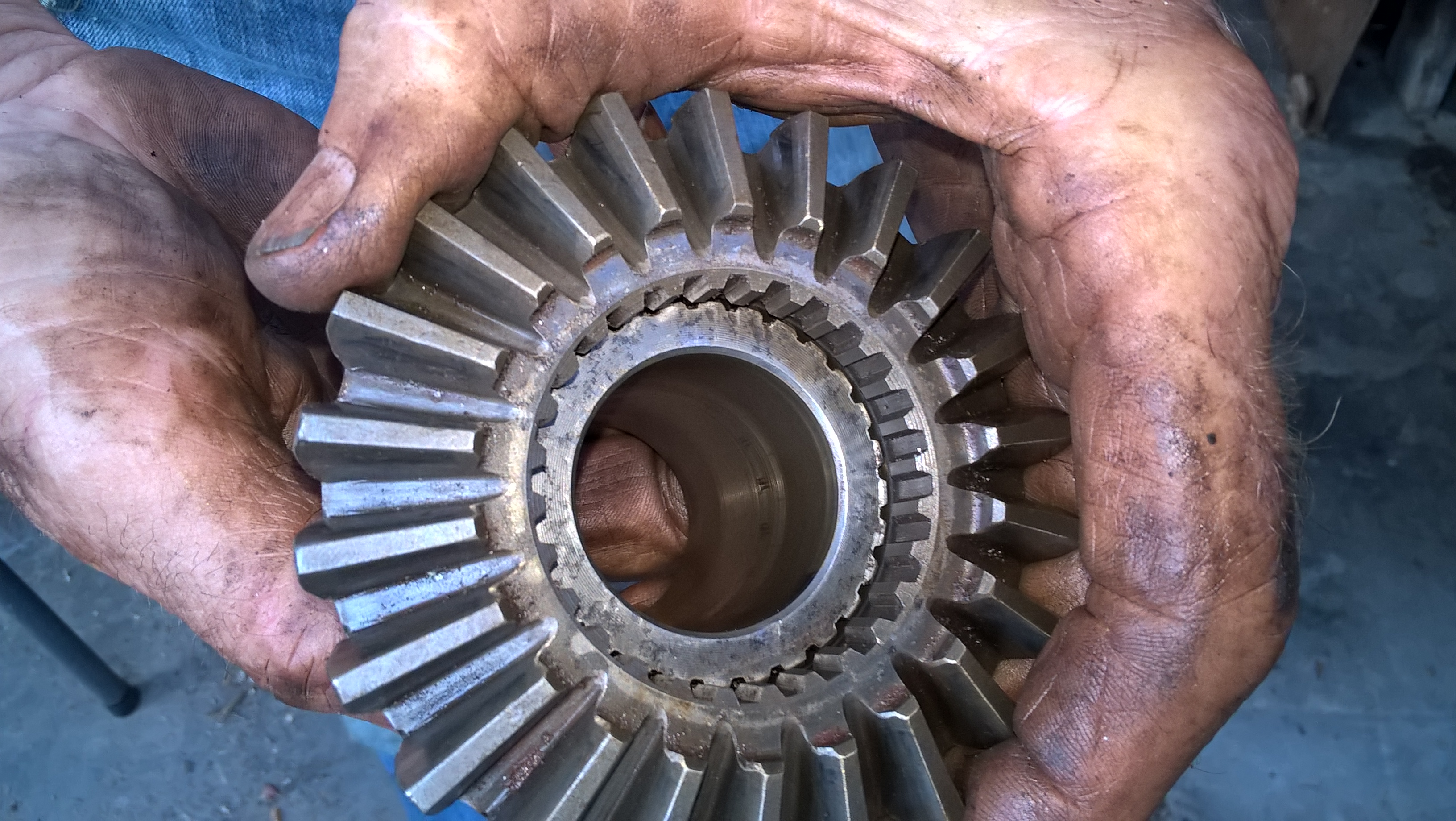

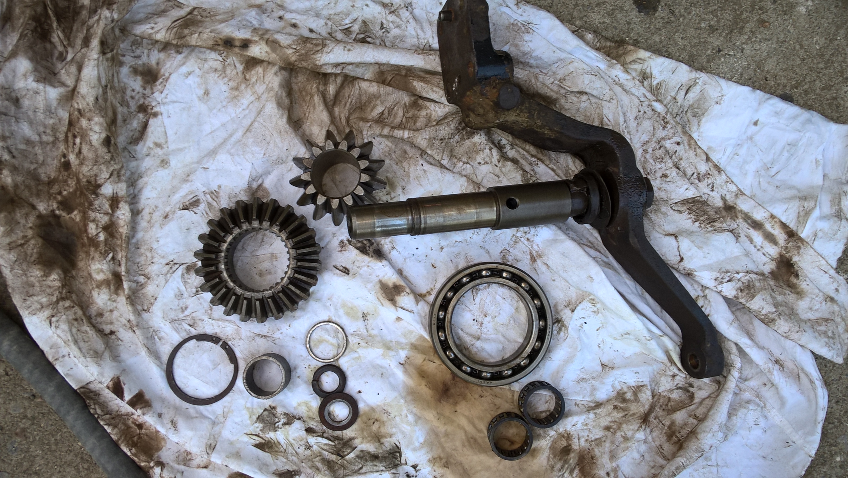

A bit of elbow grease is all that was needed to get the top spindle-bear-bottom spindle assembly down out of the housing. In my opinion the parts all look serviceable if not pretty decent. There's a bit of wear on the top spindle gear but I don't think it's enough to warrant replacing it on a ~40 year old tractor so unless. However I'm open to suggestions. Here are a few photos of the parts all removed. I've got new bearings on order, new dust sea, new needle bearings, and that's about it. I think I should have this back together as soon as the parts arrive. Hopefully no other trouble.
Thanks to everyone (especially winston1) for the help. I hope the next person that has this trouble will find this thread and find it useful. I'll post some more photos when I get it things re-assembled.
Regard and many thanks

Hi California-
No you didn't miss the diagnosis. I was looking for/expecting a smoking gun- broken gear or piece of metal jamming things. That's not what I found.
My process went something like this:
  • Removed the wheel - things still won't turn
  • Remove the knuckle - knuckle portion turns freely but the rest of what's connected to tractor won't
  • I pulled the center drive shaft that bring power into the front differential back from the center differential; passenger side turns freely, what's still attached to the drivers side does not. conclude problem is on drivers side somewhere between the front diff and the bottom spindle gear
  • basically remove everything from the bottom spindle gear back to the differential and separate.
  • when this is finally down to just the bottom spindle gear-bearing-top spindle gear, this is the only section that won't turn. Finally bash that out and separate into what's the the last photo. Bearing does turn but it's pretty sticky; however it would not turn- no way, no how- when it was in the front axle top cap.
The gears don't look perfect but they do look alright. When the problem first arose I stopped immediately not wanting to break anything. It's possible if I had just kept going it might have freed up. I've got to believe this problem is from overloading the bucket and putting too much pressure on that bearing. My best guess is that the pressure got that bearing to shift in its housing such that it was cockeyed and that caused it to bind up.
Although I'll be disappointed, I won't be surprised if getting it back together there's still a hitch somewhere. But for now I'm taking comfort in that seized bearing and the fact that everything else seems to be okay. At least now I know how to get this all apart.
