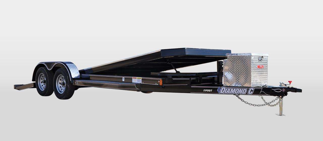

I looked at their site and it seems Diamond C makes a full deck tilt as a car trailer model 11FBDT. That model has 2 5200 lb axles but has a GVWR of 9890 lb. All higher rated trailers seem to have a stationary section of deck.
11FBDT | Diamond C Trailers

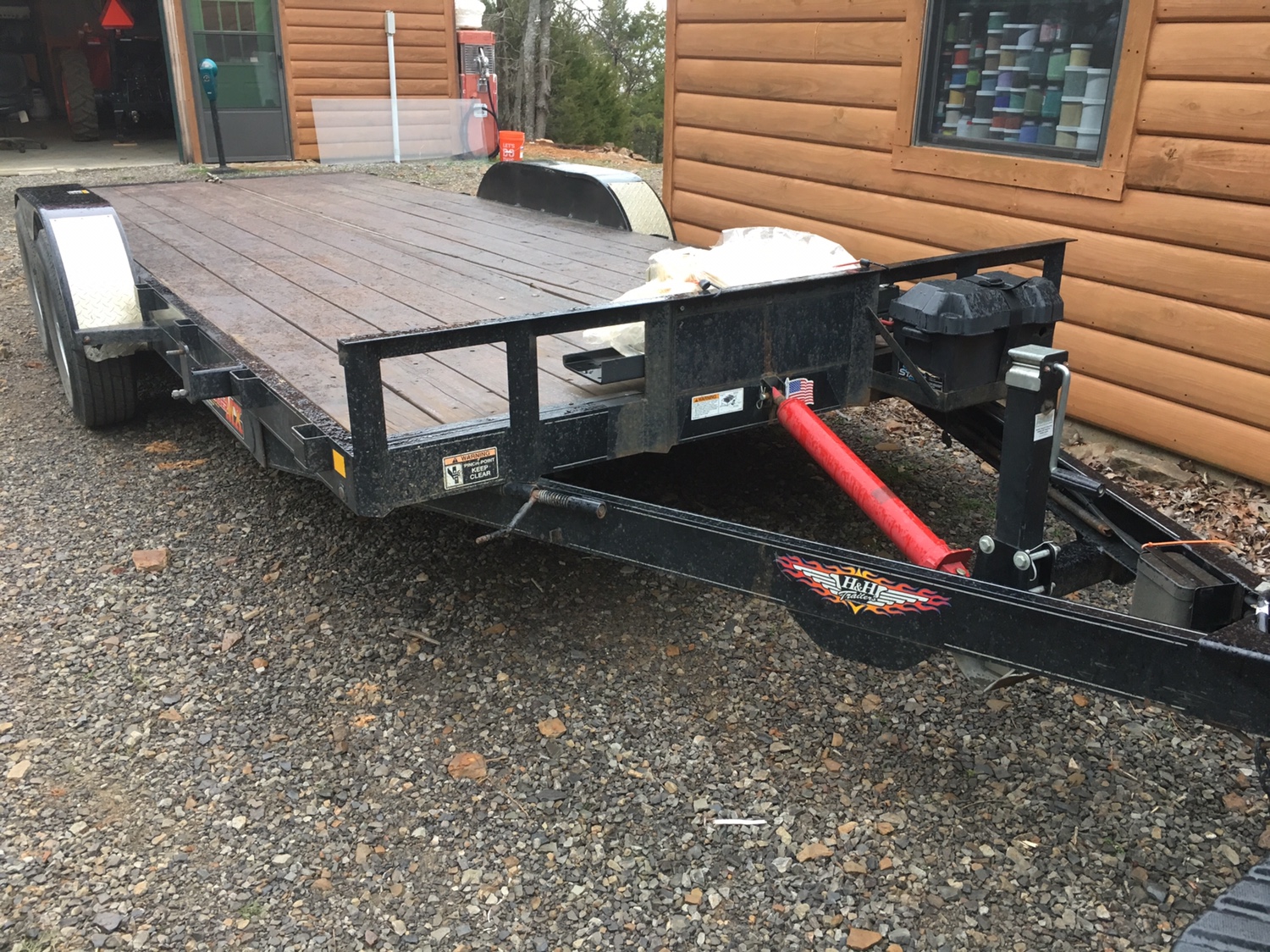

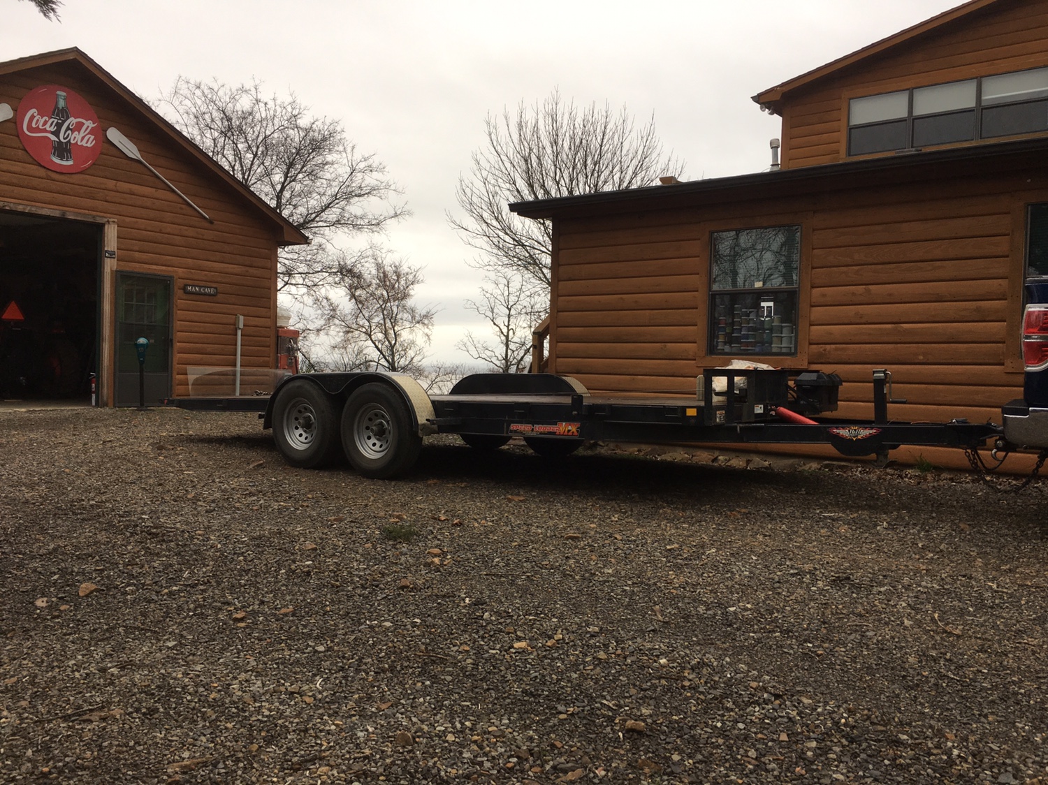

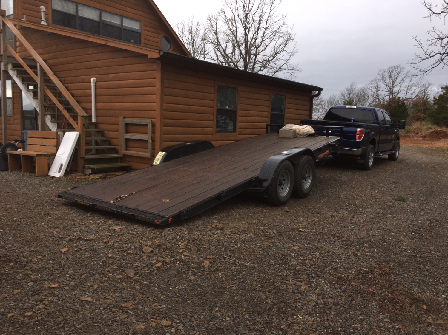

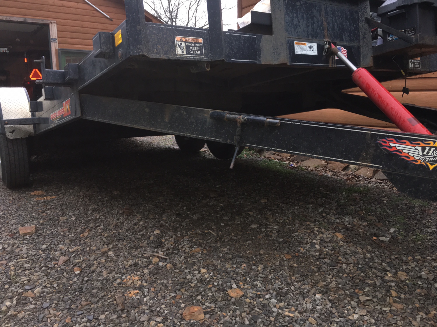

Here's my H&H Speedloader. It is 22 ft. Full tilt deck.
It is covered with motor oil/diesel mix.
The deck doesn't get slick when wet but I expected it to.
It takes 35 pumps on the ram to set the rear down on level ground.
It has 5200 lb axles x 2.
I'm not sure about the balance point yet as I bought it used and it has a 10 k winch, battery and a spare tire under the front weighing the front down.
I plan on eventually moving the winch off the deck and to the front tongue area. Since the ram is occupying that space and a battery is already installed, I'll get a hydraulic power pack then. Maybe.
It is the best trailer I've had to date of about 10 through the years. One perk I like is the enclosed rear LED lights totally protected. Nice touch.
The 48HDT is available with a full length tilt deck, just not common and no pictures on the Internet that I can find. I'm going to call Diamond directly and see if they can send me one.
