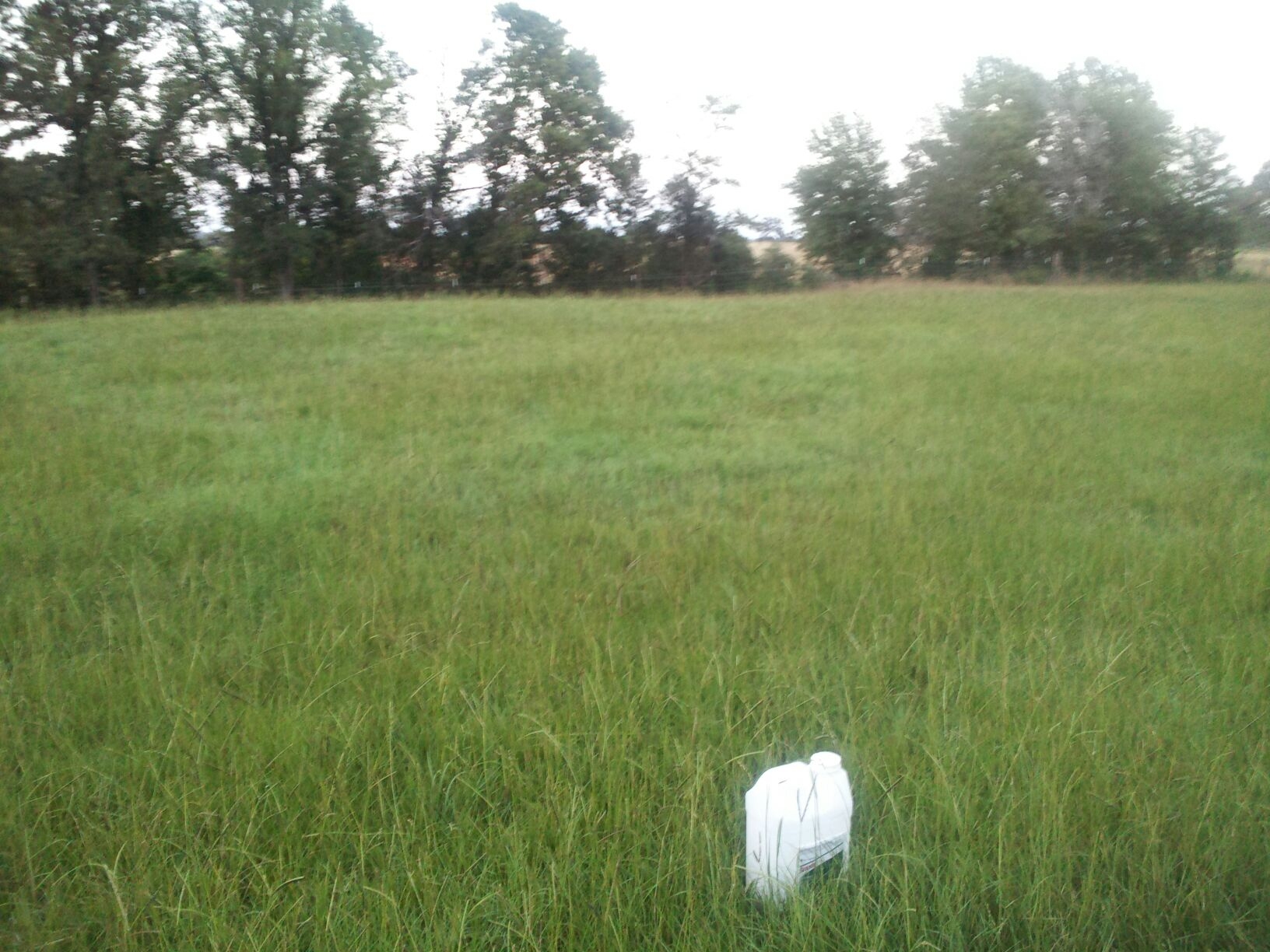

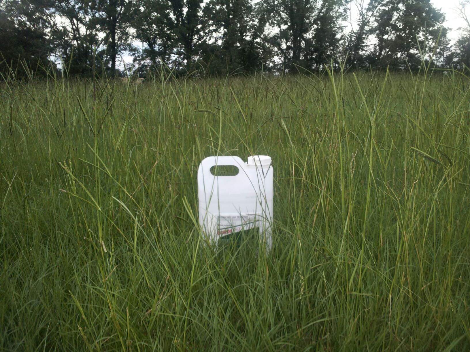

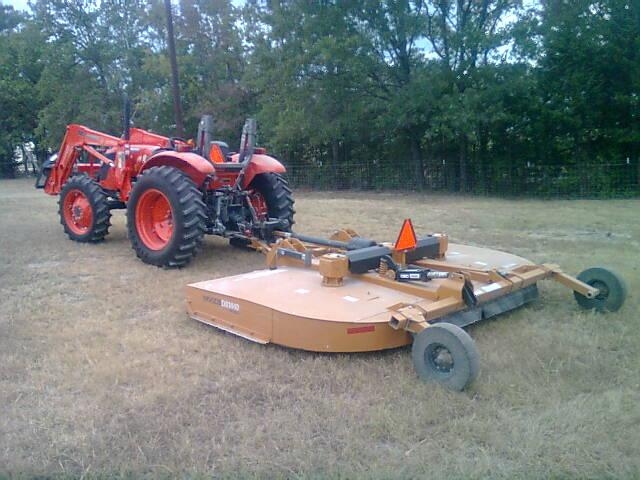

This one is at my house(300lbs) triple13 and overseeded in common and has alot of coastal in it,just 2acres.Actually was part of my yard but I thought it would be fun to see what it would make.Here is a photo of me mowing it last year 5040 and ds1440.JPGyard2.JPG I will get photos of the place with grasshopper on it,this weekend.

Looks healthy!, now if you can keep the hogs out of it!
This pasture has field fence all the way around,with a 100lbs pitbull on watch:D The two hogs I got were on the outside of the fence about 30yrds the other day but they didnt make it out are place:laughing:
