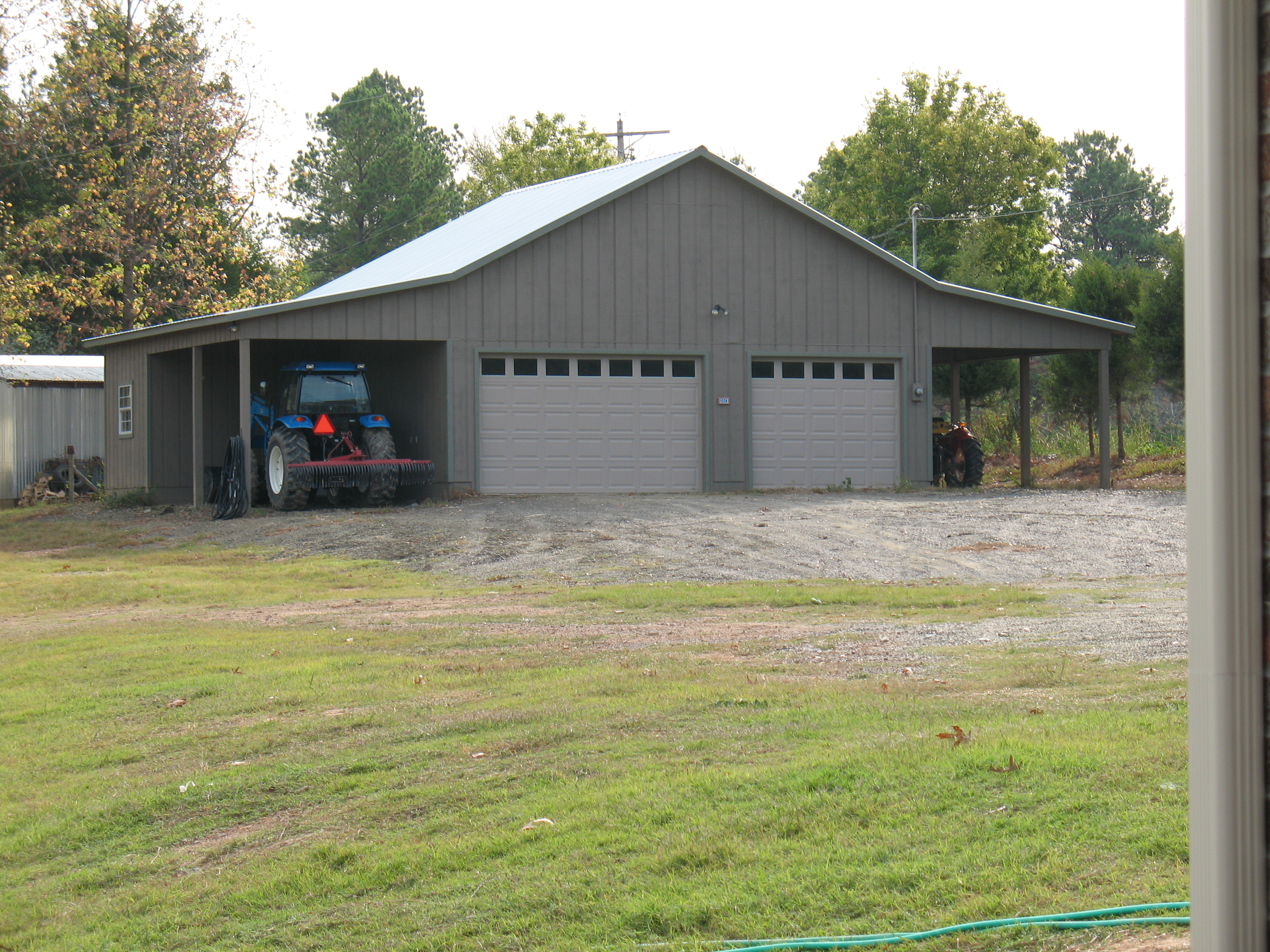

In 2009 I compared cost to built a steel shed vs wood frame, both on concrete slab, and found that wood was much cheaper at the time. Steel may win out now or vice versa due to cost of materials. I built a 30 x 30 with 12 x 30 wings on each side. One side I took in a 12 x 12 section for a bathroom and additional storage. After a year or two I found that this was not sufficient so I added an additional 30 x 14 fully enclosed and insulated shed on the back for storing my boat, fuel tank and lawnmowers. The front 30 x 30 holds my truck, one car, my Goldwing motorcycle and a work space for my welding, etc. I am just about out of space again. Both tractors are stored in the lean to sheds that are open on the sides. IMG_0836.JPG This is an old photo of the shop prior to putting on the back shed. Cost to build in 2009 was $30K. It is fully insulated, wired for 220v and 110 receptacles all around the walls plus outside in the wing sheds. Interior is sealed with1/4" plywood. Both garage doors have electric openers. I can get my Kubota B26 inside but not my LS. The walls are 9 foot studs setting on 1 course of cinder blocks so the garage doors are a full 9 feet high. There is also a fully floored attic (center section only where there is 6 feet of head room) for additional storage of small items.

That is very nice building and love how it's laid out with the covered parking areas on both sides! I like the different door sizes too. Looks like you put LOTS of thought into it & ended up with something extremely useful.

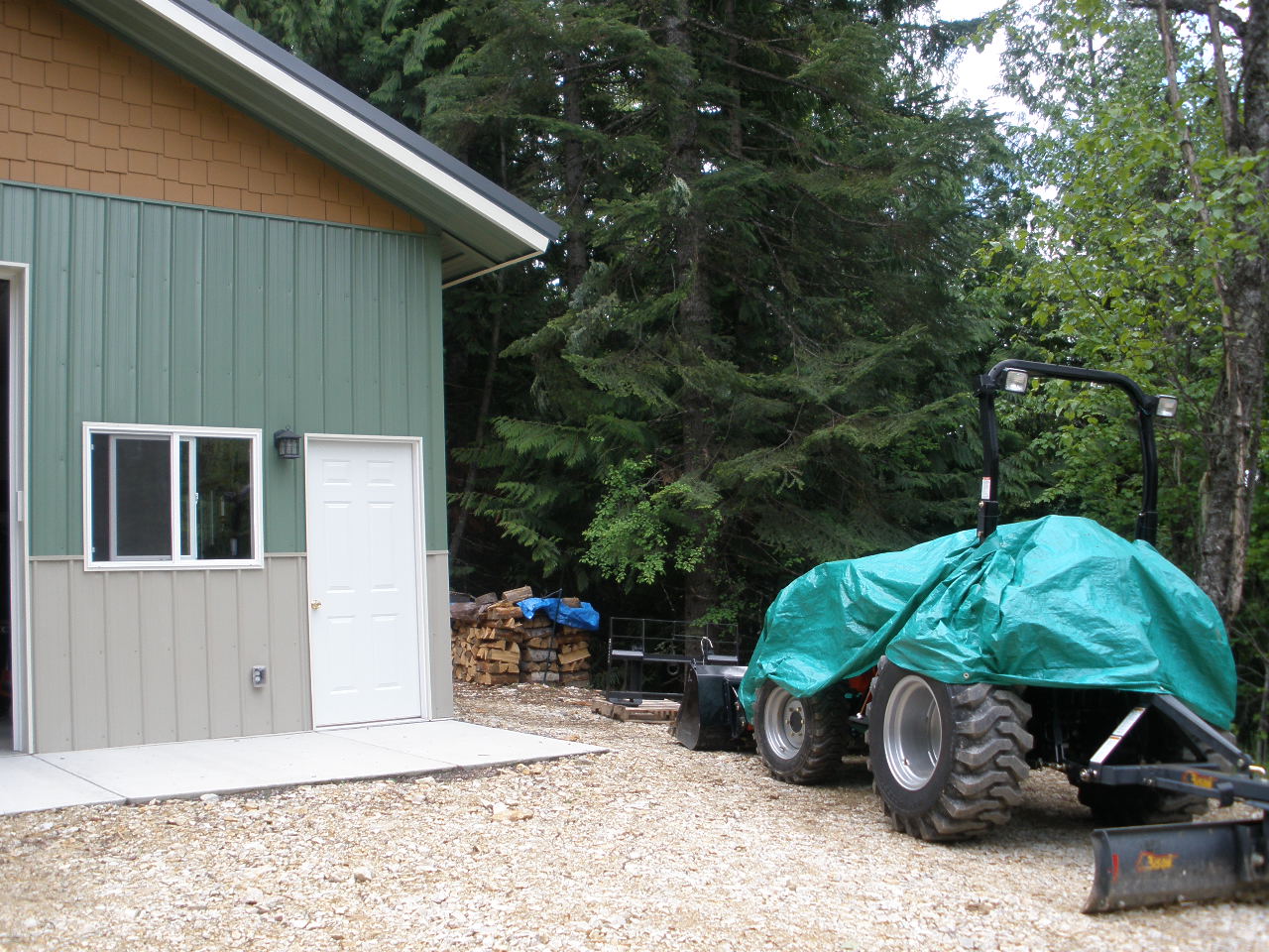

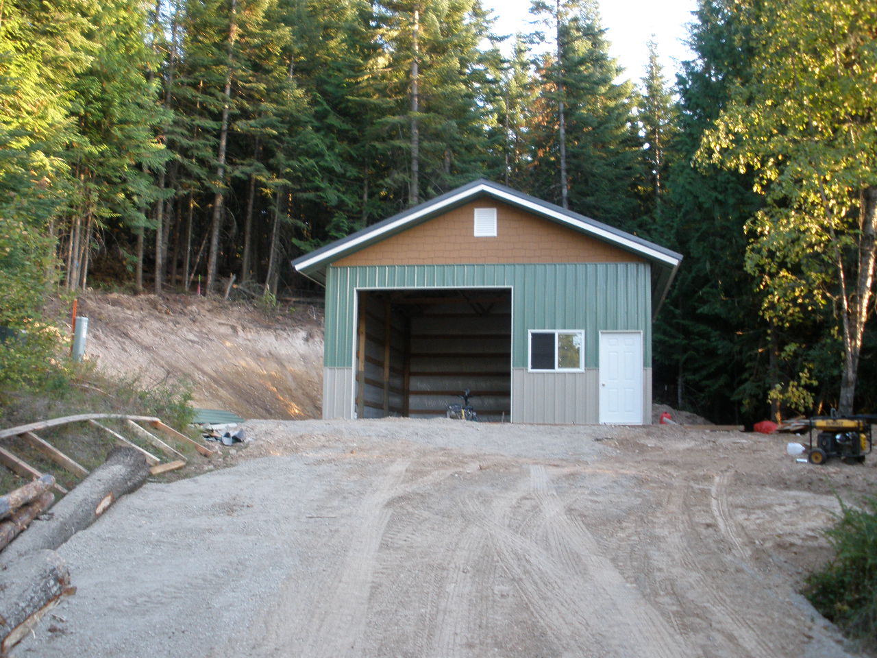

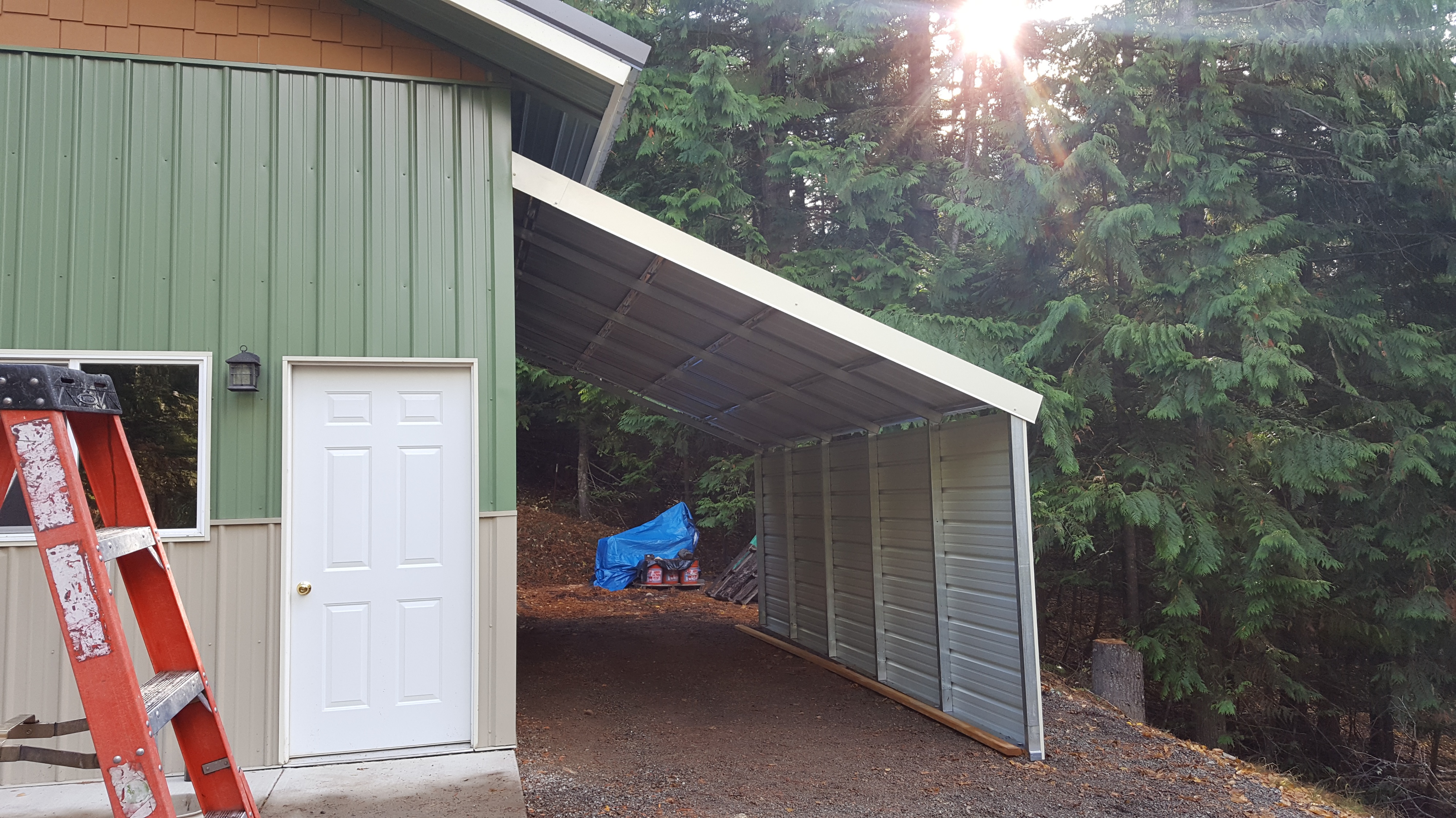

I started with a 24x30 pole barn to park my truck and use as a work shop. I stored the tractor outside under a tarp but I found that inconvenient and added a 10x20 lean to for the tractor. Anything over 200 sq/ft required a permit and engineering. I wish I knew in advance how ea$y it was to make more flat land and I would have added to the pole barn from the beginning.
