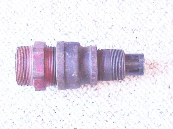

Here is a picture of what the pump mounting would look like. The bung (1 1/2") will need to be increased in size with a 2" x 1 1/2" female to female adapter and a 1 1/2" close nipple. The picture shows a short 1" pipe for clarity only. This pipe will actually be long enough to reach within 6" of the bottom of the tank. The top hex adapter is 2" x 2" and has a 1" pipe thread in the middle that the dip tube screws into. Your electric pump will screw into this. Some brands of pumps might already be set up for 1 1/2" bungs and all this will not be necessary.
