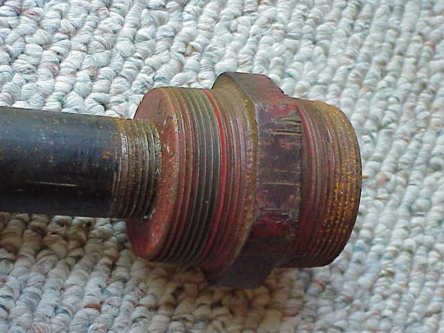

Picture of 2" x 2" x 1" bung adapter.

Junk where do I look for a 110 volt pump with an automatic nozzle? Do you have anything like that in your garage that you are looking to clear out? /forums/images/graemlins/laugh.gif
BTW the pump bung is 2" on my tank.
