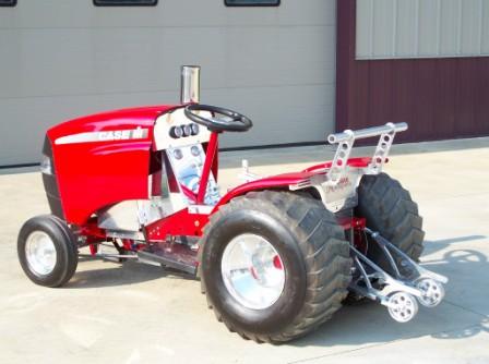

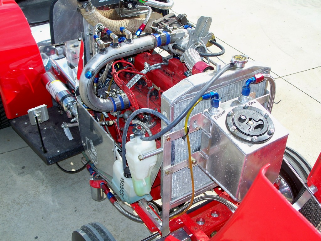

We have been working for 3 years to get a diesel class started. Been pulling for 2 years with a diesel, about 12 with various gas engines. There are a number of tractors running and being built now. In Columbus, Ohio in January there will be a big indoor pull where a lot of them from across the country will pull.
We use a Cub 582 frame and built a D1105 Kubota 24hp 3 cyl engine making around 100hp now. We have a machine shop and build these and parts for these. Actually the economy has helped us because we are getting pullers who have pulled the big ones and look at these and say it's cheap because for the price of two turbos they can have one of these little tractors. Some guys we do work for run one of these and a big super stocker.

It would depend on the rules where you intend to pull, we go by a set of rules that were wrote for a few clubs in this region that pull across several states, to try and somewhat limit cost, such as must use factory manifolds, no billet heads or grafted on inline injection pumps, other places have different limitations.
It also depends if you want to win or not. You would probably need $15,000 or so to be competitive unless you pull with a group that allows no internal modifications. We have tractors pulling with far less invested. If we had to build a tractor as pictured for somebody I am guessing in the $20,000 range, it just varies so much depending on the rules. Some people have different tastes as to level of fit and finish as you see going to any truck or tractor pull, we do a lot of stuff for the low end people also.

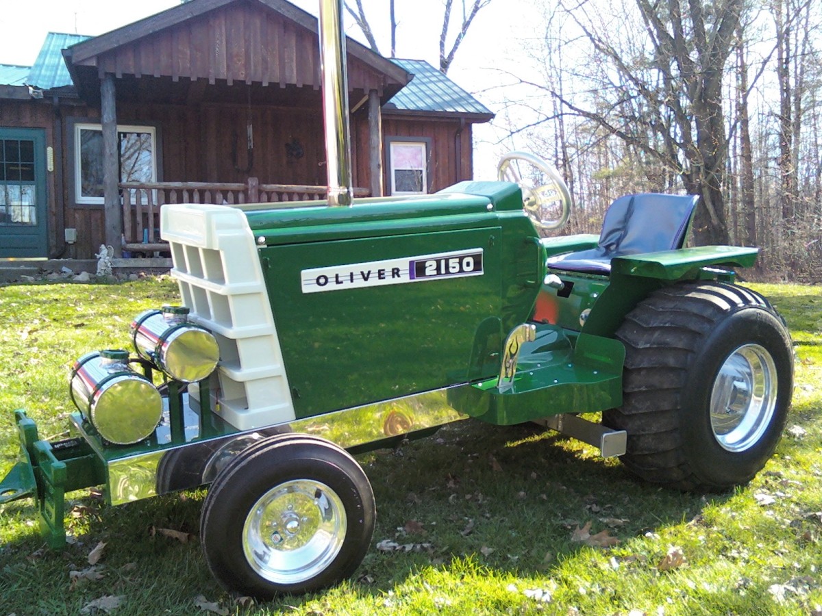

More shots of our Kubota engine and also an Oliver we made parts for.

Will that Kubota engine overheat with that kind of set up, if you were to work it long enough?
Yes it gets hot quick, we spray water and methanol in it and EGT still runs about 1700 degrees.
Used to run an electric water pump and fan drive and it gave out a few weeks back and seized the motor at half track. Got a crank drive back on it now.
It only runs wide open (6000-7500rpm) for about 15-20 seconds at the most and that's enough. It's the same as any full size pro stock tractor in regards to sound, performance, etc.
Wow!!! From a motor that is normally run at a max of 2600 RPM!
BTW, what do you use for a transaxle?
