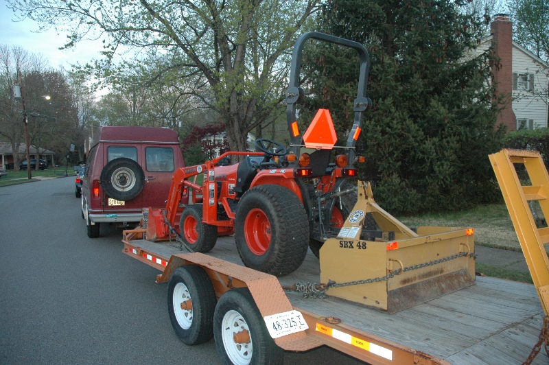

Well I got addicted to diesel fumes when I bought a new '79 Rabbit.
In '88 I bought an E350 (van) w/ 7.3l engine. When I summed up the records a few years ago I had gotten about 15+ mpg lifetime (now only 180,000 miles). And that's with a full hightop conversion.
I bought it and had it converted because I had a growing family of 4 w/ FREQUENT trips from Va to Ms (ferry the whole family and the dog down to Grandmas over the summer to drop off 1 kid at a time for a few weeks). Also we needed something that would idle for hours and not overheat w/ A/C full blast.
I've had 2 major problems - that year a/c was built to filter the freon to the air (when Freon was $1/can), and a waterpump went out a few years ago at highway speed and I dumped all the water. But only a $900 repair bill.
It starts fine. Tows well. If I had it to do over I would have bought two.
