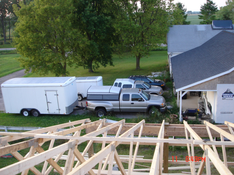

Hi guys, I don't want to start any kind of war here. There is something I always wondered. Does the increased longevity of a diesel engine offset the assumed increased maintenance costs? I'd be refering to 3/4 & 1 ton pick up trucks. If one were to ignore the increased purchase price are diesels more economical to own?
Thanks
I have owned many 1/2 and 3/4 ton gas trucks, Fords, Chevy's CMC's and even a old Dodge.:eek:
I presently own a 01 GMC Sanoma and a 03 GMC one ton dually extended cab four wheel drive. I haven't found much difference in maintenance cost on any of them.
For example, I just purchased an oil filter, $4.99, 10 quarts of synthetic blend oil @ 1.80 each after rebate and a new premium air filter $13 to service my 03Duramax.
My do it myself oil change ($23) costs me the same or less than an oil change for my 4 cylinder Ford Escort if I pay to have it done at Wal-Mart with similar premium oil (less than five quarts in the car).
Considering that the Diesel goes 2 to 3 times longer between required changes, it is a bargain.
To be fair It would cost me about $9 less if I was to do a DIY oil change on a gasoline powered truck due to using around half as much oil to do the service. Most of that difference will be made up for in the longer service between changes. The way I see it, it is pretty much equal for routine maintenance. :cool::cool:
Due to the extra weight and the HUGE difference in power delivery, the tires will probably wear faster. Moderate use of the throttle could probably save the tires, but what fun is that. My diesel will smoke all four of its rear tires trying to push its 7,400 # empty weight away from a stop.:eek:
On the other hand my brakes will probably last longer due to the great braking offered by the Allison transmission, especially when in tow/haul mode, helping make up for the increased tire wear.
My total maintenance cost for my Diesel has been less than $200 for the first 36000 miles. ( it did help that due to a recall there was a free fuel filter that was supplied by GM exactly when I needed to change mine ):cool::cool:
Oh and if fuel mileage is to be factored in I think the Diesel has a huge advantage. I get 16-17 running empty (I know many diesels get over 20 empty, but mine doesn't) But I towed a trailer 800+ miles with 8 horses in it, at 65-75 MPH on expressways and back roads early last year and averaged 14 miles per gallon. I get about the same mileage pulling my 29 foot high profile 9,000# 5th wheel travel trailer with my 3,000# boat behind it in the same conditions.
My experience with gas powered trucks is that I would get around 7-9 mpg under the same conditions.
So to sum it up, if you are not towing, there isn't much difference. It would be silly to own a diesel if you very rarely tow anything.
If you are towing something big and or heavy, the difference is huge and the advantage goes to the Diesel in a big way, 30-40% fuel savings.
My big truck rarely leaves the driveway without dragging something behind it, I try to use the appropiate sized vehicle for the task at hand, so for me the Diesel is much more economical to operate, given the way I use it.
This has been my experience, yours may be different.
I have tried very hard to not deviate from the core of the origional question
Below is a picture of my hauling fleet. The Escort is the Daily driver and gets used the most, 226,000 miles and 34 mpg. The 4 cylinder Sanoma 112,000 miles gets 16 MPG towing the 10 foot enclosed trailer or my 3,000# boat, 23 MPG empty or 26 with the cap and tailgate removed. The GMC Duramax one ton 36,000 miles gets 14 MPG towing just about anything and around 17 empty, 18 best ever empty. (mileage seems to be improving as more miles are added)
