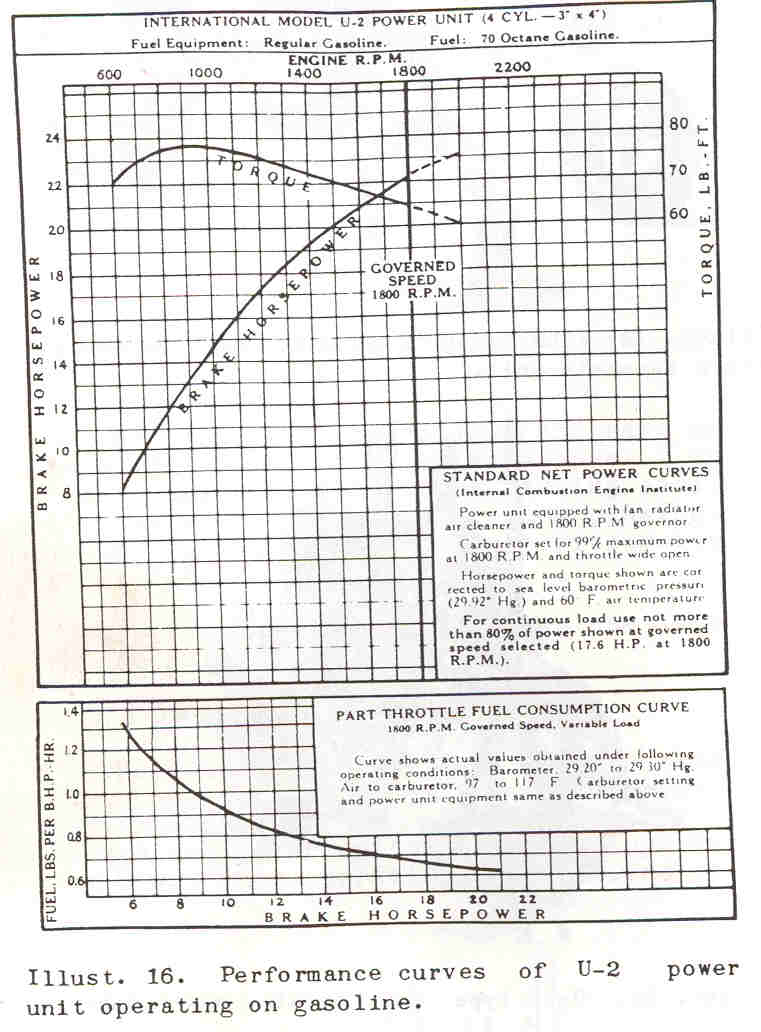

Getut, it certainly has been. But the graphs of the torque curves wasn't. Furthermore, don't forget the root reason the thread was started:

The answer to the why of your question has been repeated many times in this thread, in a qualitative manner. The graphs simply quantify things a bit. So they do have a purpose...

"In your Kioti diesel motor as speed decreases torque increases. In your buddys Koyler, as speed decreases torque decreases."
This is correct while running a gas engine below its powerband.
As shown in the torque curves posted, the gas engine has a torque peak. Once above this torque peak but below the power peak you are into the sweet spot. While in this zone, as the engine slows down the torque goes up. So it reacts like the slow revving diesel right? You just need to be able to tolerate running a gas motor at high RPM if you desire a "torque rise" situation.
From my days in thermodynamics classes. A higher compression ratio makes for a more efficient cycle. It is a given that the diesel engine has a higher CR than a gas engine so it is inherently more efficient. If you use the same high CR for a gas engine, then the difference is the BTU content of the fuel and how the intake is throttled on the gasser. The only way to do have equal CRs on a gasser without preignition is with direct injection of gasoline. Oops, now you have a diesel burning light oil, and throttled to keep the mixture right. Sorry about the rambling. I see no reason that the manufacturers haven't come up with a direct injected gas engine other than the high heat and nitrogen emmisions that come with a super lean burning gas engine.
To answer the original question. Look at the GM 8.1 and compare it to the duramax diesel. They make about the same horsepower and almost the same torque. Peaks of course, but the curves are both pretty dang similar with the diesel having slightly more area under the curve. Folks in the RV world that tow with both report that the 8.1 is a very similar running and performing engine, though thirstier.
