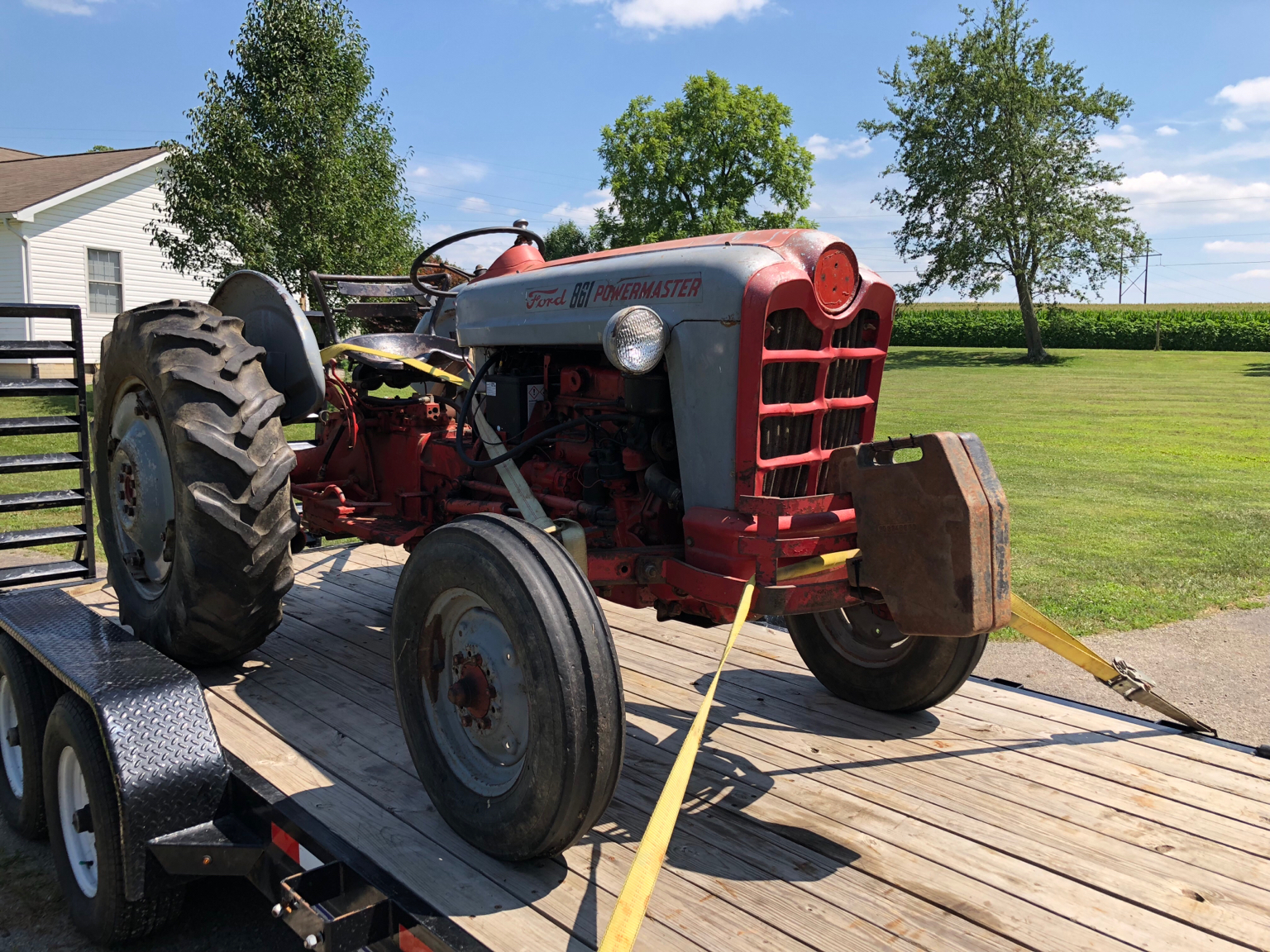

I got a Ford 1958 861 Diesel tractor. I believe this was Ford's first year for diesel tractors. The gasoline counterpart uses virtually the same engine block.
According to Tractor Data online, that diesel engine has the same bore & stroke 3.90x3.60 inches and the same 172 cubic inches as the gas engine. However the diesel has 16.8:1 compression compared to 7.5:1 for the gasser. The diesel has 56.3 hp and 140.4 lb-ft of torque at 1400 RPM; rated RPM is 2200. The gasoline engine is 62.6 hp, rated RPM is 2000, torque is 166 lb-ft at 1600 RPM. So it seems to me the gasoline engine is a little stronger when the cubic inches and bore/stroke are identical.
Gas version
