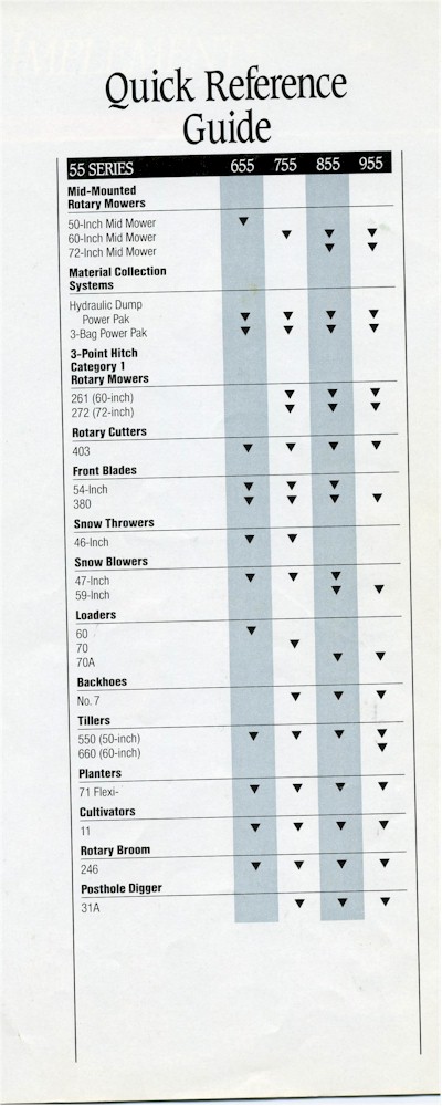

Agree with Roy. 755 is common but pretty much never see a 655.
One thing about a short wheelbase is that it mostly is an advantage only when using a MMM. Put on a RFM and that small advantage goes away. The 655 is not capable of operating a 60 inch RFM due to its low power. The 755 can operate either a 60 or 72 inch RFM.

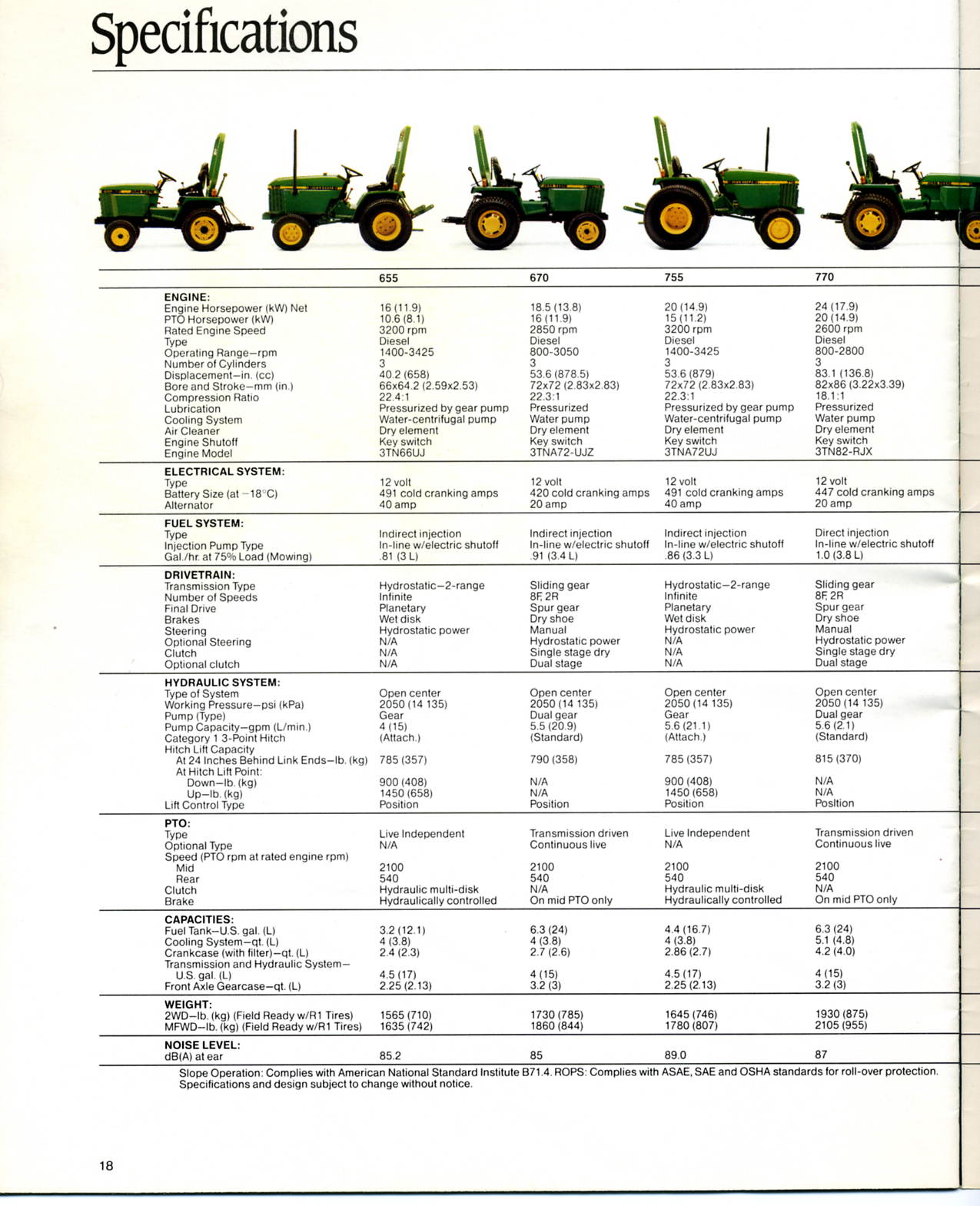

JD755,
Yes, if you have the comparitive specs, that would be very nice. I guess the short form of my question and speculation is:
It looks like the only difference between the 655 and 755 (except tire size and MMM capacity) is the 755 has a larger engine and therefore larger front nose. Is this right?
Greg
Some specs.
   / Difference between 655 and 755 #13
Just noticed those specs did not include wheelbase.
655 = 51 inches
755 = 57 inches
855 = 64 inches
FYI other than wheelbase, the differences between 755 and 855 are because early model 755 came with 31 inch tires and no 3PH. Later 755 came with the same 33 inch tires as 855 and the 3PH became standard equipment. Also by then the weight difference came down to just 35 pounds.
