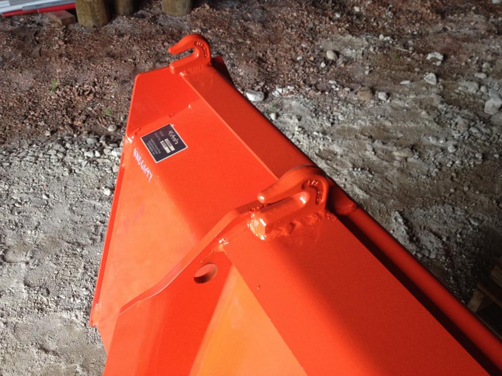

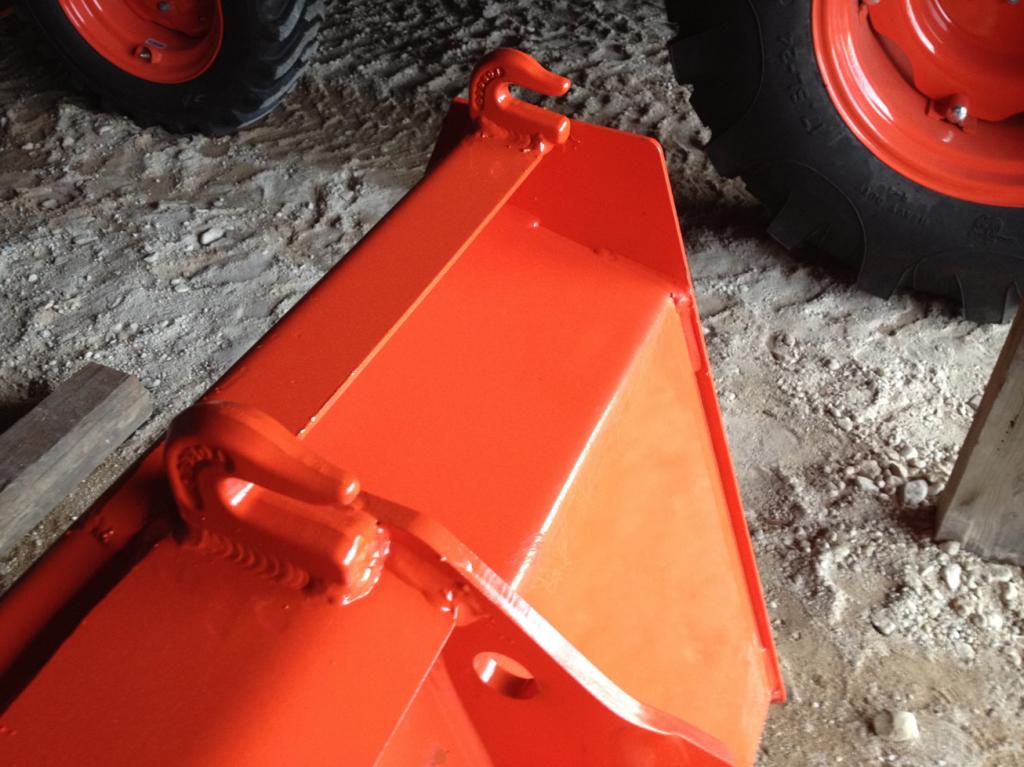

   / Different bucket options
Thanks for posting the pics. That is a really nice bucket. So the bucket comes with the hooks already installed. I like that. It does look very heavy duty. It looks like you have the front cutting bar add on on this one also. Nice tractor. :)
   / Different bucket options #7

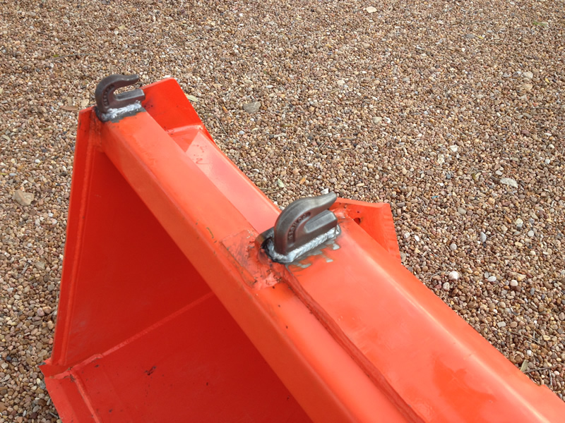

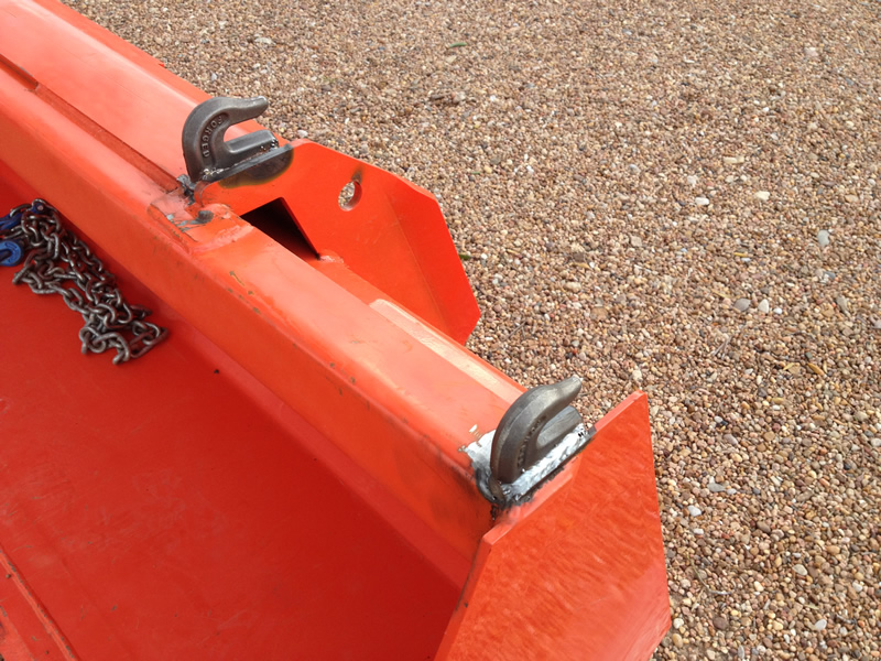

I took the hooks and showed them where I wanted them, I bought them from Truck and Tow, you can also get them from Ken's Bolt on Hooks, he has bolt on and ones you can weld.
I actually do have hooks that I was going to weld on my current L3800, just didn't have the heart to scratch the paint. :(
   / Different bucket options #9
Just close your eyes for the first couple of seconds with the angle grinder.:D It only hurts for a second or so, then it is smooth sailing from there.:laughing: Weld em on, paint, and admire your work.. look at TripleR's. Don't you think they look good.?:thumbsup:
