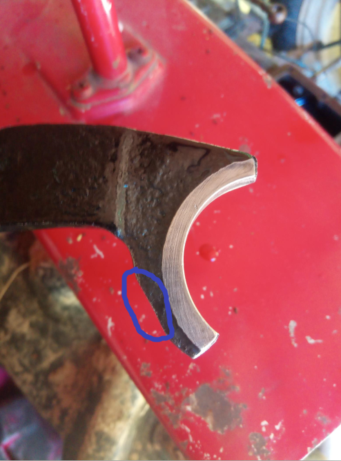

I found the photo is still listed in my 'Attachments' and it was used in this 2011 post. Tell me if the photo and diagram are visible to you at this link:
The repaired shift fork is #12 in the diagram, and the worn area built up by welding is near the line drawn from '12' to the part.
Here's my photo again - before the worn spot was filled in by a weld.

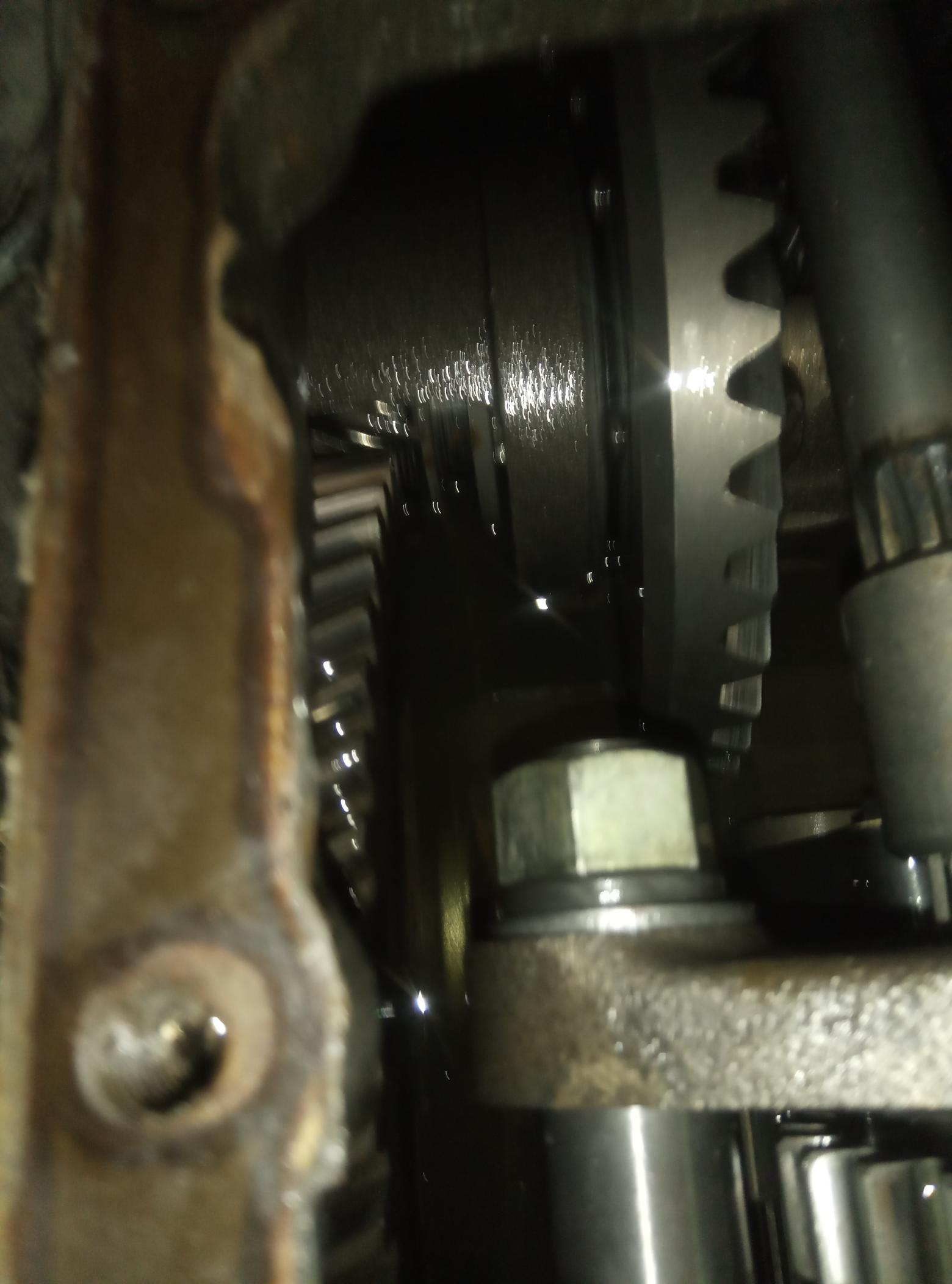

So, it appears that my situation is a little different than most. I did some testing with my YM2000 chained to a tree, and the diff lock did not work when I pressed the pedal down, but it did work when I pulled the pedal up. With this information, I figured that I was having the same issue as California.
I then pulled off the two U bolts to remove the right side fender. I had to undo the PTO linkage as it is part of the diff lock shaft, then I removed the snap ring holding the diff lock shaft in. I disconnected the 3 point lift arms at the end of the arms, not near the transmission of the tractor. I unbolted the hydraulic fluid feed at the top of the transmission case, then undid the 6 bolts holding the hydraulic piston system onto the gearbox of the tractor. After pulling that off, I had to drive out the roll pin in the diff lock lever on the outside of the transmission case so I could rotate the lever enough to get access to the roll pin on the inside of the transmission case. It was kind of a pain, but once I got it driven out, the diff lock shaft slid out of the transmission case. From there, I was able to remove the spring, then remove the diff lock shift fork.

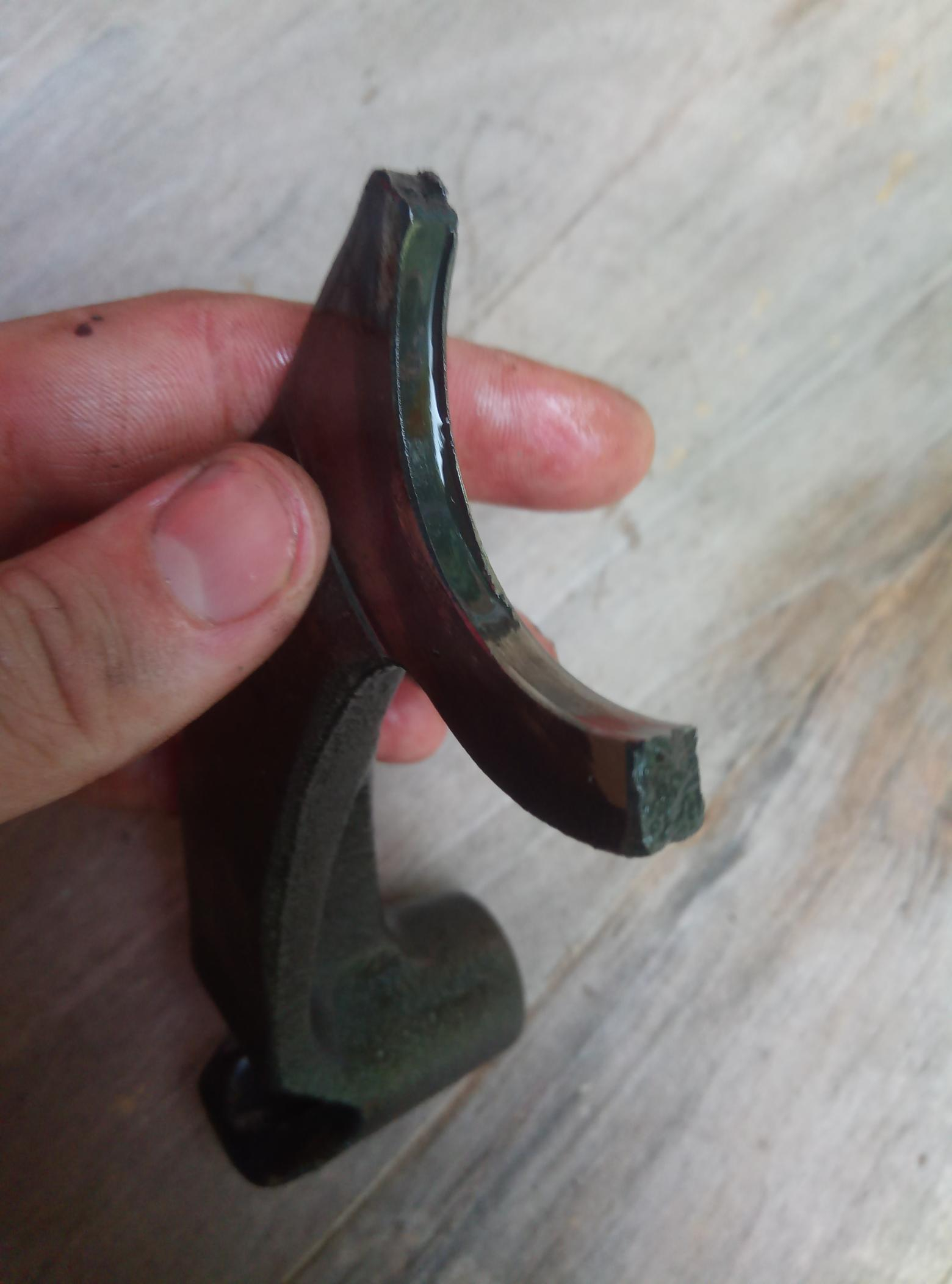

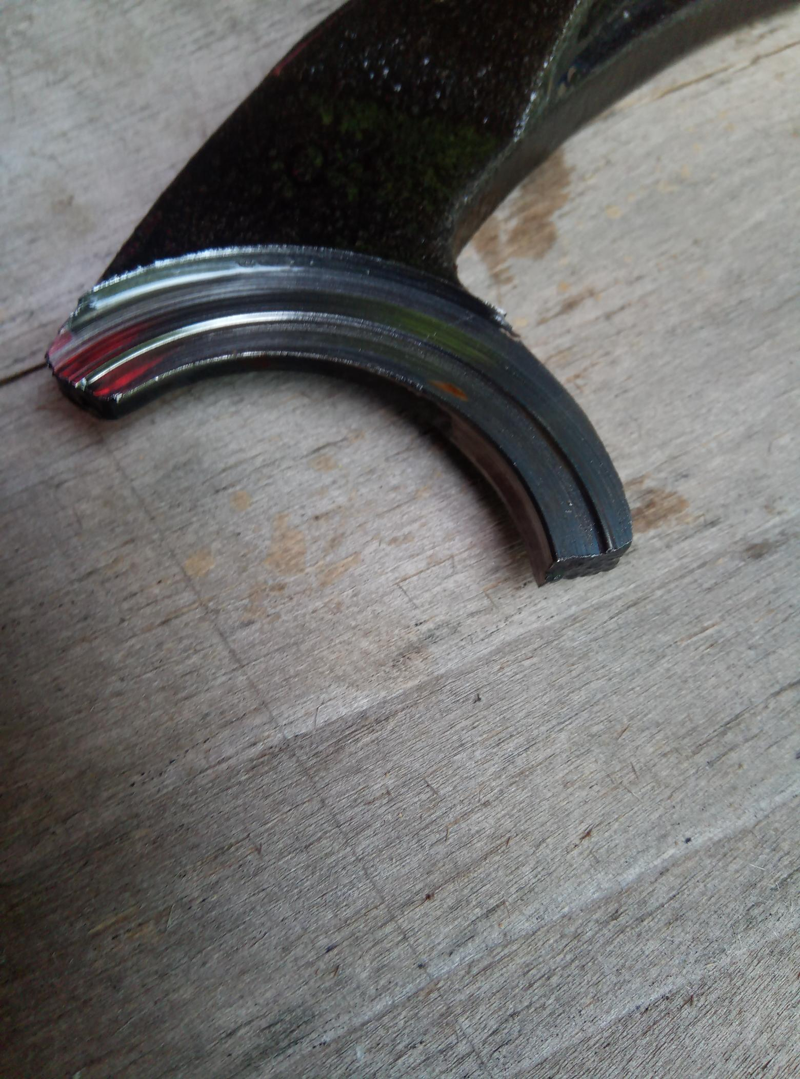

I was surprised to find very minimal wear on the ramp of the shift fork, but pretty extreme wear on the contact face of the fork. Unfortunately, the wear resulted in a raised lip that dug into the piece that the fork mates with deep in the transmission. I went ahead and ordered a new shift fork from Hoye; I'm hoping the mating piece will be ok.

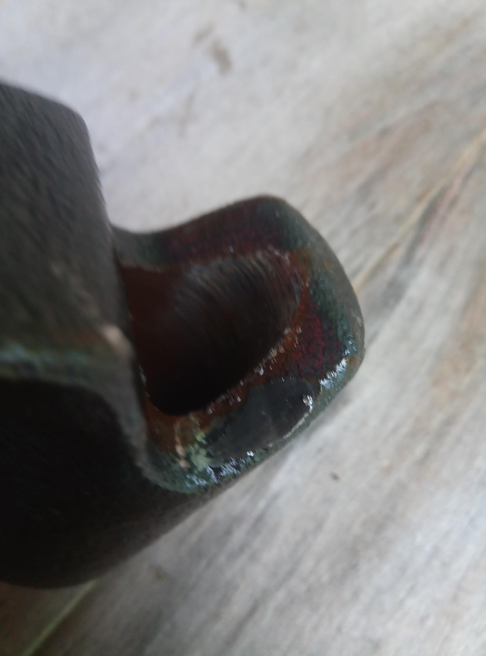

Unfortunately, I do not have great news. I paid $200 for the new differential lock shift fork and an extra $30 for 2 day shipping, and it showed up 4 days after I ordered it :/

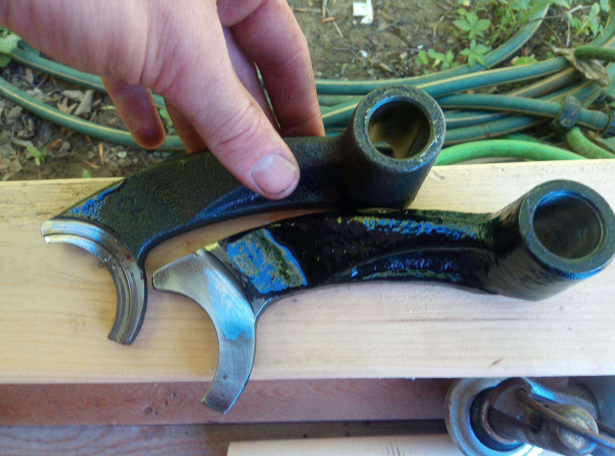

Regardless, when it arrived, the whole part was painted. As I don't want paint chipping off in the transmission, I had to use a wire wheel to remove the paint from the surfaces that engage the differential lock collar. Additionally, because it was painted, it did not slide on to the differential lock shaft. After removing all the paint from the bore of the shift fork, it finally slid on. Unfortunately, the new shift fork cannot slide onto the differential lock collar because the top of the fork is taller than the original and hits the case inside. I think my only choice now is to grind it shorter until it fits.

So for an update, Hoye and I went back and forth several times to try to figure out what was going on. Hoye requested a used shift fork from their boneyard and compared it with a new one identical to the one that they sent me. They claimed that both are the same size and that the part number is the correct part number from the manual.
They said that it looks like part 60 from this manual: TRANSMISSION_INTERNAL: Yanmar Tractor Parts could be worn from pictures that I sent, thus making the new part hard to fit correctly. I don't think this would result in what I was experiencing, but they suggested grinding down the top end of the shift fork to get it to fit. They suggested to be subtle on the grinding and check to fit often.
I went ahead and ground the topside of the shift fork until it slid into place, see picture below.
I used a flap disc and eventually got it ground enough. I used (2) #12 o-rings from Home Depot to replace the o rings on the diff lock pedal, measurements 5/8 in. I.D. x 13/16 in. O.D. x 3/32 in. wall thickness. These are ***-160 o-rings on Hoye's website. In order to get the compression spring that rides against the diff lock shift fork back into the transmission, I had to use a c-clamp to compress the spring. Once it was compressed, I was able to slide it off of the c clamp pad and against the shift fork. From there, it was a matter of installing the roll pins again and putting everything back together. Everything seemed to work ok, but it is yet to be tested. The diff lock shift fork was tight on the diff lock pedal, which has me a little worried.
