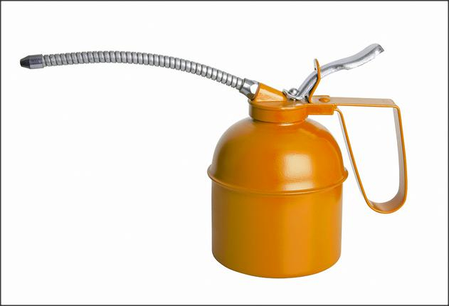

Occasional drop of oil where the diff lock pedal exits the differential housing will keep it working smoothly - it is called preventive maintenance.
I know many people are not big on that, they just fix it after it's broken!
I keep an old style lube oil can filled with filled mixture of 30W or 10W-30 oil and some STP engine oil additive.
Works way better than WD40 etc. spay in the long run.
