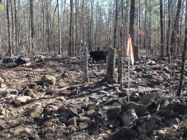

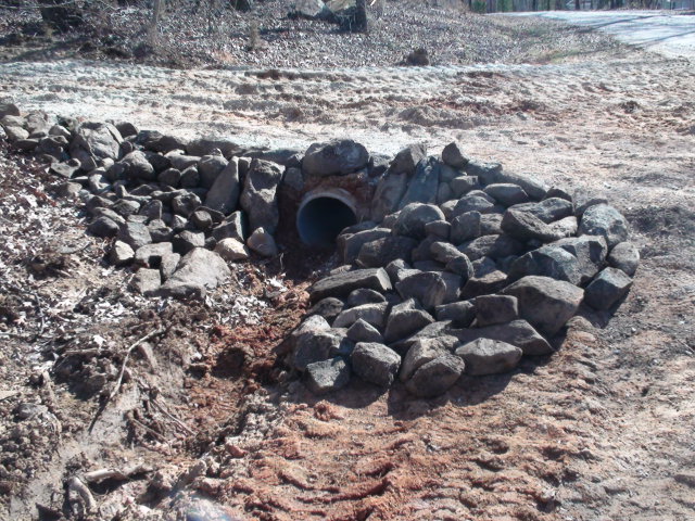

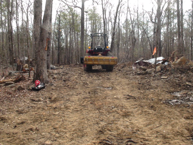

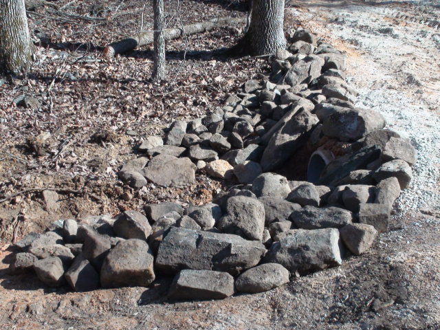

Agreed. A bulldozer is the best equipment for my driveway, but I do not want to deal with the aftermath. Fortunately bedrock is not my issue, but I have serious amounts of large, heavy rocks. If they are large enough, I pick them up with the grapple bucket. If too small for the grapple. we manually load them into the bucket. There are a few too large for my tractor to lift. But the driveway is now ready for leveling and removal of all of the smaller rocks in preparation for gravel.
   / Difficulty using box blade to smooth a gravel drive way #28
View attachment 364104View attachment 364105View attachment 364106View attachment 364107View attachment 364108
Looks like a tough place to build a driveway. I use a rock bucket to collect rocks the size you have in the pictures above, any thing smaller than 3 inches I would cover with base course (3/4" to fines) and pack down.

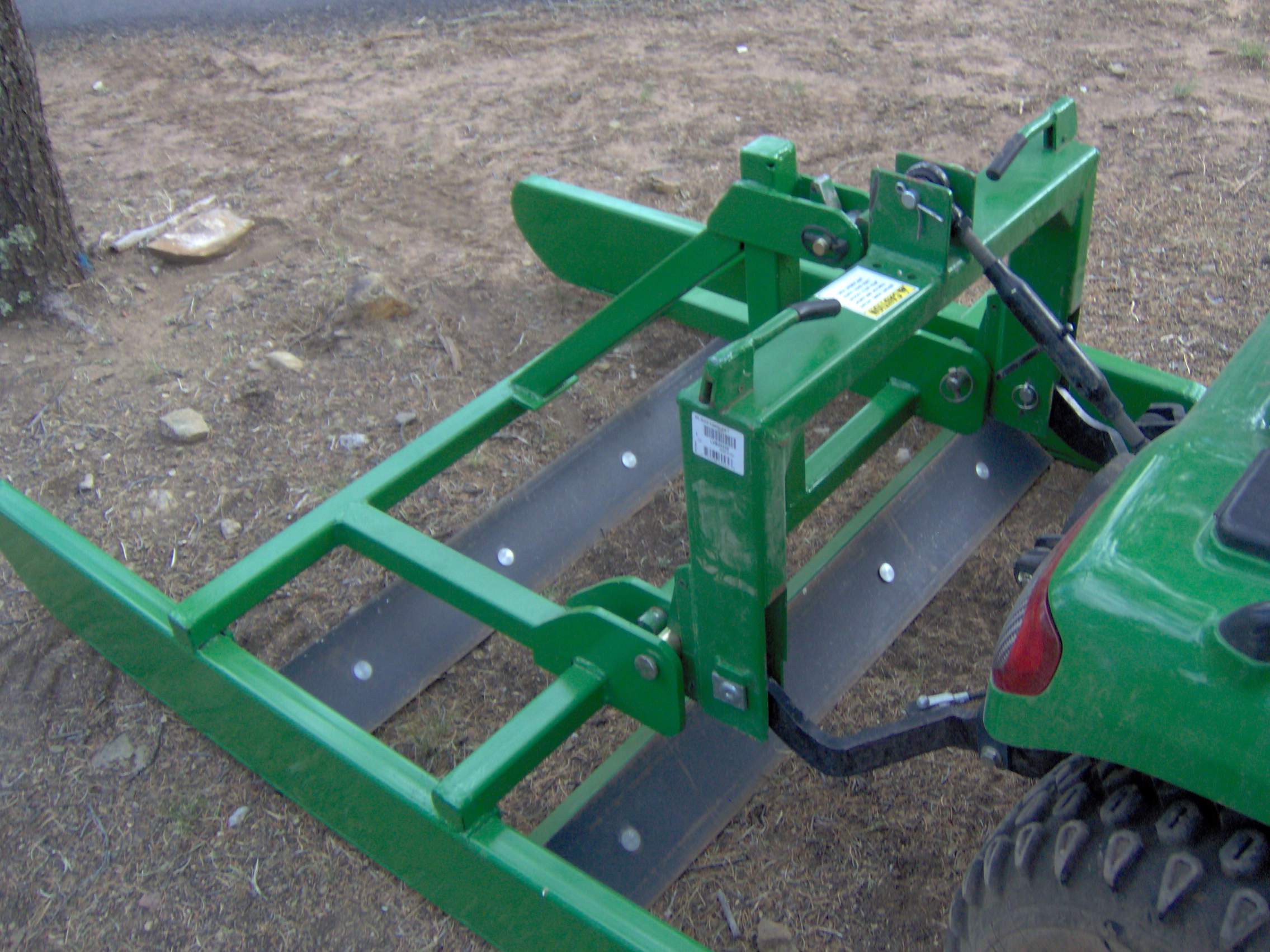

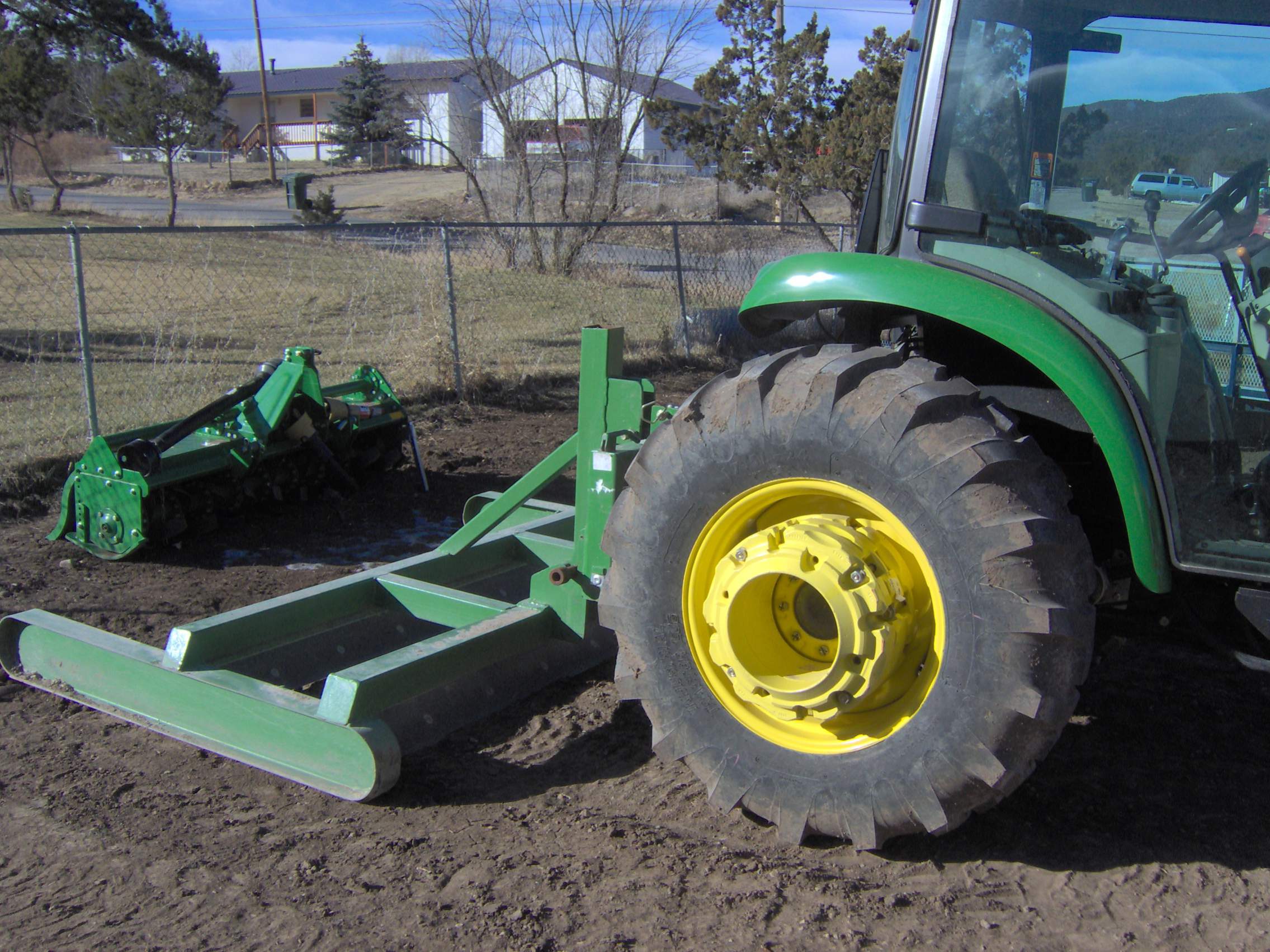

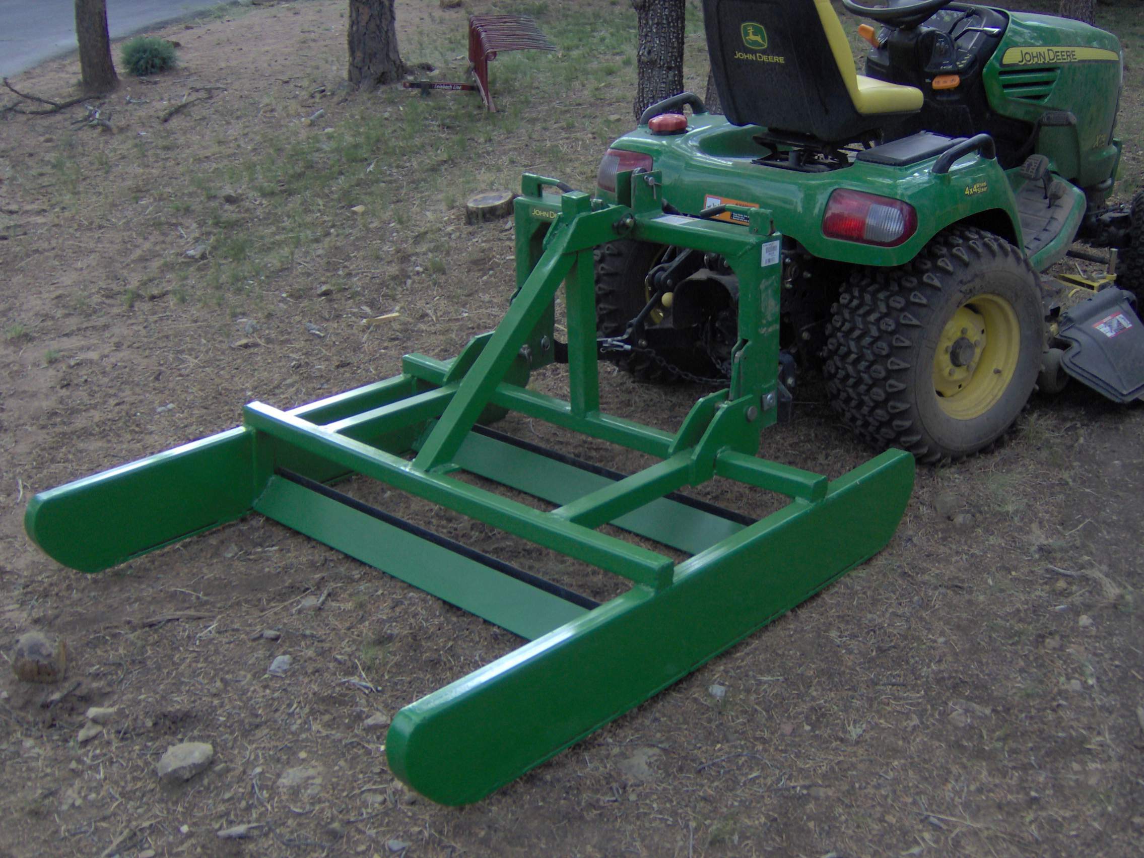

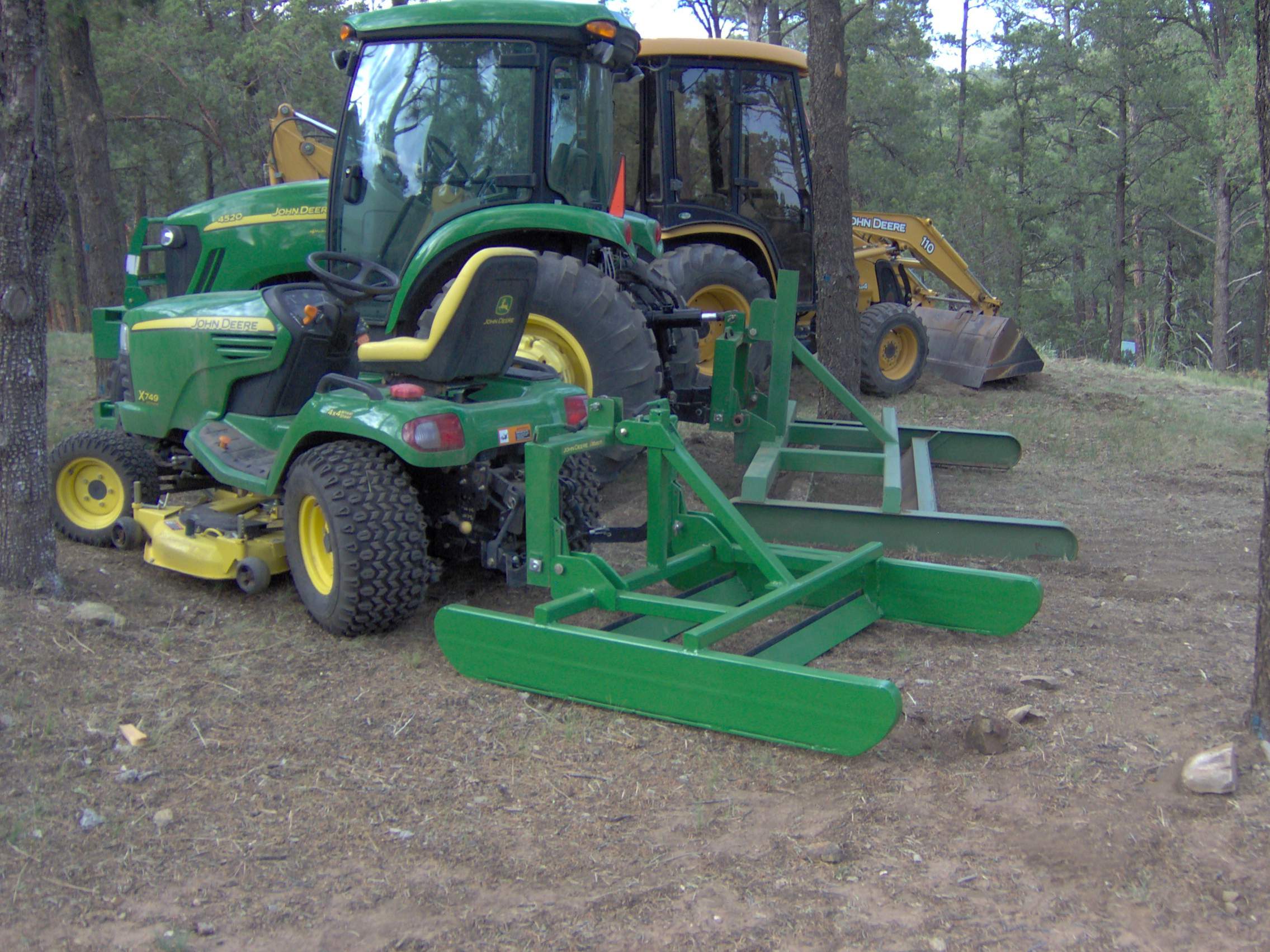

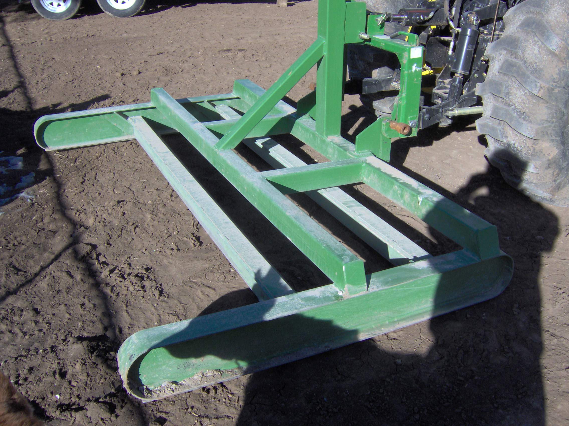

I also viewed the pics of the land plane mentioned in your previous post. I noticed the blades are set far enough back that cutting would be difficult to do. Most of the landplanes I have seen have the front blade much closer to the front of the skids.
The landplanes pictured below I built with the blades set straight and flush with the skids. When I shorten the top link both of these will dig in aggressively if there is a need to. Most of the time I feather the top link to get the best results but a heavy landplane can cut through the hard clay when needed. It would help to pick a time when the soil is softer after a rain in your locale.

Not fair to post pics of your 4 wheel steering SCUT. Never saw that before. :thumbsup:
How does the little guy do hauling the land plane and with those tires? I have Turf tire on mine too
   / Difficulty using box blade to smooth a gravel drive way #30
That is an x749 garden tractor, 4x4ws diesel with hdap tires. Most of the work is done with the larger compact but the small one is great for the tight spots and running around the trees. I use the smaller one on town lots as it is cheaper to transport and a better fit.
