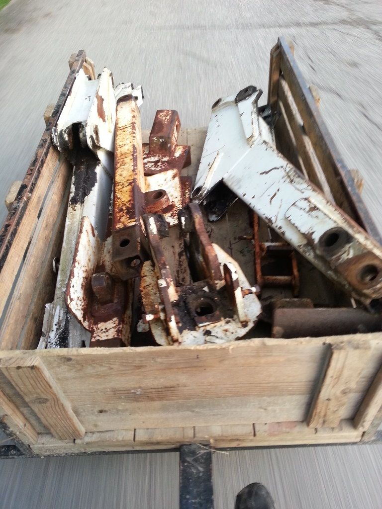

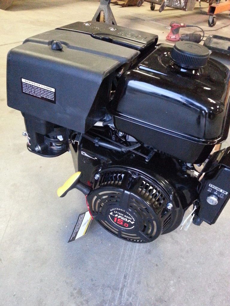

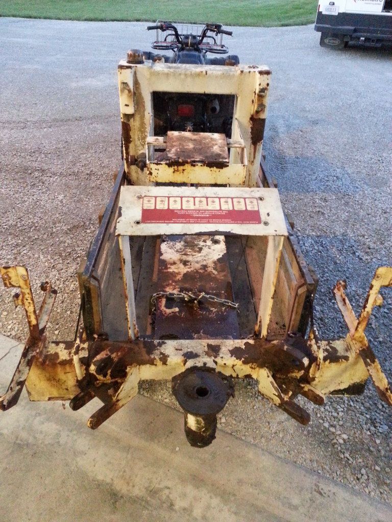

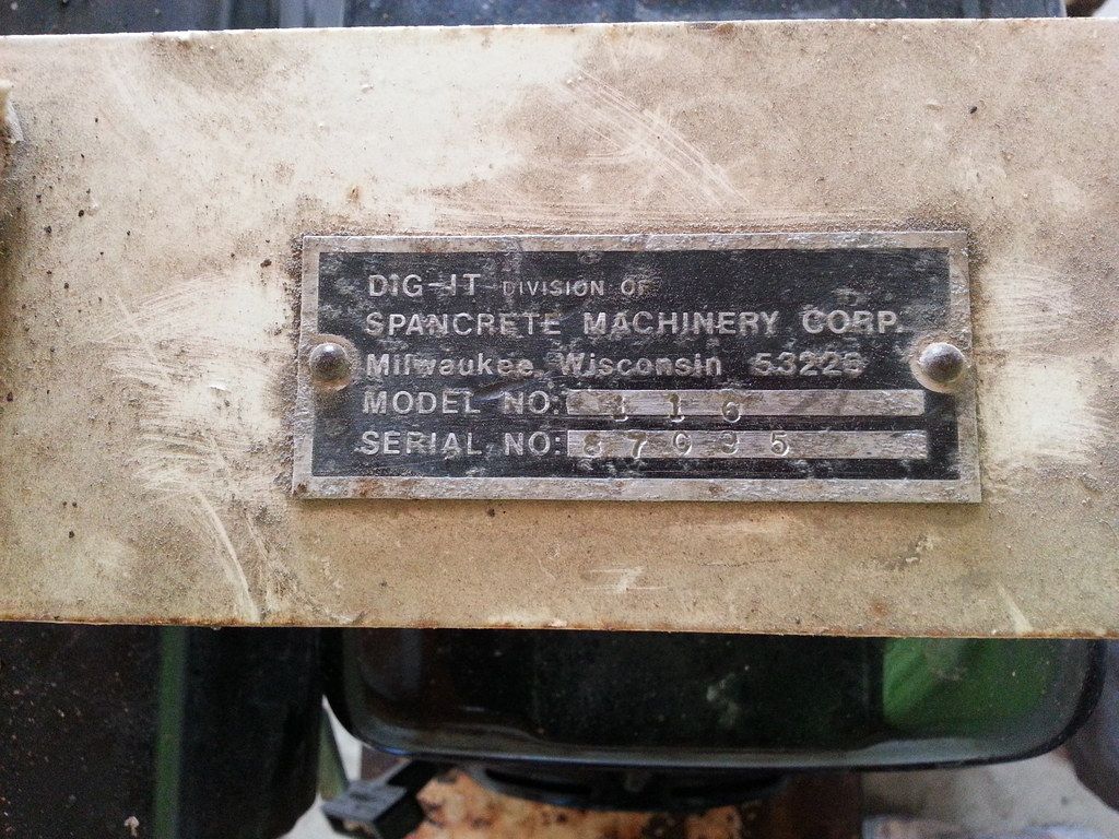

I stumbled upon this thread after my brother and I purchased our Dig It in much need of a restoration. We were needing an excavator on the farm for a few projects and decided instead of paying someone else or rushing the job with a rental we would buy our own, fix it up and sell when we're done with it. That being said I don't think we fully grasped what we were getting into when we bought this Dig It 148. Come to find out it's actually a model 116 per the Name plate but has most of the 148 parts, it must have been when they were transitioning. We're repowering it with a 15hp electric start Lifan motor with an 18amp charging circuit so we can run lights if needed. New wheels and tires all around, new seat, new fenders, new hydraulic drive motor, some new hoses, two new cylinders, new bushings and pins throughout and new decals and paint to freshen it up. Right now we're currently putting it back together and hope to have a complete unit in less than a week.
   / Dig-It towable Backhoe partial restoration #98
Huge thanks to the guys who have shared Mission Manufacturing/Power King tractors. We have spent a load of money with them and they've been very helpful. The manual is a huge help as ours had been improvised on in the past.
   / Dig-It towable Backhoe partial restoration #99
Question I have and I'm sure it varies state to state, do you need to have this thing plated to tow around? Obviously it had lights on it but we didn't see any place for a licence plate.
   / Dig-It towable Backhoe partial restoration #100

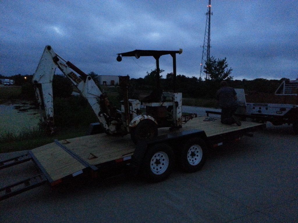

The night we picked it up.
Model 116, serial number indicates it's from 1987.

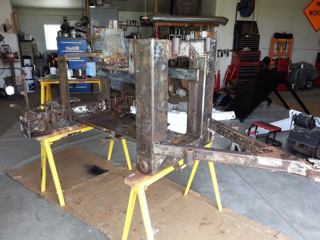

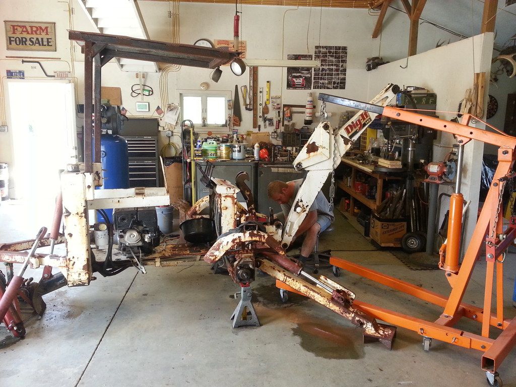

Tearing it down, we were able to rig it up to run on my brothers 13hp Honda GX390 to diagnose which cylinders needed replaced.
Took all the parts to my brothers down the road to pressure wash.

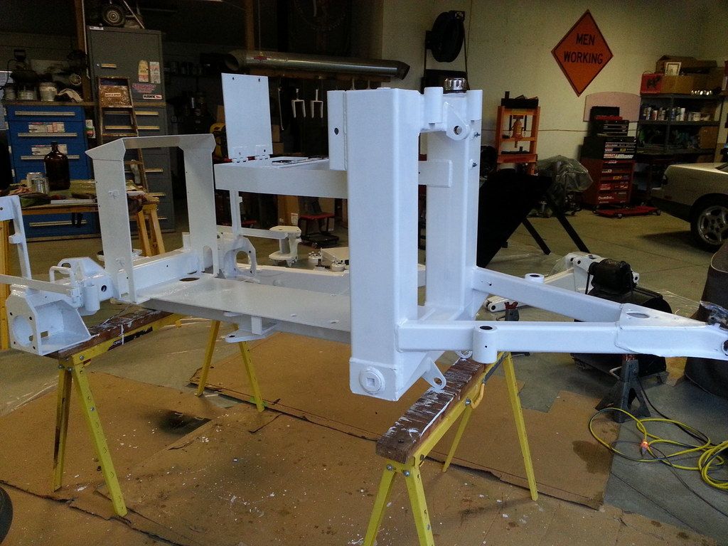

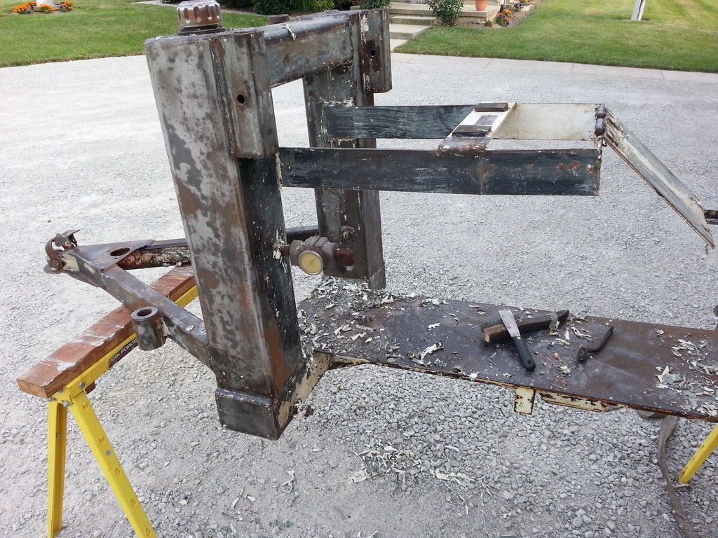

Stripped it down to bare metal

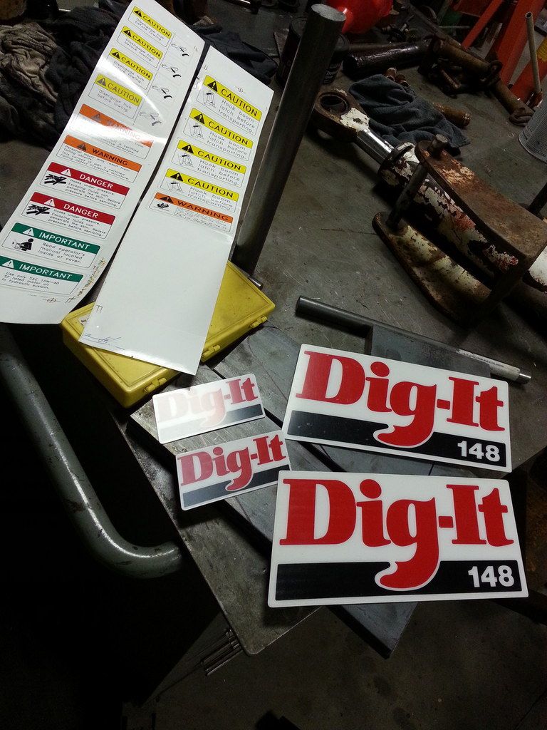

Everything received a couple fresh coats of paint.
New Decals, ours came with the 148 model so we figured to stick with that, given the 116 model came with a different hoe arm.
More pictures to follow once we have it all together. We ran into quite a few problems with this so if anyone has questions feel free to ask, I will subscribe to this thread so I will get any new posts sent to my email.
