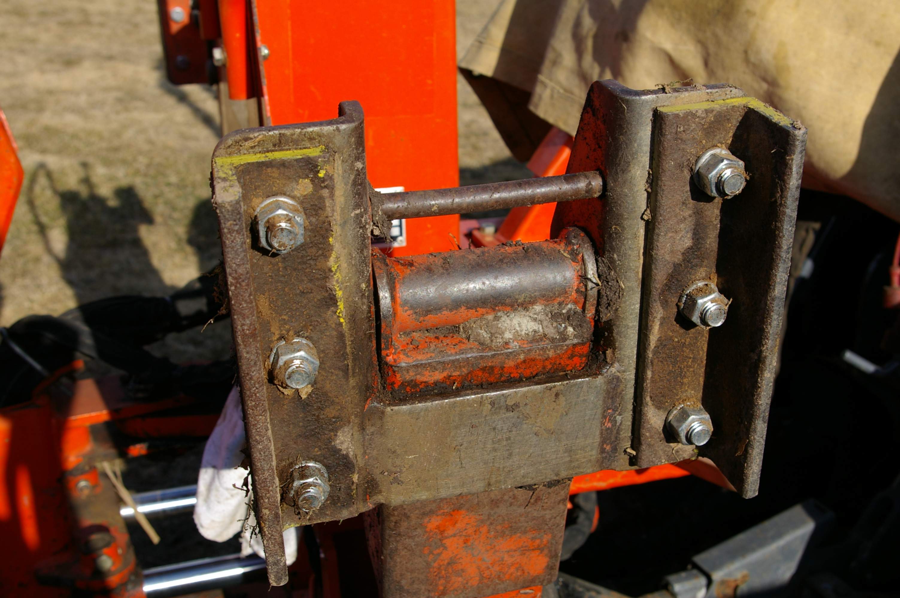

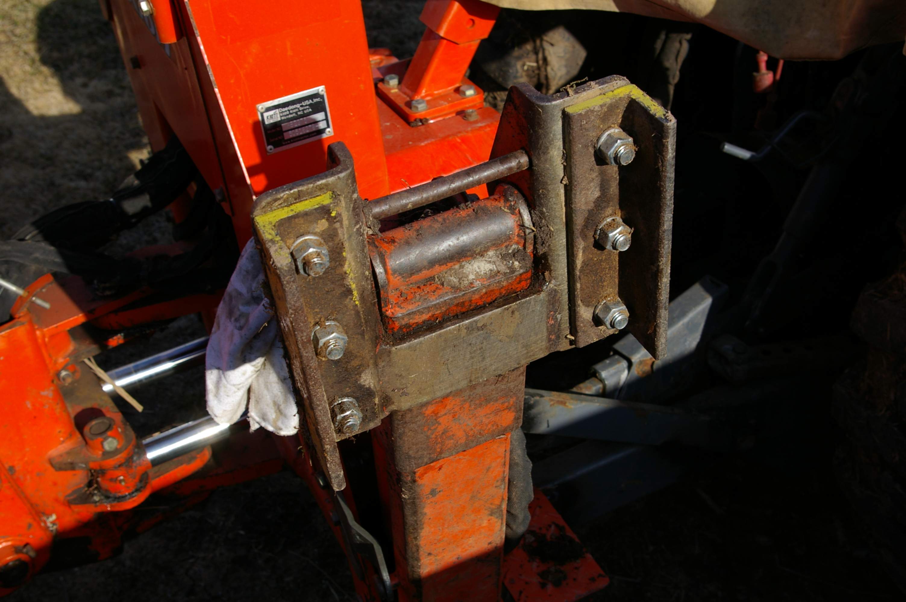

I made cleats for mine out of big C-channel. Cut C-channel to size of pads. Welded ends on to close them in, like a box. Then drilled holes to match the outrigger feet. The work quite well. They do hold mud sometimes. But, they were essentially free. Not as nice as the big foots though.
You don't happen to have a picture of the cleats you made for your outrigger feet kicking around some where ?
I think I'm going to build a set.
Thanks
