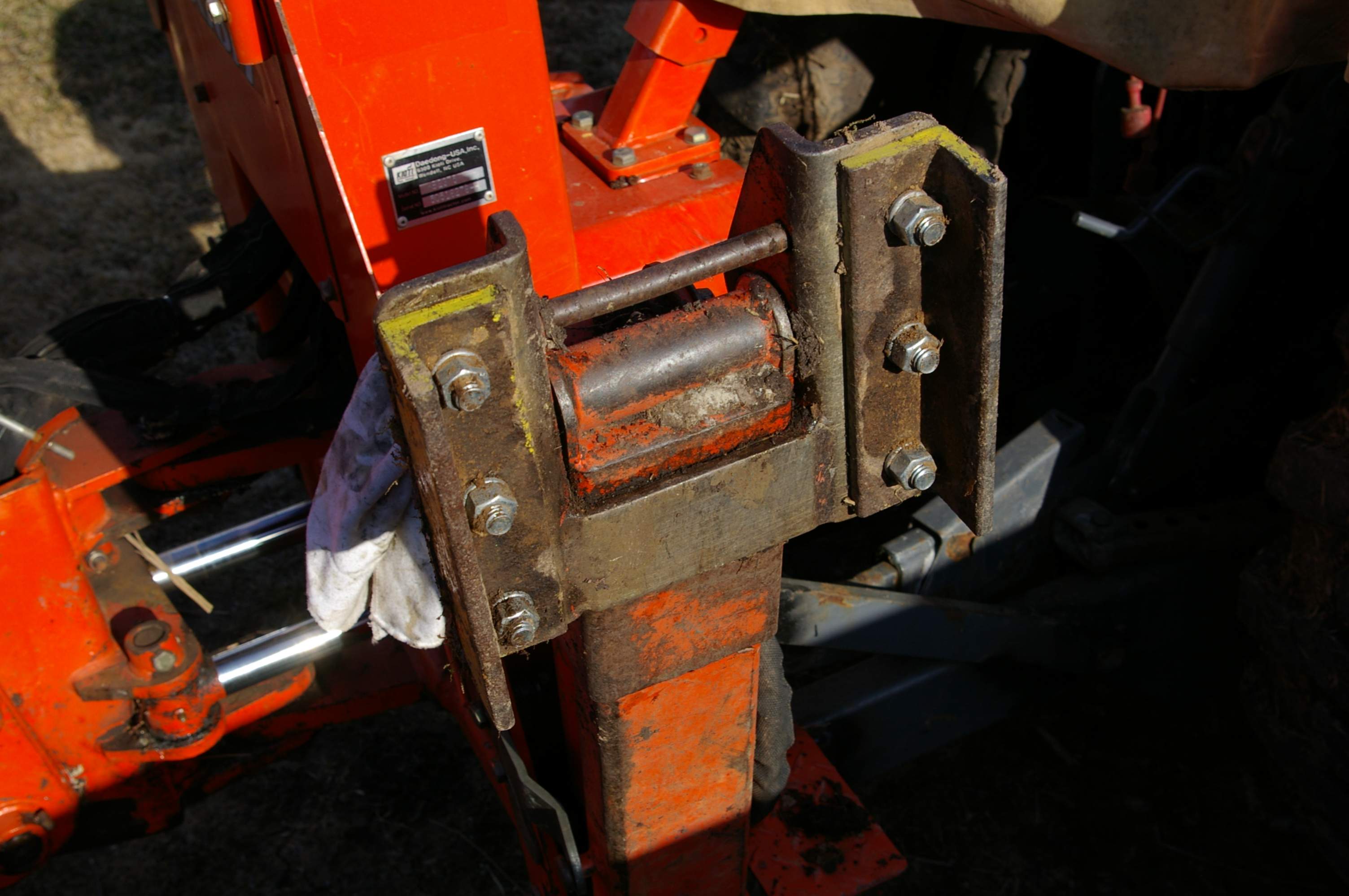

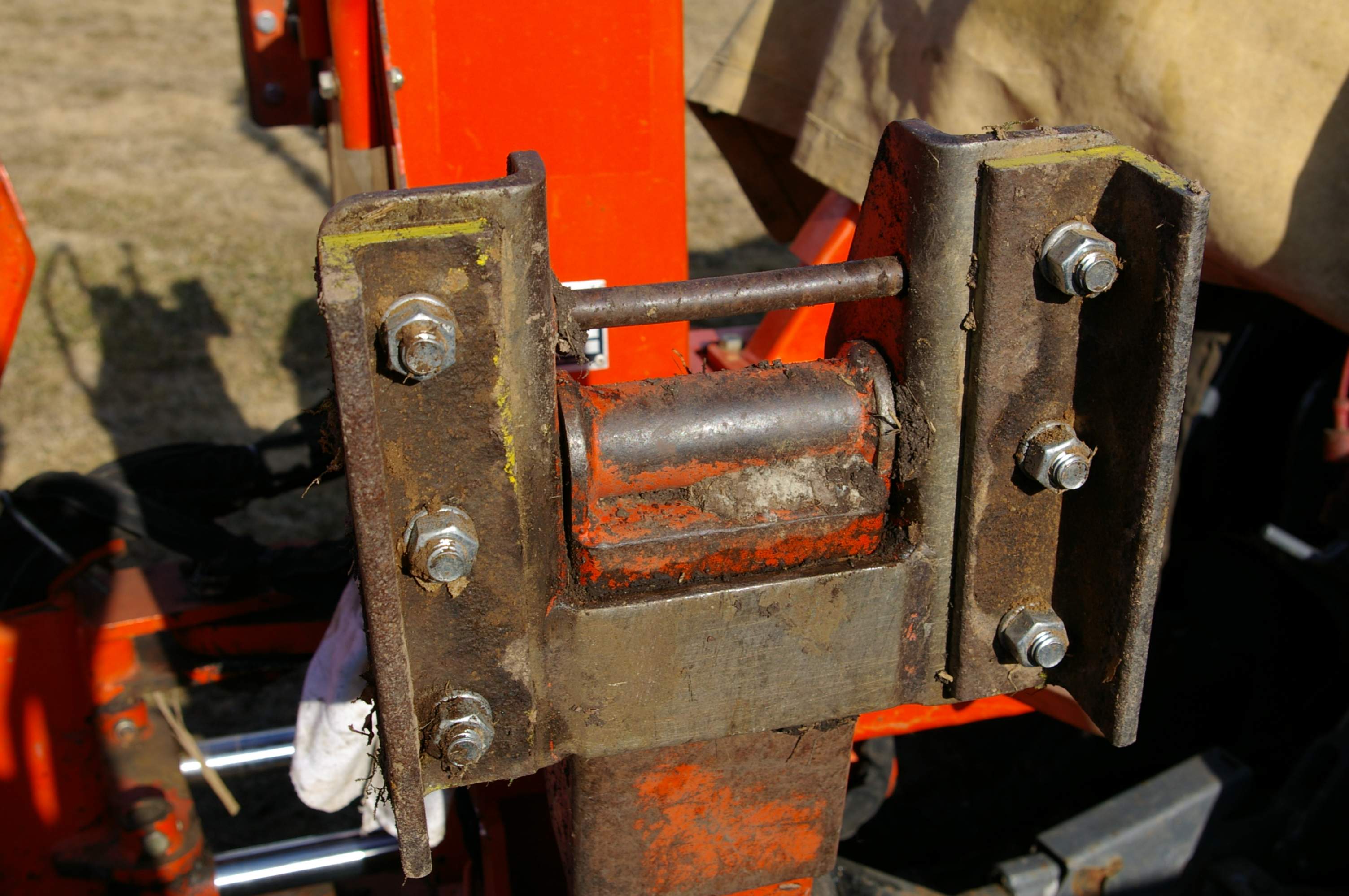

Here are a couple of pictures of my Angle Iron I bolted on the pads.
(KB 2375 )....

Well Mr Fox, they look mean, looks like the could really dig in, I think you said they made a BIG difference.
   / Digging in a power Line.
#47
I was really surprised at how the tractor was not being drug around like before. I only wish I had them on when I dug that trench for my electrical wire out to the pole, as that was all rock and ( yes no dirt ) and it was pulling the tractor around pretty good, if I got to heavy handed on the controls.
