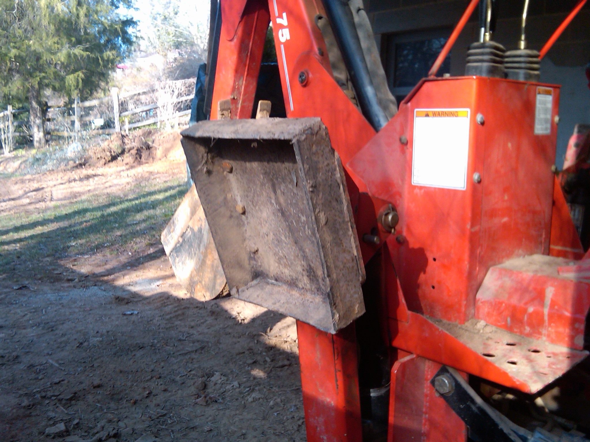

You don't happen to have a picture of the cleats you made for your outrigger feet kicking around some where ?
I think I'm going to build a set.
Thanks
The Fox
I'll try to take a few photos for you tonight.

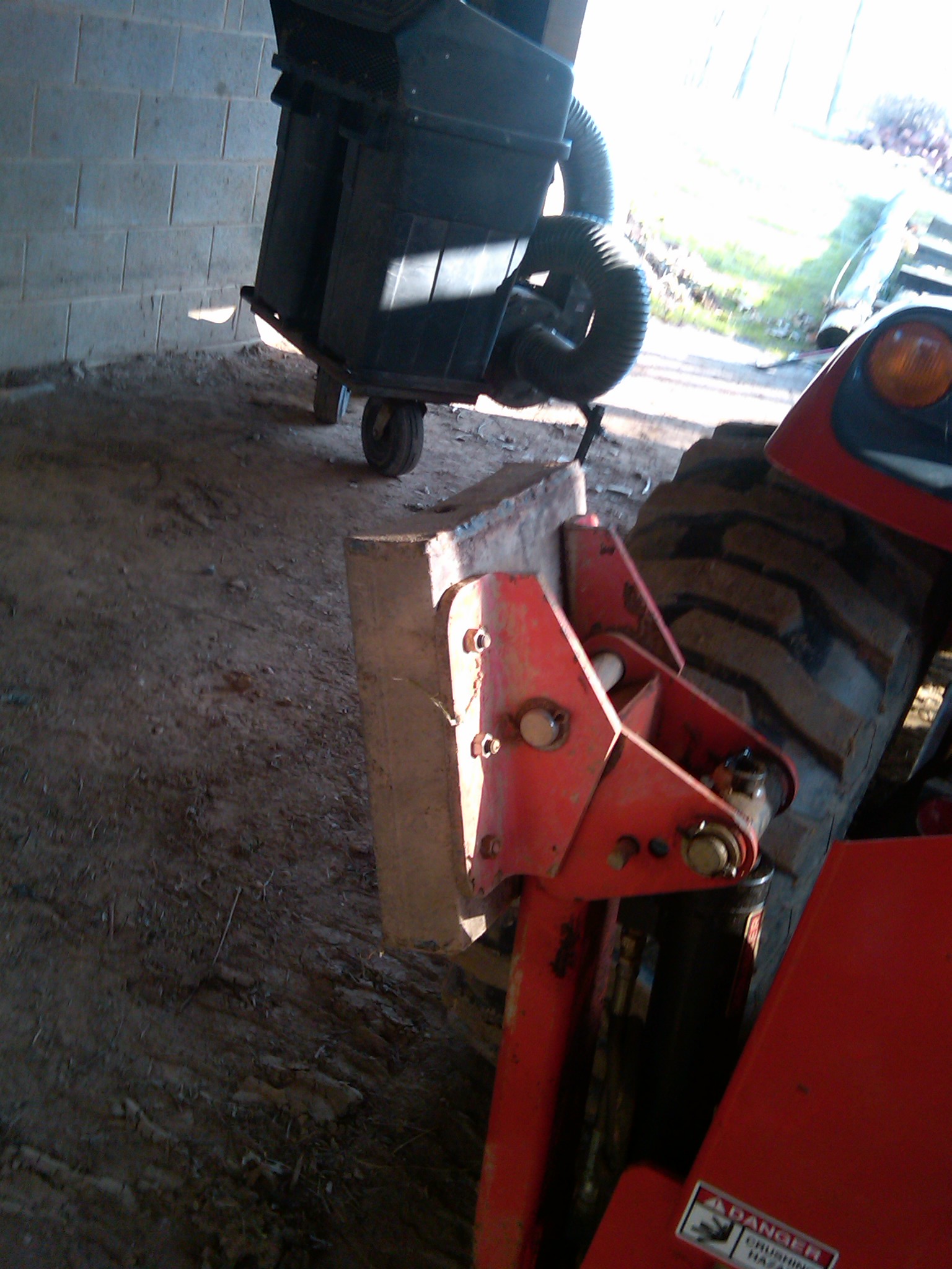

Here's my freebie feet.
   / Digging in a power Line.
#35
I made up some angle Iron 8.5 long x 2inch and 3\8 thick and drilled the holes in the angle iron and bolted them on the pads with 1\2 inch bolts, I thought I'll try this little experiment to see if it will work.. I went back in the field and started pulling out trees and alders and that tractor never moved.
So I am quite happy with the way it worked. I would rather have the tractor move around a bit rather then put a lot of strain on the outriggers and bust something because I have it anchored so tight it couldn't move. I do seem to have a bad case of "Metal Sympathy".....
The Fox
I thought about using angle iron. But, the C-channel is probably a little stronger, and it's mostly one piece. Probably just like you, I used what I had sitting around. I might weld some teeth on to them for just a little more bite.
#39
I was going to use channel Iron only I could not find any lying around cheap .. So I used Angle Iron and I am supprised at the differenence in the
way the tractor stays put. I was out digging today and I never had the tractor pulling me into the hole I was digging like before.
But yes by all means Channel Iron would be better for sure. Being a penisoner I have to conserve. LoL
