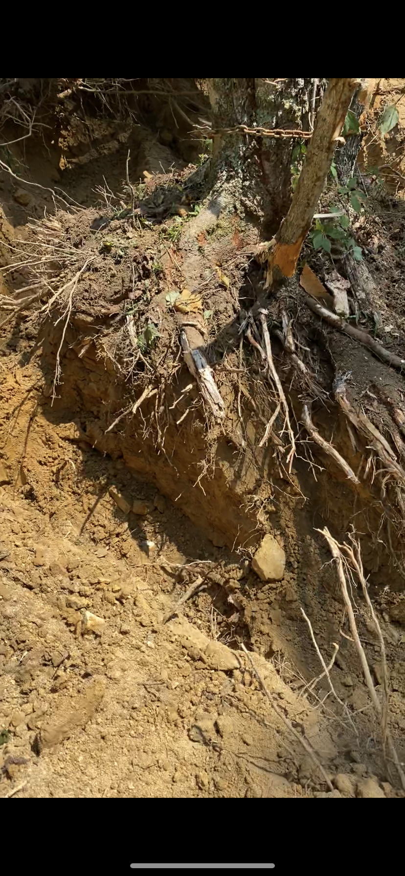

So I’ve got a stump where I feel I popped all the roots and probably went deeper down than I needed too. But the stump is very big and I think it’s just the pure middle holding on.
My technique is I just carefully dig a trench all around it trying not to pick the machine up or move it.
I don’t know how to dig under it now though to pull it lose? I can take my bucket and scrape across all the roots from the top down but that picks the machine up and I’m sure causes wear. Maybe I should try extending the arm and digging on the opposite side of my to take out the middle? Im pretty new to this backhoe, it has plenty of power just not sure how to approach this.

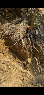

Another pic

Youre doing it right. Just gotta keep at it. Buckets are not the best for digging stumps. A ripper tooth on the backhoe is better for breaking the roots. But you'll either pay out the nose and wait, or make your own.
Keep moving around the stump, digging as you go. It will come out.

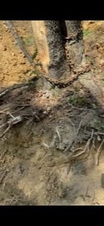

I have had to dig stumps with a big taproot, just keep digging and eventually it'll start moving around and snap the tap root.
Trick is to dig out a little farther to give your self room to move out the dirt under the stump.

I had a huge maple stump in my yard that took quite a bit of time to get free. Luckily, there wasn't much of a tap root, but some of the horizontal roots were 6" diameter or so. I dug all the way around it like you are doing, then when I thought it was free enough, I hooked a chain to one of the horizontal roots I had cut, and pulled it from one side to get it to rotate. A couple pulls back and forth and it was free. Picked it up (barely) with the pallet forks and deposited it in my woods to rot. It took some time with a CUT backhoe, but it was "fun". As the others said, you're doing it the right way. It will take some time.

I'm having a hard time telling from the pictures, but you need to dig as much of the way around the stump as possible. At least three side, and preferably all the way around.

Dig another backhoe bucket width or maybe two away from the stump. Then use your outriggers to tilt the machine so you can dig under the roots all the way around. Then use the backhoe to pull from the side to rotate the stump as mentioned.
You can also curl your bucket some and hook the edge of the roots with the side of the bucket near the pin, then lift the stick/boom some while you uncurl you bucket. You can really multiply your power doing that and it won't lift the machine off the ground.
From what I can see on the pics your about half deep enough to get that loose.

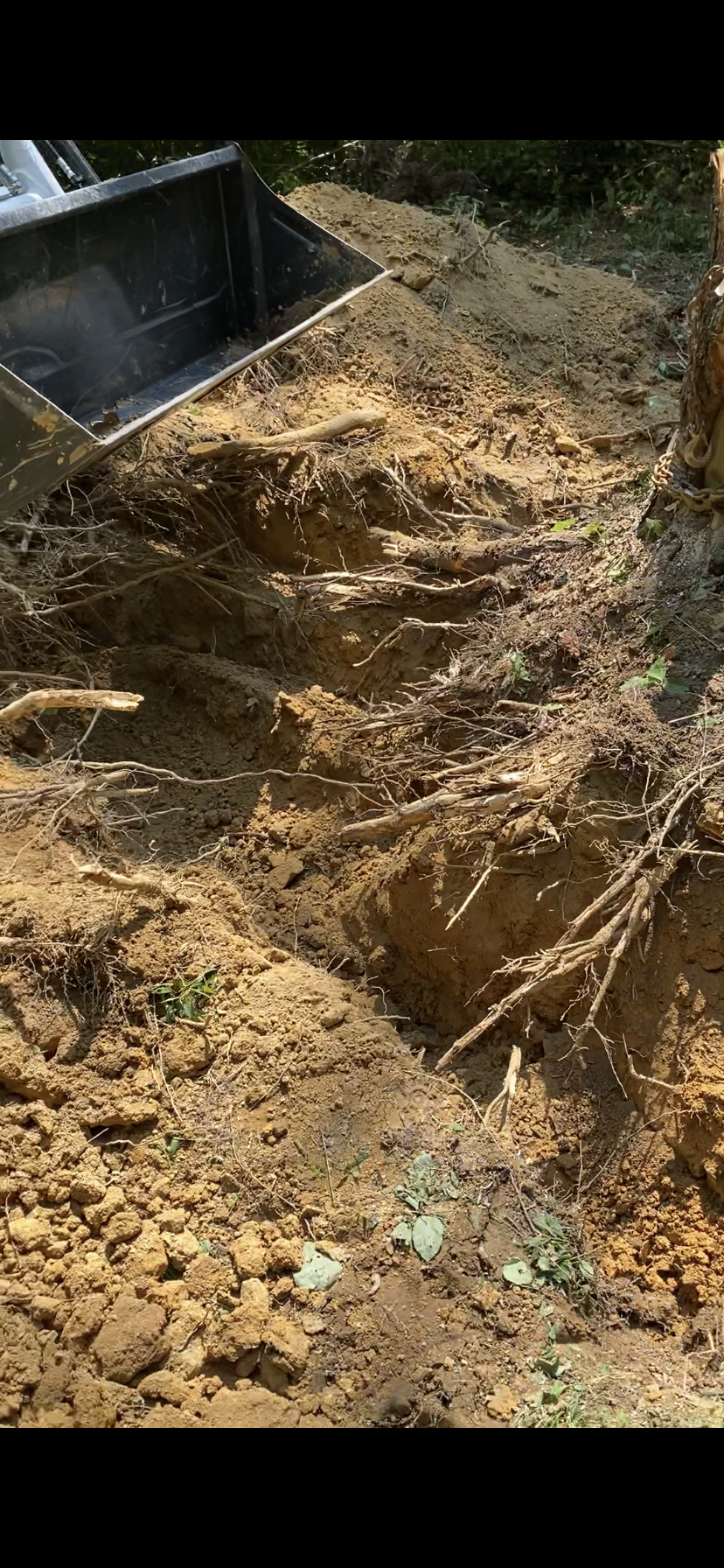

I generally dig until it falls over in the hole. If roots are too tough you have to move further out until they break easy. Sometimes I give a light tug on the top to see if it will come loose but I NEVER try to pull a stump that hasn't been dug loose. Backhoes are made for digging.

I have a little 3,500lb mini ex that I have dug far to big so stumps with. A few times I even had to build ramps to pull/push/drag the stump out of the hole. My longest stump removal was 6hrs on a stump that would have been under my cabin foundation. Once we got that one loose I couldn't flip it to get it out of the hole.
You need to get into the stump deeper. This usualy means digging 90* off to the side of the stump.
Now my preferred method is to dig the stump out with the tree still on it. Makes pushing the stump over far far easier and you can use the weight of the tree to your advantage.
