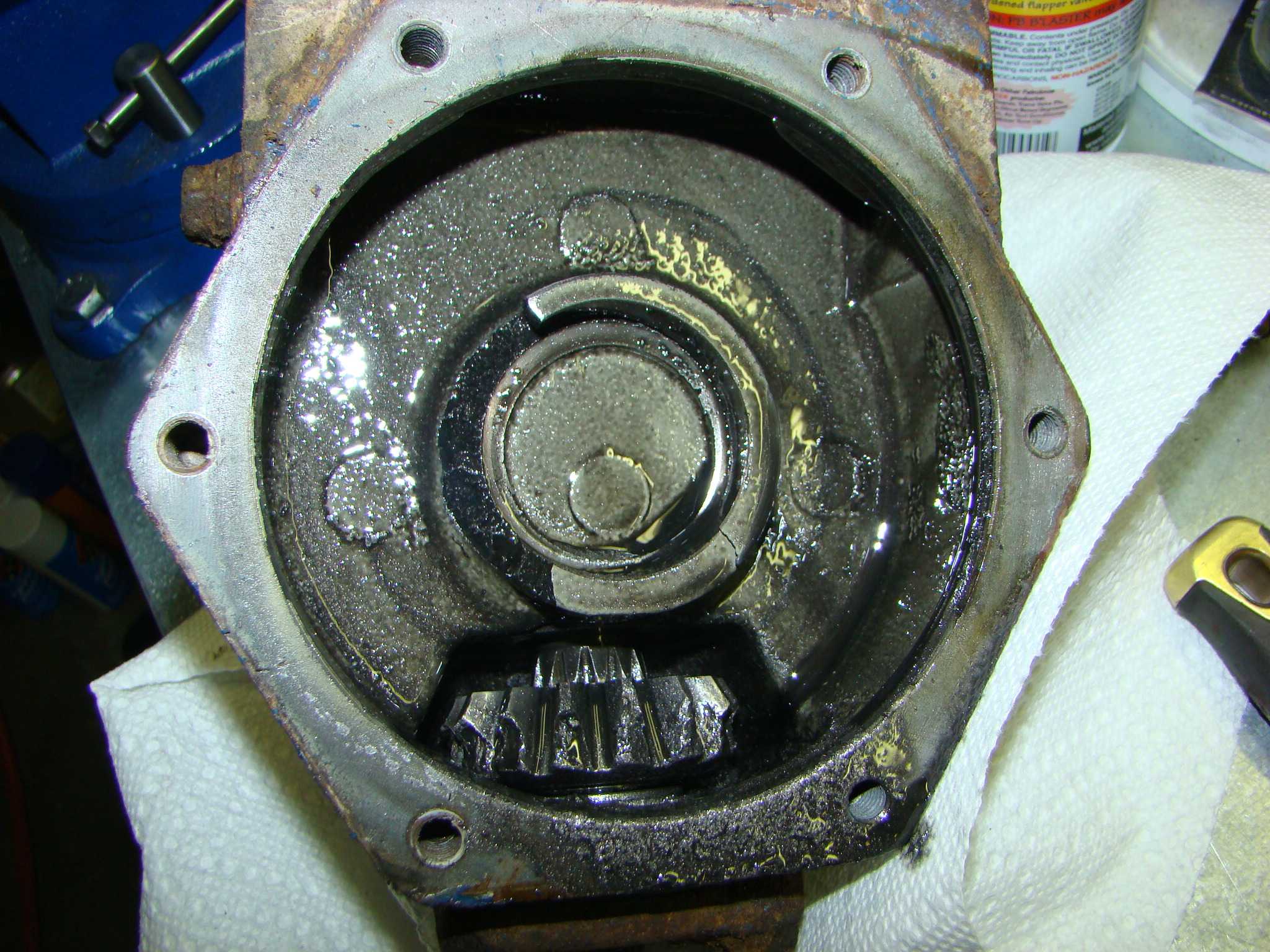

I would jack up one side of the tractor at a time and check that each front wheel spins freely. Attached is what I found in one of my front final drive assemblies. Between the broken boss and pinion the assembly would bind up as it turned causing most of the torque to be transferred to the other wheel and act like a brake on the broken one.

Have you tried removing the loader to see if it's weight is causing the problems?

I also have sandy land and my 47hp tractor can get stuck easily if I have it in 2 wheel drive and nothing on the back. the FEL puts a alot of weight on the front end . putting any heavy implement on the back will make a world of difference !!
on a side note you should be able to lift the front end up with the front end loader so you can check the front hubs.
   / digs too well #17
Yes. I think I'd either put some weight on the rear end or remove the loader to see if it helped. Which ever is easier and less expensive. It's surprising how much my new to me MF spins it's wheels with the loader on.

Jcarlile,
When you get suck, do the front or the back wheels start spinning first?
   / digs too well
#19
the rear
