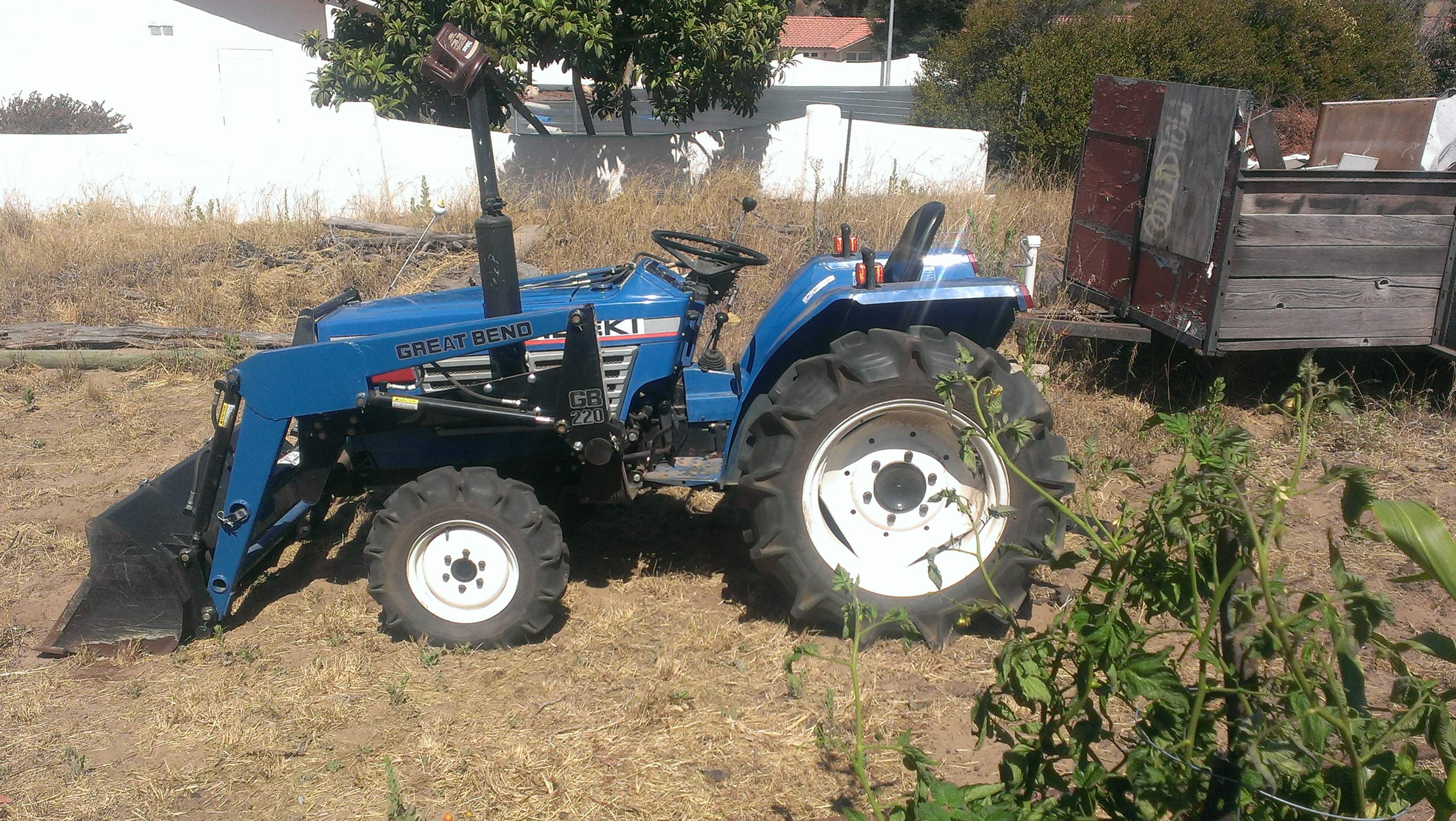

my few acres are sandy and soft. my iseki tu 2100 i just bought with a hole in the trans front cover. took apart replaced the cover and now up and running. every where it seems to dig and get stuck. do i need turf tires? new to this so i dont know. i need input please...

not pulling anything yet. plan on a small disc .but it seems just driving up a slight slope and i guess i'm turning to sharp it sounds like. my tractor has a gb loader on it and is 4x4.

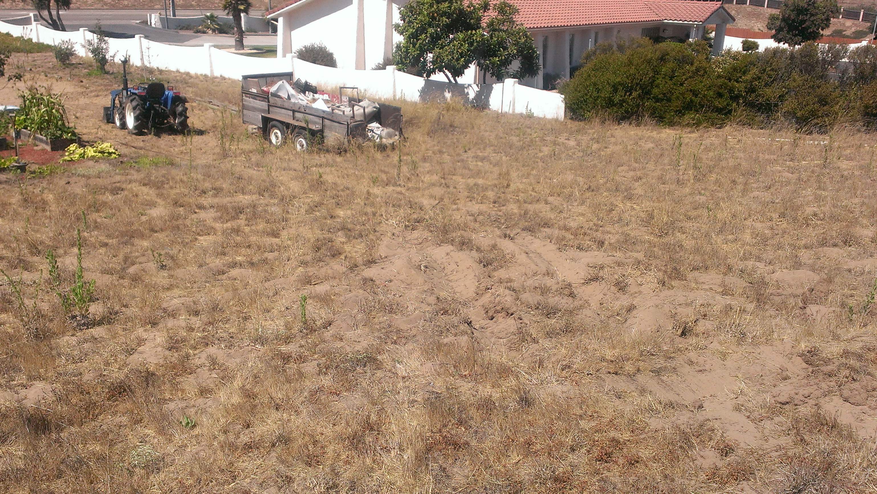

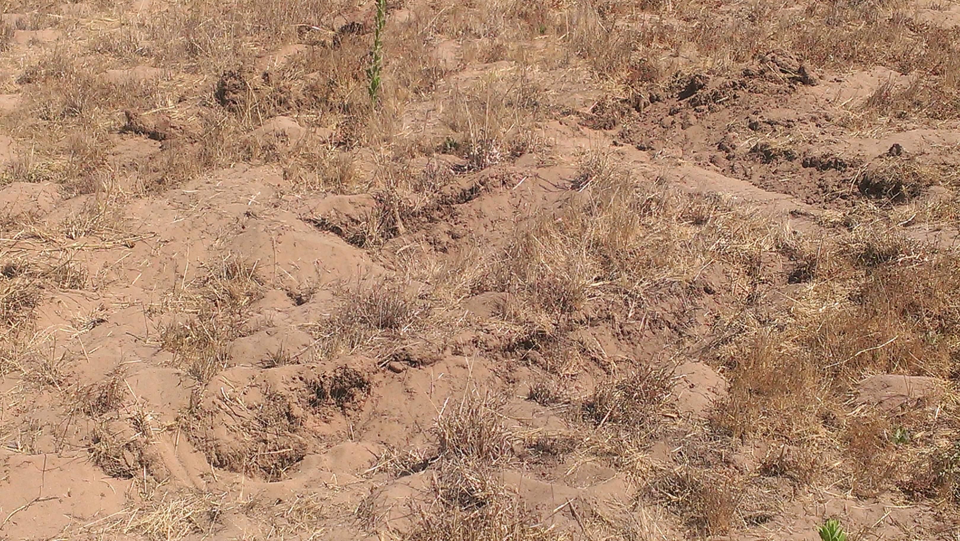

IMAG0282.jpgIMAG0280.jpgIMAG0281.jpg. The ground is like powder sand
/ digs too well #7
I don't think your front wheels are engaged when you're driving up that slope. It will also really help if you mount a box blade or other heavy item on the rear hitch to take weight off the front axle, so you won't sink in as deeply.
/ digs too well #8
Ground is certainly sandy! But still you should be able to drive over it without sinking although the FEL weight does cause a lot of pressure on those little front tires. Keeping the front end engaged and not turning short will certainly help keep the front from sinking in - it will always be trying to climb out. That's is especially true when pulling a trailer like the one shown which probably sinks pretty good itself.
/ digs too well #9
Maybe the pictures don't represent it that well, but I would think that ground should be managable with your machine even pulling a small implement. By the time you start pulling an implement most of the demand will be on the rear tires and the fronts shouldn't be "plowing" as much if they are now. Are your front wheels turning freely? You might want to verify that just to know for sure as I experienced mechanical problems with one of my 4wd tractors that was causing one of the front wheels to not rotate correctly. You may also have to choose your routing so that you're only in the real sandy area while going downhill with the implement if possible. I recently backed a 1200 lb. single axle trailer up an incline that appeared to be steeper than what you have in similar soil with my TX1500 (smaller and lighter than yours). It wouldn't do it in 2wd but in 4wd it was fine. Slower wheel speeds may help some too.
