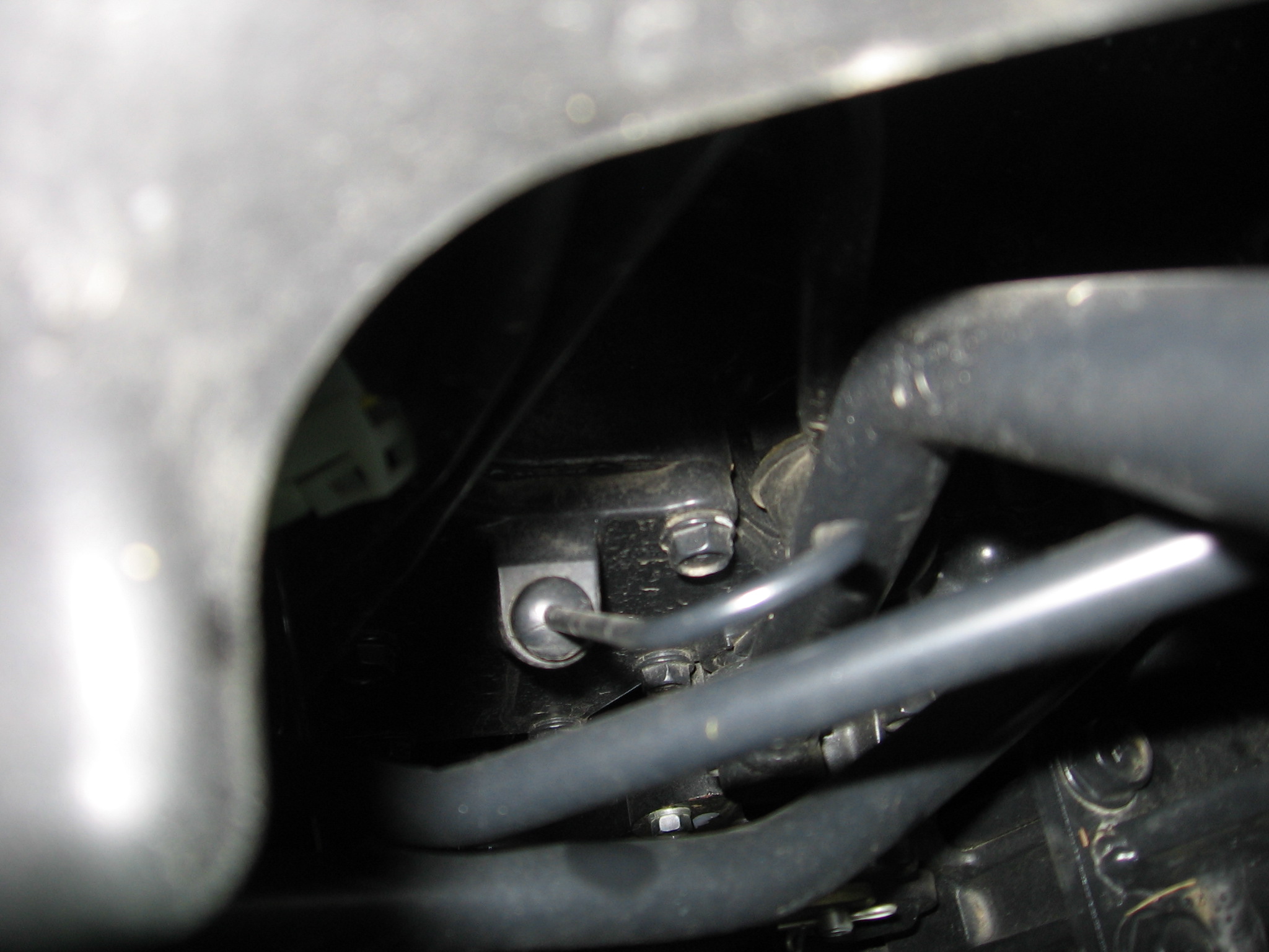

Hey guys
Tell me that isn't what I think it is?
It's just about impossible to reach.

/ DIPSTICK?? #2
Looks like a dipstick to me:) maybe you could fab up an extention for it?

Hi Roy
That's not my engine dipstick,it's yellow and up front. This thing is under the hydro high/low lever,what looks to be in the transmission area. I just happened to be looking the tractor over for leaks and loose bolts when I saw this thing.
It's basically hidden,you wouldn't see it unless you knew it was there.

Sorry about that...your picture was such a close up, I thought it was in the engine bay.
Reckon if you really want an accurate answer, you'll have to contact your dealer. Your manual states the transmission fluid is checked at a sight glass at the rear of the tractor.
Don't be surprised if your dealer has to contact Deere to find out why that dipstick is there. When you do find out, please post it in this thread....I'm kind of curious now.

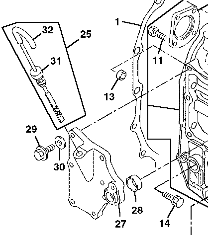

Could the dipstick be a design change that hasn't made it into the operator's manual? It wouldn't be the first time, nor will it the last time such an error has occurred.
/ DIPSTICK?? #7
Looks like JD Parts calls it a dipstick.

I just went to JD parts and sure enough it's in the transmission housing parts breakdown,but it doesn't have a part number. That tells me, no part number means it doesn't exist!
Greg
JD Parts shows the part number as M807561. $23.65 !!
Part Details
Part Number: M807561
Part Price: 23.65 USD
On Hand: 0 Check Other Stores
Description: GAUGE, OIL LEVEL
/ DIPSTICK?? #15
As shown in my previous attachment, the complete dipstick is item number 25. The individual parts of it are 31 and 32 which are not available separately. If you are registered with your password to JDP, you can put M807561 into Search By: JD part number and come up with availability in your local dealer stock along with price.
