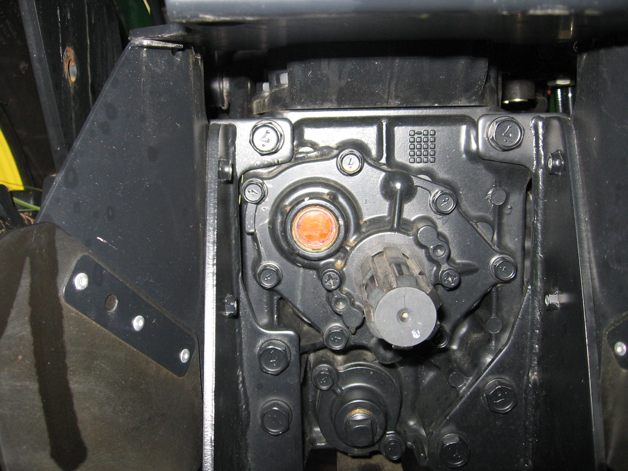

Hey JB
Funny you should say that,because I am scratching my head too. It looks like it is overfull.
Greg

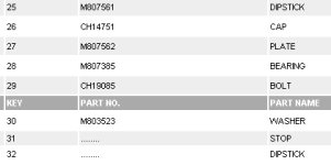

   / DIPSTICK?? #15
As shown in my previous attachment, the complete dipstick is item number 25. The individual parts of it are 31 and 32 which are not available separately. If you are registered with your password to JDP, you can put M807561 into Search By: JD part number and come up with availability in your local dealer stock along with price.
   / DIPSTICK??
#16
Thanks JD755
I didn't notice the "assembly" item 25:eek:
Greg
