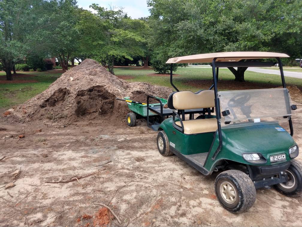

I have 1 acre of land, and about half of it is lawn that I have sodded and really meticulously try to maintain. Next spring I will get a load or two of sand brought in and work on top dressing and leveling the lawn. The more sand I can haul per scoop the better! This is a process I'll probably have to do every year for a few years to really get it where I want it. This is currently my biggest desire for the dirt scoop. Beats a wheelbarrow and shovels!
I did a good bit of work this spring with a gold cart, shovels, and a small dumping trailer.

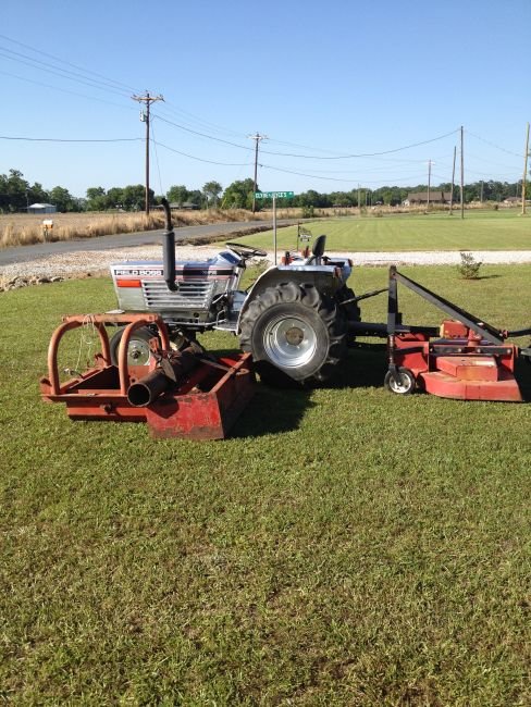

Attached is a picture of the same tractor. I don't have a picture of mine (if you read my intro post it's not actually mine, it's my dad's and it's currently parked at his house in his shop). I just googled this picture.
If it makes a difference, it is 4wd, with knobby tires and weights on the front. I think the tires are just filled with air. p1401500632800259.jpg

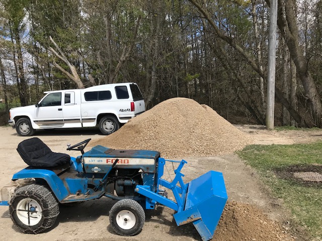

I built my own scoop, lifts with a winch. I made the bucket 36" wide and it works pretty good for what it is. I moved all that gravel in the background with it. Yours being a bigger tractor, I would think a 36" would be no problem.

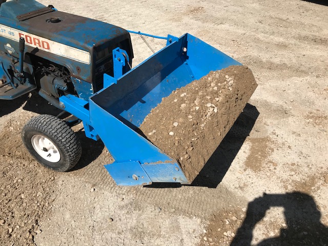

View attachment 676280 View attachment 676281
