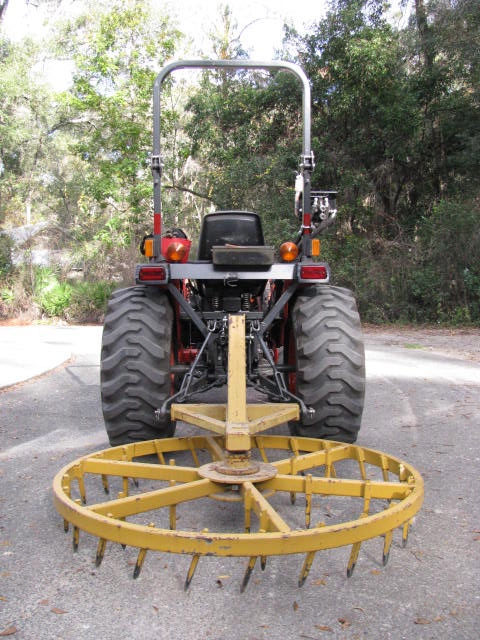

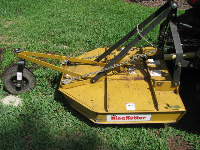

I really do not want another trailer. I want to go a step beyond my existing Rollover Box Blade.
I have a King Kutter Rotary Mower and a King Kutter Rotary Harrow, both manufactured in Alabama and satisfactory attachments.
