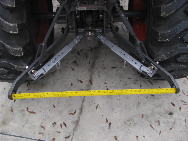

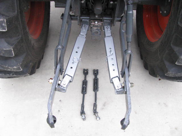

Link raises a new question: Is the three point hitch on B3300SU sufficiently robust to withstand long term strain of pulling Hoelscher DB-4?
Probably not. I replaced Kubota 3.7 pound turnbuckle check chains with aftermarket Stabilworks' 14.4 pound pin-adjustable, rigid stabilizers primarily to ease loading of implements but also to increase support for the lift arms. The relatively light B3300SU 3-Pt.hitch may be the deciding negative, not B3300SU power, not weight, not traction; all unfortunately marginal.

That Hoelscher thing is only 1 m3... horsepower requirement of 45-50hp is probably true for a compact tractor, but the weight of the tractor decides if it will fill the pan or not... The CAT1 3pt trunnion will be torn off with a 50hp farm tractor...
Large pans are filled by a 10 ton large MFWD and hold 17 yards (12.4m3) so with an experienced operator, one should be able to fill 1.24m3 per tonne of tractor weight. If i ever have time, i'd be interested in building a 4m3 pan :)
Absolutely no problem, because it only pulls on them. Even when digging in reverse with a 3pt bucket i didnt buckle the lower link arms, i just buckled one once while i was backing up with a 6m3 manure tank while pumping water from a canal while standing on a farmroad bridge: When i backed up, the tractor rear wheel went into a pothole and the entire 12 ton combination stopped instantly when the lower link arm hit the edge of the concrete deck.
CUTs are built lighter than farm tractors, but there is absolutely no problem when PULLING on them. Lateral forces arent that big on the lower link arms because the trunnion allows for articulation.

The specs for the DB4 also indicate a max HP of 35 and the 50 was the max HP for the 72" pan.
Jnasystems: You are correct.
Hoelscher recommends 25-35 hp for DB-4, 35-50 hp for DB-5 and 45-50 hp for DB-6 / 72".
