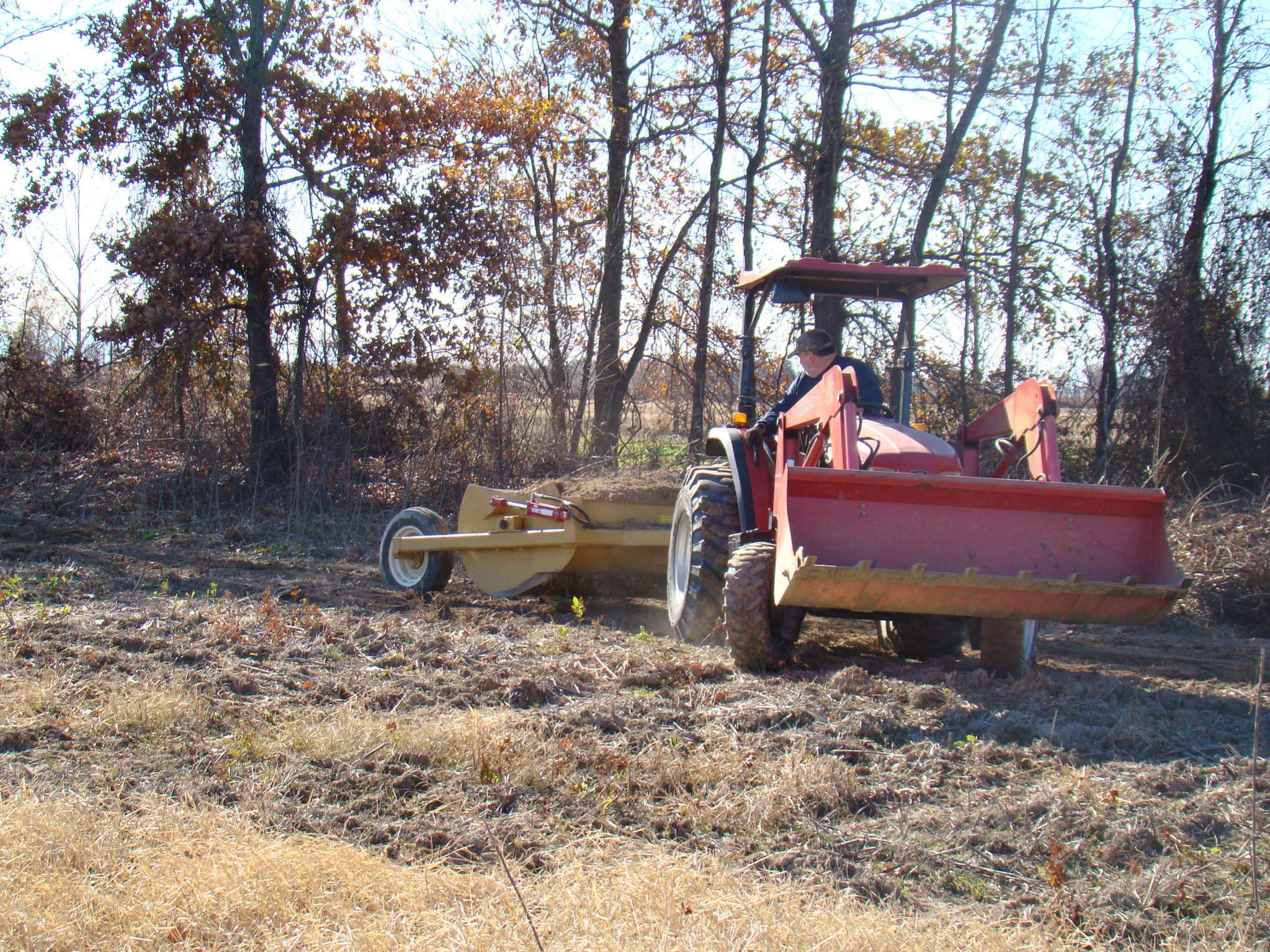

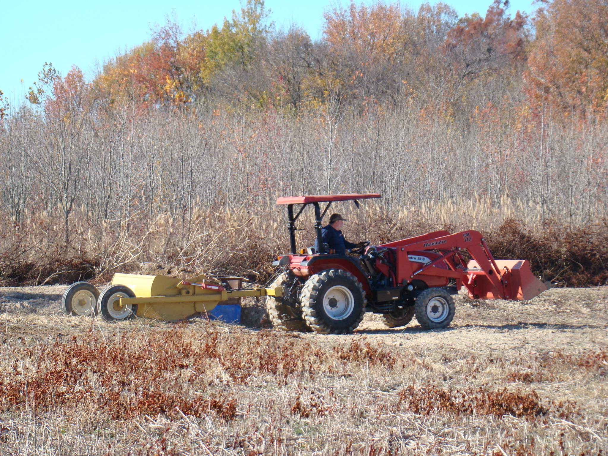

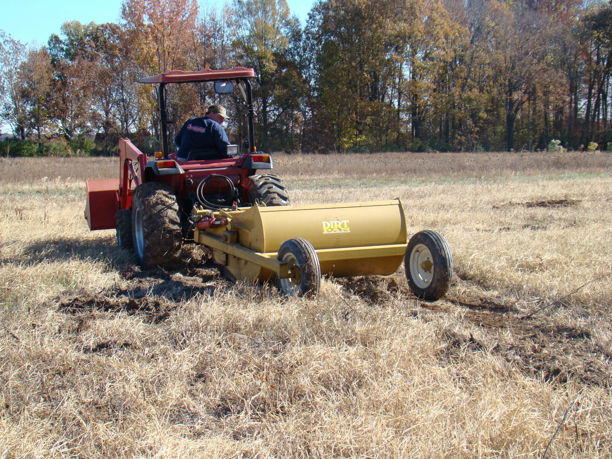

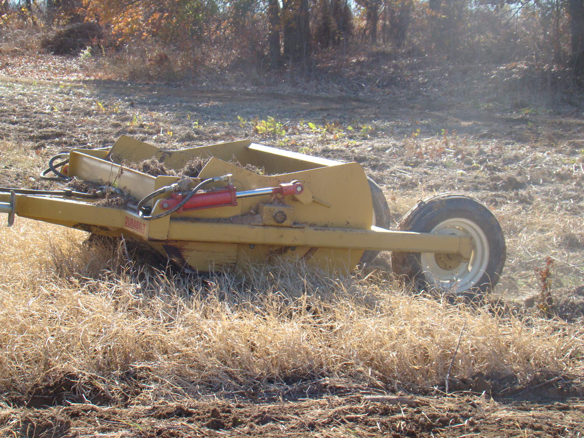

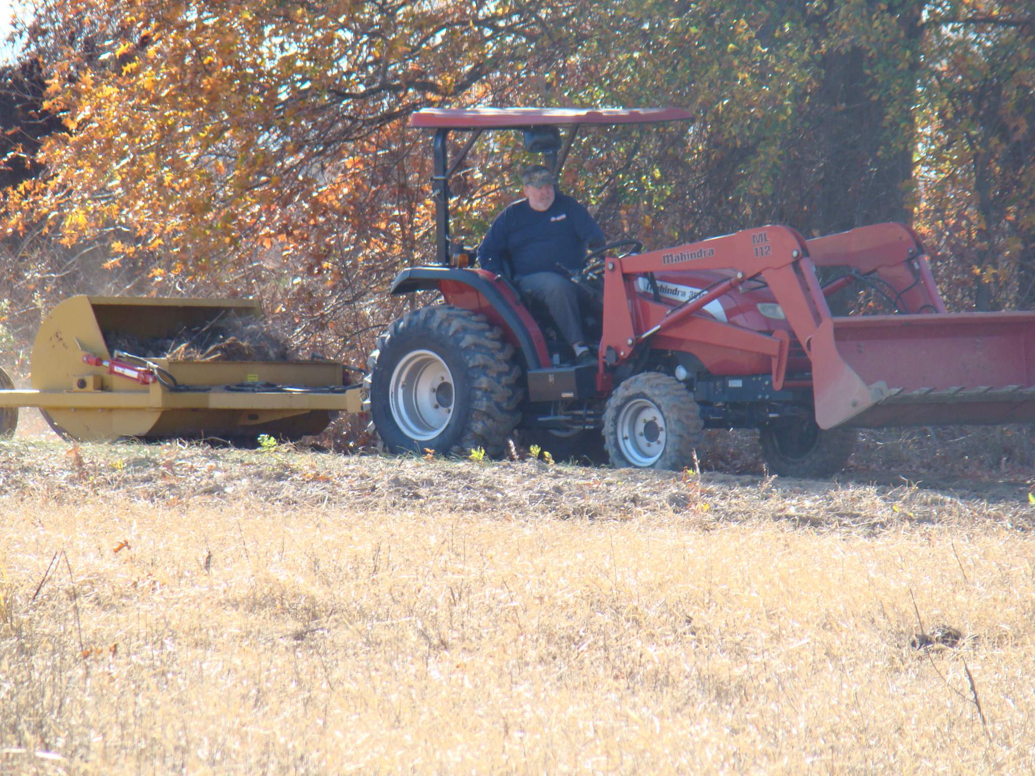

I have a small pan, DP-60 by Durabilt, that I use with a 3510 Mahindra in Mississippi Delta gumbo when it is dry. Works great cutting a few inches at a time. Takes about 50-60 feet to fill. Once the topsoil and organic matter is removed, it is easy to fill overflowing.
I bought it used for 2K. Southland Equipment in Batesville, MS has them new for $4200.
