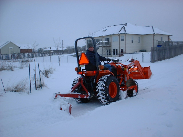

We got about 7" of heavy, wet snow on Sunday and the 60" rear blade on my BX2200 just wouldn't cut the mustard. It would manage about a strip and a quarter before it wouldn't push the snow back any further. I wound up clearing with the loader again which takes more time. I am pulling the blade facing forward with it angled at the sharpest angle off to the side. Am I doing something wrong or just expecting too much out of the blade? /forums/images/graemlins/frown.gif
The good news is the loader works fantastic and the tractor in 4WD low just doesn't get stuck! /forums/images/graemlins/grin.gif

Well, first, the blade is probably to big. I would use a 48 or 54 inch blade. Second, push the blade in reverse with the blade still in the forward direction and the blade angled to the side. Clear an area with your loader and then engage the snow using only about 1/2 the blade continuously moving the snow to one side only. That is what I did but I am not an expert on snow plowing for sure /forums/images/graemlins/smirk.gif. My 2410 will quickly push up a wall of snow and then just spin it's tires if I don't work from a cleared area pushing the snow further and further over to the side. I find backwards easier because the tires are in a cleared area and follow the path of the blade. Pulling forward would be more diffucult. Notice in this pic that I am clearing in reverse with the blade in the forward position. Notice the smooth path left for the little B2410. Yes, I am using the position control to slightly float the blade. JJ

Not to be a nitpicker /forums/images/graemlins/cool.gif , but I assume it's the tractor that's having a problem pushing the snow and not the blade, right? /forums/images/graemlins/confused.gif How long is the strip you refer to? You might be asking too much of the tractor. With the first pass, you're plowing 7" of heavy wet snow. Since the blade is moving the snow over, with the second pass, you're trying to plow almost 14" of heavy wet snow. With the third pass, etc. Or have I musunderstood something? /forums/images/graemlins/crazy.gif
I agree with Trescrow's advice plus I'd add rear wheel weights and/or load the tires. Adding rear wheel weights substantially improved the ability of my TC25D to push snow.

In times of much snow you may have to start from the outside and only roll one blade width at a time to the outside.

Don't feel bad, My TC18 was having similar problems. I've got loaded rears (200#) each & chains on the back side. I was only able to make two backwards passes (~50 feet) with the 5' blade angled 30 degrees before I had to shovel the curl with the loader. The first pass was a "full bite" the second I only tried to move a half width.
The blade was acting like a rudder, the tractor would keep moving (love those chains) but the front end kept sliding around & I'd end up almost perpendicular to my intended direction of travel.
Be assured it isn't so much poor technique as it is a physics problem. The little machines (sub compacts & smaller compacts) don't push heavy snow easily. I'm getting closer every day to buying a blower. Trying to find one for the right price...

What tires are you using? I use a 60" and shove stright back (no angle) 75' with no problem. I have Ag's for winter and turfs for summer. Even with a huge heavy pile of snow it doesn't hint at stopping. Are you in low range? Try the diff lock if you start to slip (surely you are in 4WD). Load the loader with a bucket full of snow to get more traction. I just can't imagine the tractor getting stuck, I would think the snow would spill over the top first.

I didn't read all the threads associated with your question so i apologize if this is redundant. We got 10-12 inches last week and my BX2200 + 60" blade worked like a charm. I did go in reverse and had the blade facing backward and at a max angle. In the 3 foot drifts, I raised the blade and plowed the top, then lowered the blade and pulled the rest out. My driveway is about 250 yards long and it took me about 30 minutes to clear. Just play with it to find what works best for your situation, but it can be done.

When plowing forward with the blade at maximum angle make sure you keep the top edge of the blade ahead of the scraping edge by shortening the top link.Then go as fast as you can to get the snow rolling.The secret is to get the snow to roll off the blade instead of bunching up.Works for me.Good Luck looks like we will be getting plenty of practice this winter! /forums/images/graemlins/smile.gif
