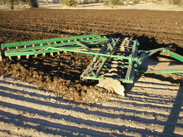

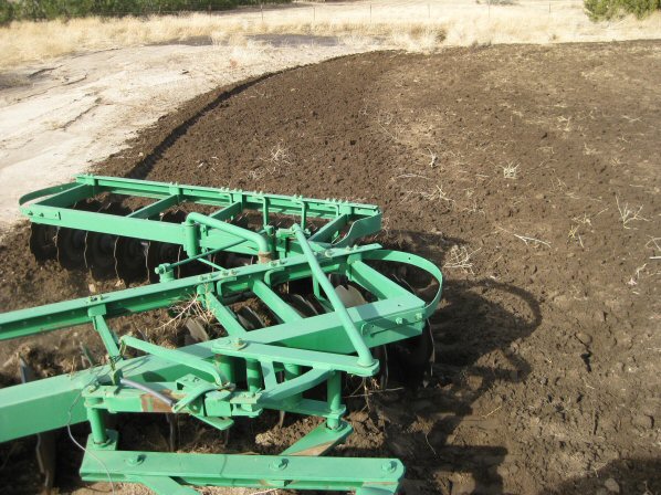

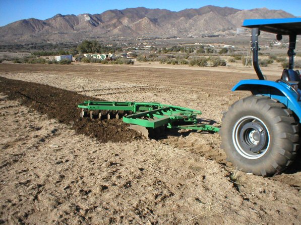

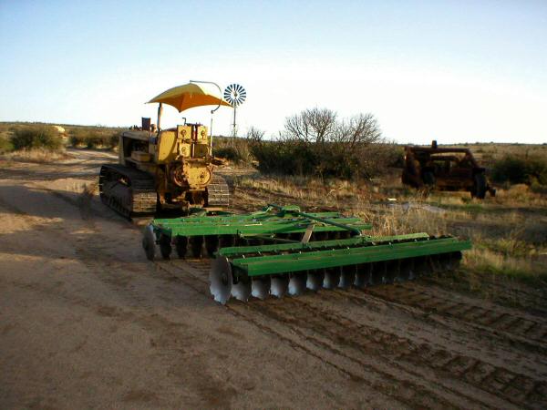

Actually we have a 6 footer, an 8 footer and a 12 footer. All offset John Deere/Kilfer pull disks. the old kind, no transport wheels. The 8 and 12 have the 22" serrated blades. I typically pull the 8 with my Mahindra 7520 4x4. It is a 75hp 10,000lb machine. The 12 gets pulled with our old D6. I can pull the 12 with the 7520, but only on pretty much flat ground.
The ramp idea may be a problem since the ramps have support legs on them. Here are few pics.

Those look like they would be a pretty high draft load. My 5303 I figure is going to be somewhere around 6500 lbs as it is set up. For the majority of what I do, the biggest areas being turned under are around 2 to 3 acres at one time. Most of our fields have been planted in trees over the years. The 8' disk seems like a good fit for the tractor, but seems like the 6.5' would be the most practical for work being done and transport. Jenkins recommends the tiller and that is something I have not considered. My initial thoughts go back to a 6.5' 3PT unit with 22" serrated blades. I have used an old 6' 3PT unit with smaller diameter blades that seems to cut better than a heavier, larger diameter blade 8' 3PT unit we have. The 6' unit is probably 50 years old and I am concerned that its light construction may not hold up under frequent use with the 5303.

If the 6' with smaller dia blades is cutting better than the 8' then I would say that the angle that the gangs are set at are not equal. As in the 6' is set at max angle and the 8' is much less. I don't think that anyone uses an offset disk for covering their seeded crop. An offset disk usually seems to cut deeper although that can be controlled with your position control and the angle of the gangs.
A tiller would give you the best seed bed I would think, but I don't know if that is really what you need. Steve (jenkinsph) is absolutely sold on tillers and I agree that a tiller does a wonderful job, just don't know if it needs to be that good for you.
If the areas that you are going to be doing are going to be done every year, I would go with a disk, the widest that you can comfortably move from point to point with your rig.
