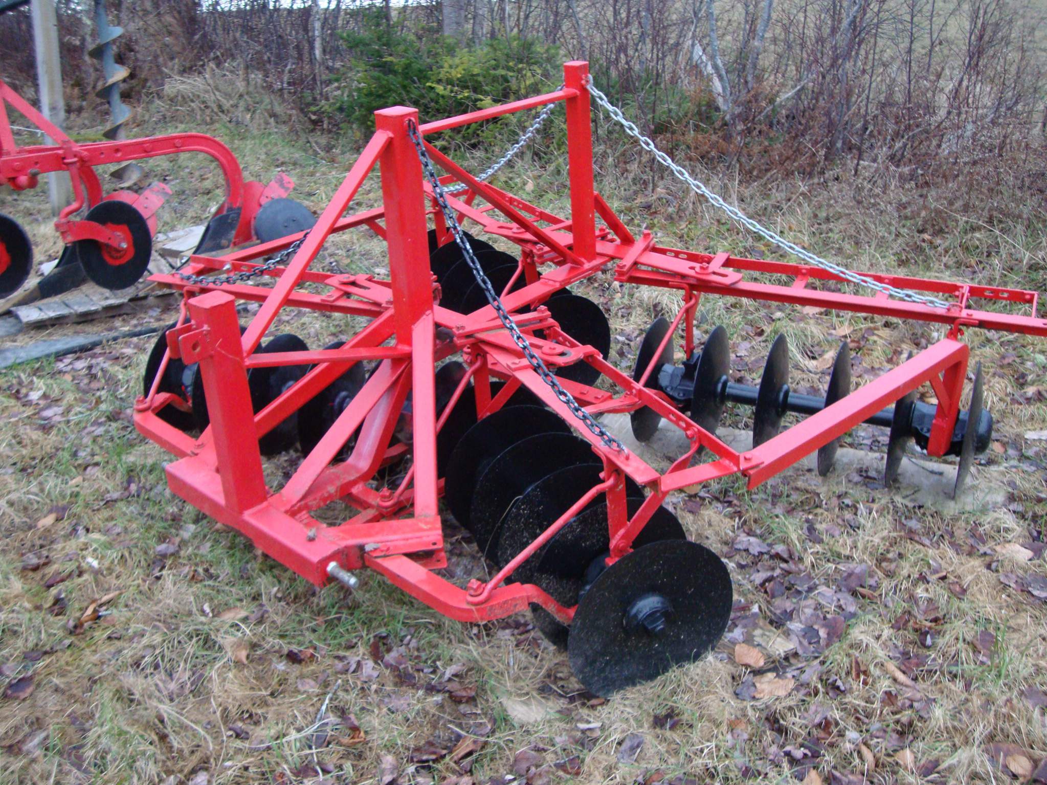

I have a N.H. 1510 4WD and I pull a 6.5 foot Edwards Heavy Disk. I am at 30 H.P. and as stated above, you need to pull at 4 or 5 M.P.H . to get a good soil turn. This is at the outside limits of what this tractor can handle. It makes my tractor work at its full capacity. I could make it work easier by taking off 1 or 2 pans, but so far this tractor has been able to pull this disk. You may be able to pull a disk like that but you may have to remove a pan or two. Soil and ground conditions will tell you what your tractor is capable of. My pans are 20 inch, Be flexable and adjust according to what you soil and tractor are able to handle. Maybe remove a pan or two. Good luck. You are going to push that tractor hard with 23 H.P. pulling a 5 foot disk. Keep in mind that you can remove or adjust the pans to be less aggressive and maybe go over the plot twice to get it done right.
If you don't mind me asking, just how heavy is your "heavy disk" ? :confused3: If people can see what the actual weight is, that gives them something to go by vs such a general description. One companies heavy is another companies medium. Just helps people that are looking to better understand. Pictures are a BIG help also. ;)

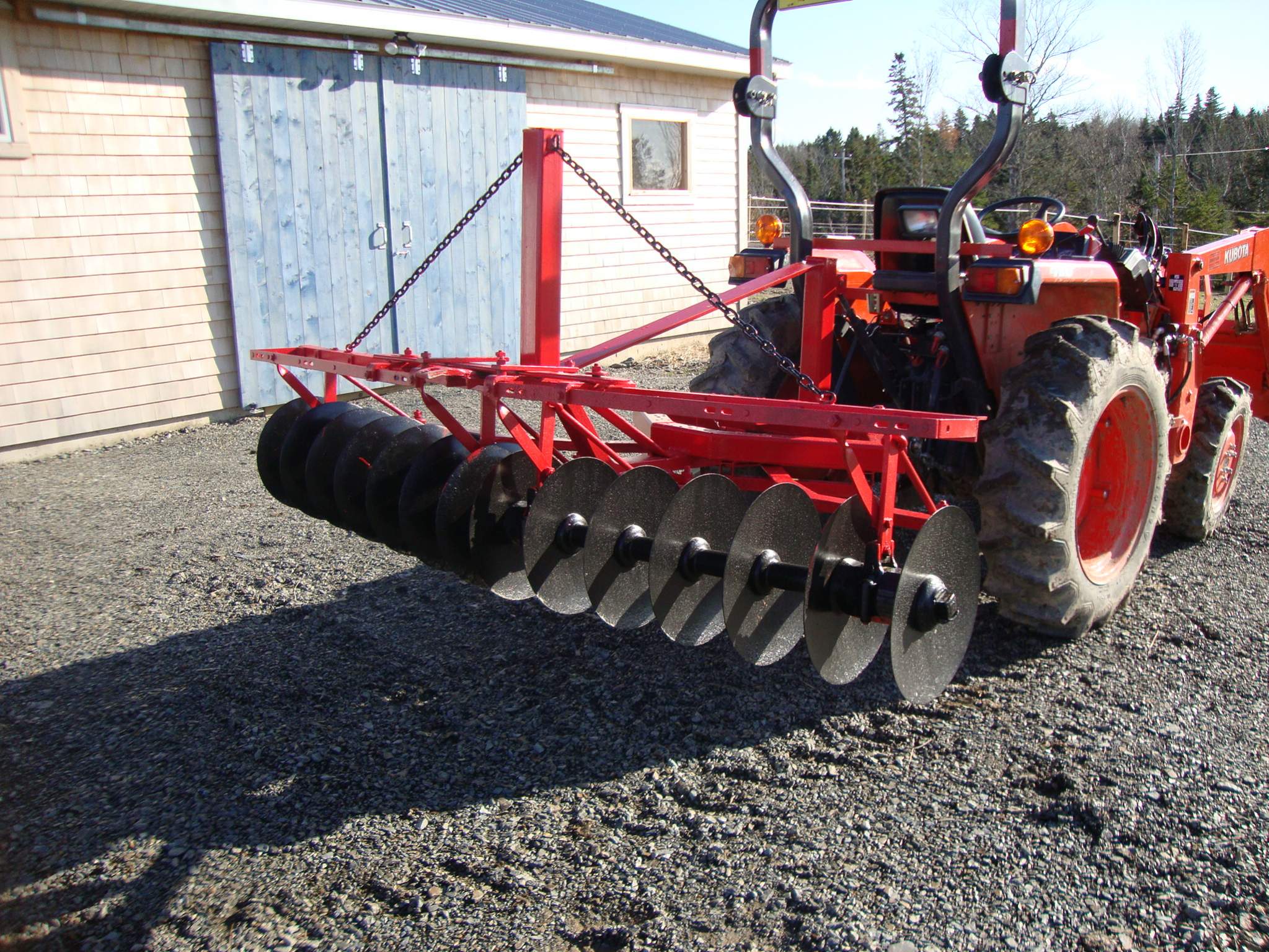

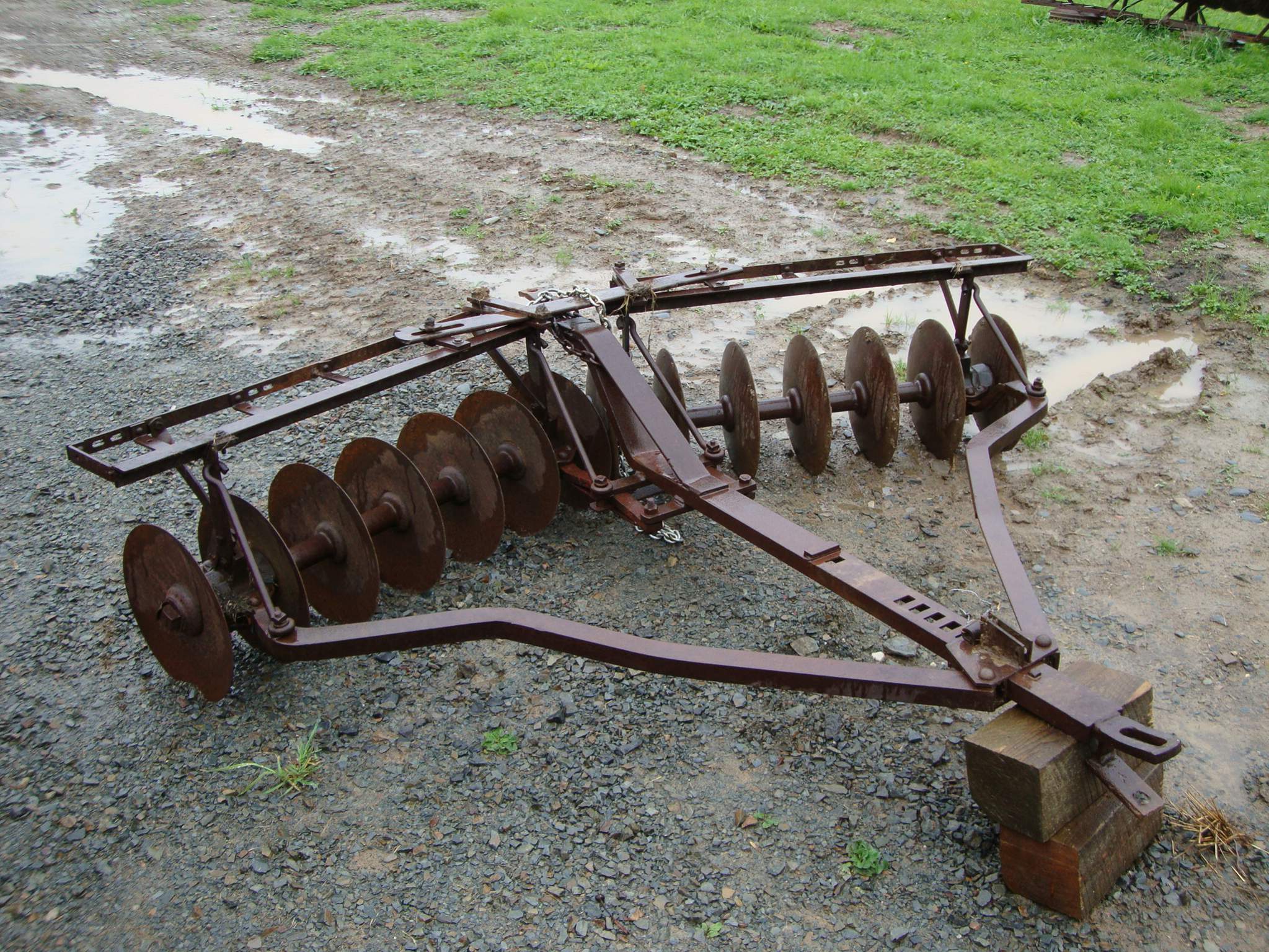

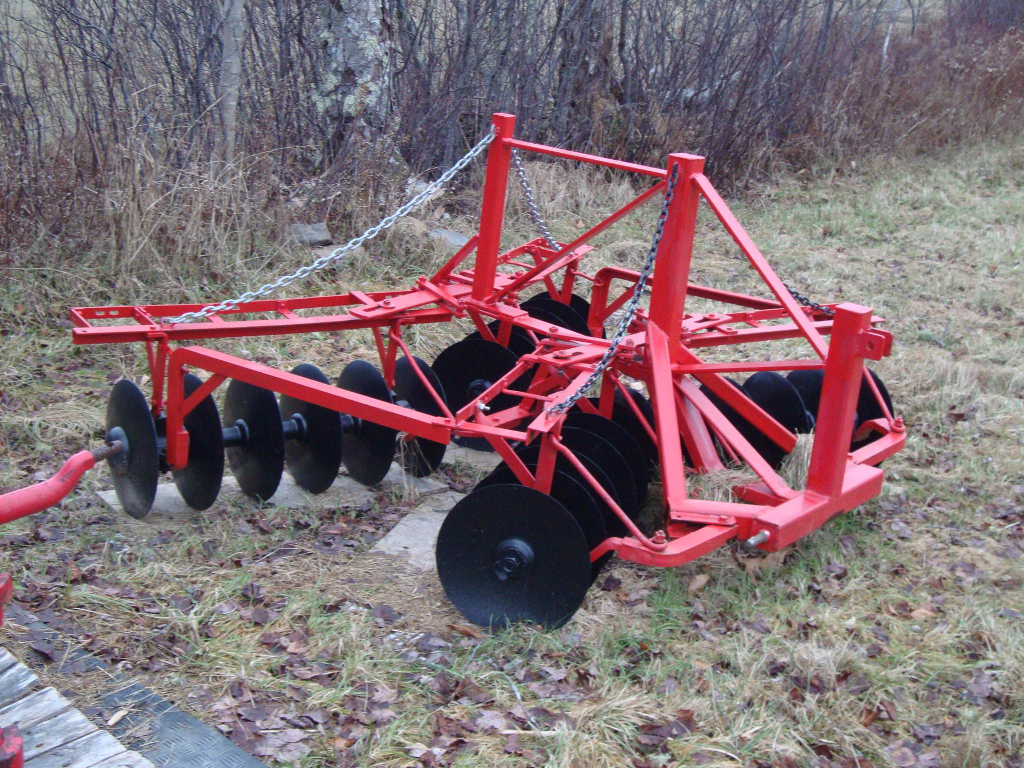

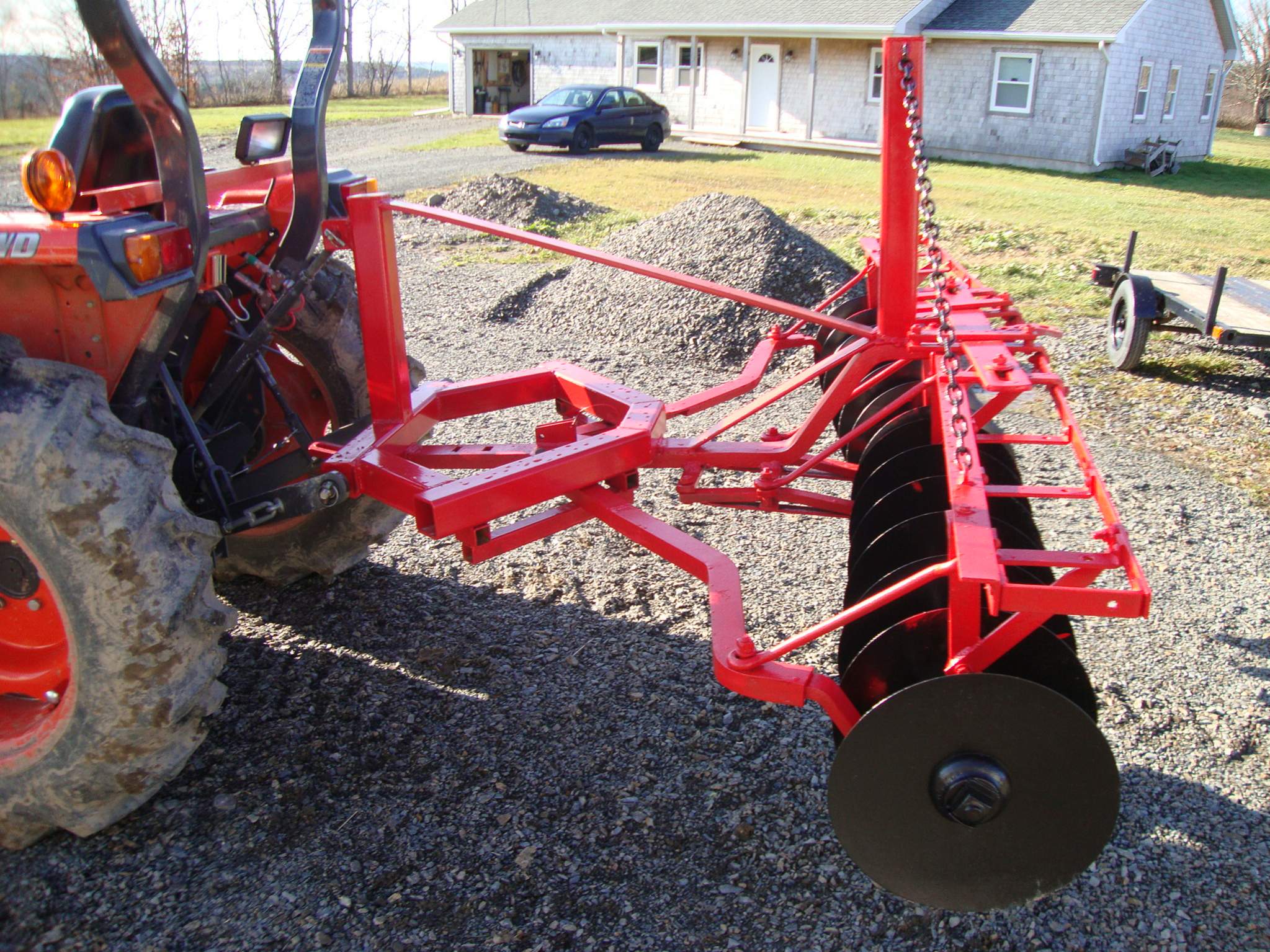

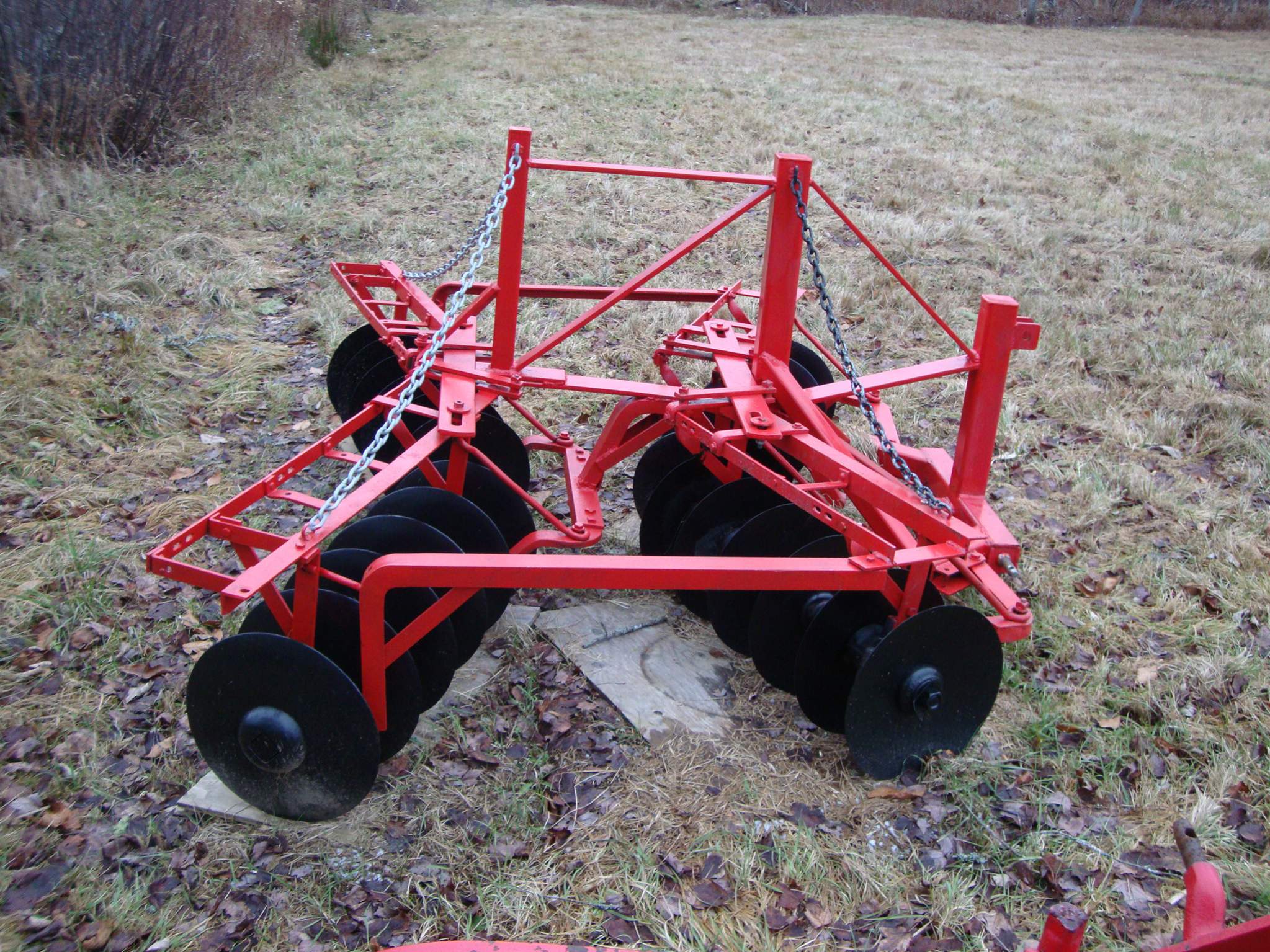

A Tandem Disc Harrow is what you want. A towed offset disc creates considerably higher draft force and has a cumbersome, left-biased turning radius.
   / Disc harrow advice #15
Where on the disc do you measure to determine its size ?
Thanks.
Measure across the box frame which supports the disc hangers. On both box frame Disc Harrows I have used, you can loosen the nuts on the u-bolt hangers and scoojie the individual discs a bit in either direction; maybe 6-8" of hanger adjustability per side, if the gang angle of attack is not too aggressive.
You may move the disc hangers to eliminate a undisturbed strip in the center or an undisturbed strip at some other point along the gangs, or to eliminate a ridge at the side.
Disc Harrows are usually nominally sized 6" wider than tractor rear tire width. My tire width is 59"+, my Howse Disc Harrow is nominally 5'-6". Maybe so one can disc closer to a fence line?

MtnView, sorry about the late response, holidays. I don't know what the weight is, and you are right, one mfg. idea of a heavy disk is going to be different from another. Sorry I don't have a pict. , I run 11 20inch pans all smooth in this disk, and it is all my tractor can handle. You can see this disk at Home :: Edwards Equipment Company ,keep in mind I only run 11 pans. I don't want to get close to a highjack here, but I have 2 of these and one is set as the disk, and the other is set up as a hiller for raised beds and hilling potatoes. Works great. Both of mine are older models, but the only difference is the 3 pt. hookup. Also, I am on flat ground, previously plowed and sometimes I have to draft up if I loose traction.

I pull a 6.5 foot tandem disc behind an L3400 (35 hp) Kubota without any problems.
With 20 HP, I have my doubts it would handle it. The tandems do pull quite a bit easier than offsets, but traction may be your biggest challenge, not HP. The Kubota with loader is roughly 3600 lbs and 4wd with AG tires.
I'm guessing the disc weighs in the vicinity of 700-800 lbs considering it doesn't want to lift much more. My rotary cutter is 770 lbs and it lifts that without any trouble, but it's also a bit shorter than the disc.
Like the guys have suggested, it might be well advised to look for a 5 foot disc. They would have been special order here as well, there isn't much of a market for them. For any disc, for that matter, although we're not really in major farm country here.
