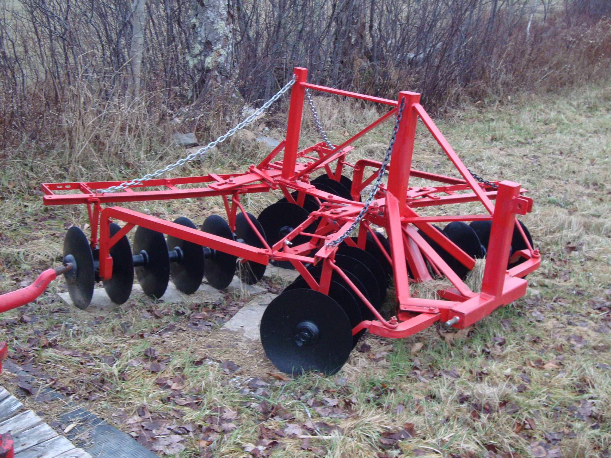

Nothing wrong with a fixed angle frame. Although mine is adjustable in theory at least, I doubt I'll ever have much use for that function. I simply set it to the most aggressive position and use it there. I'll attach a couple pictures of mine later today, it's definitely one of a kind.. :laughing: It's what you end up with when someone gives you something for nothing, and you're just too dam* stubborn to bite the bullet and go out and buy the proper tool for the job. My problem was that I have a welder and a pretty good imagination. Plus, anything decent would have cost me almost $2K to buy new, and there's simply nothing used available locally. To prepare a couple of gardens a year, it's hard to justify that kind of money.
Sean

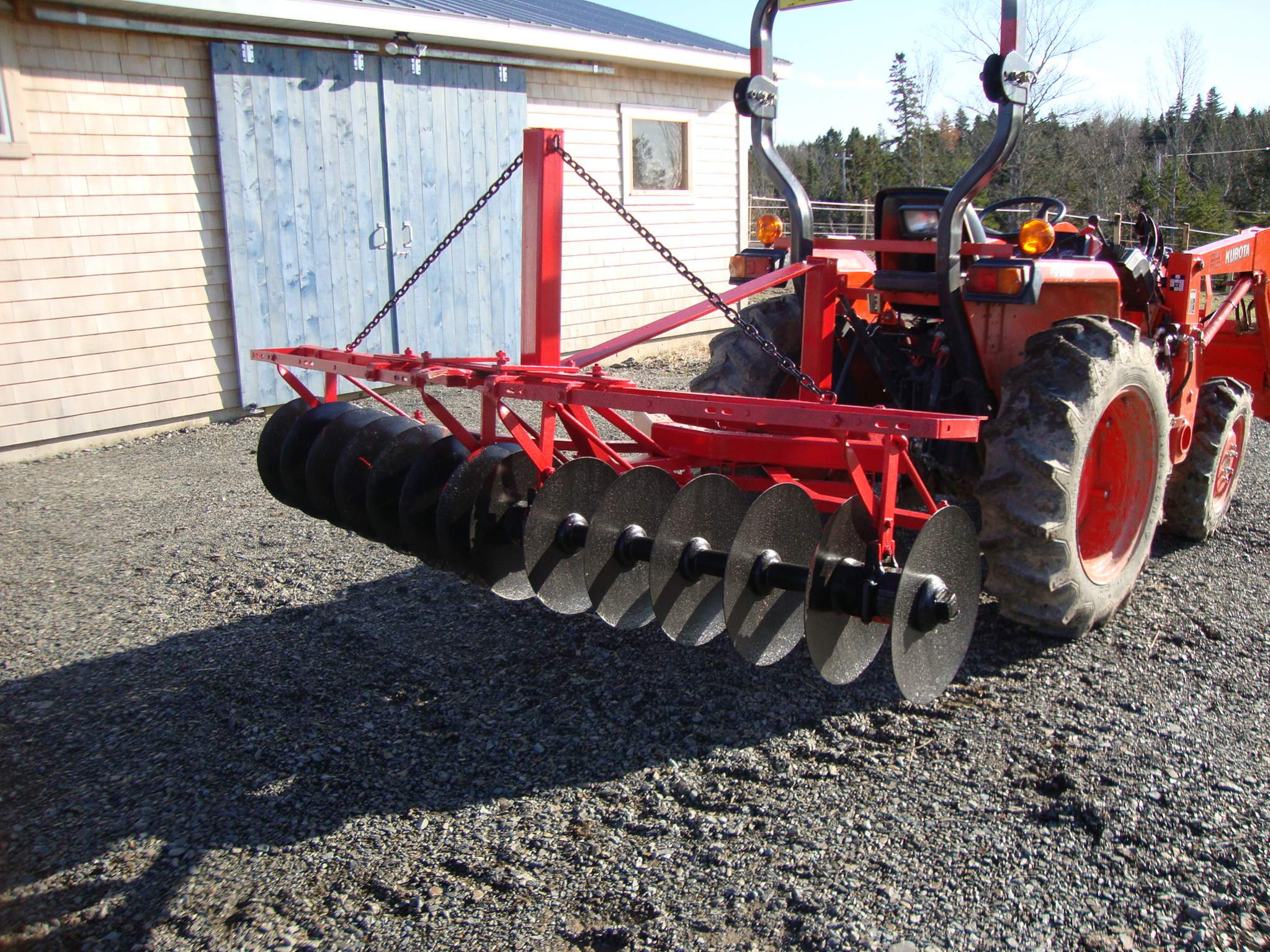

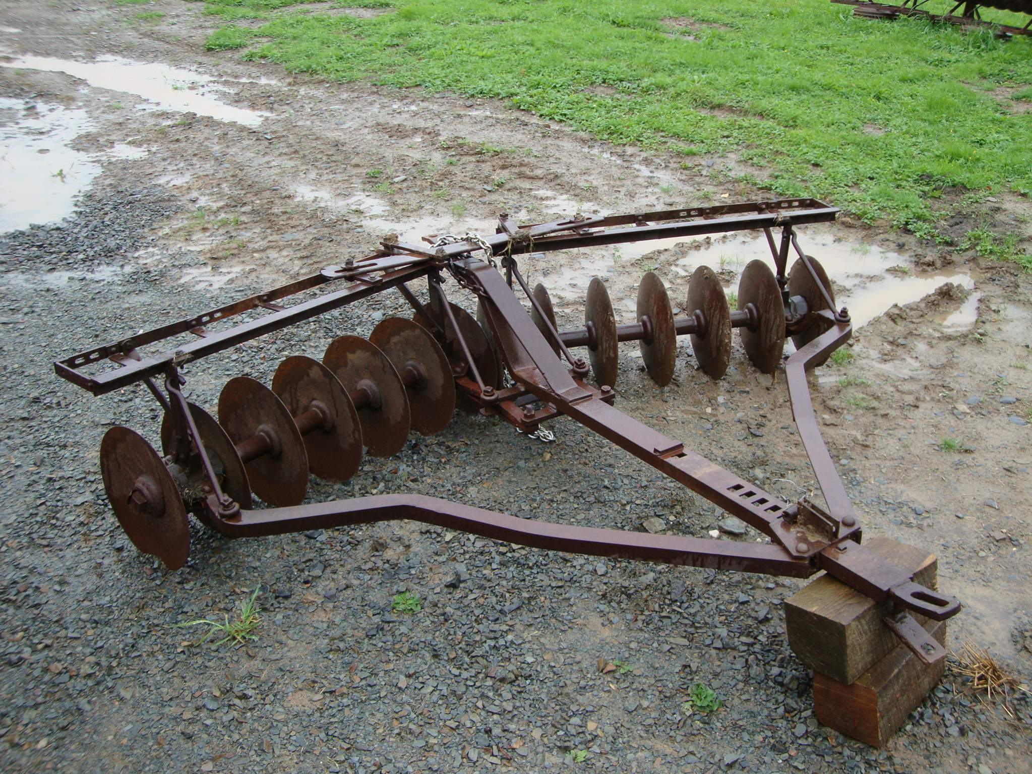

If it's any help, this is what I have. There's no rigid frame as far as the disc gangs are concerned, except for the center "spine". Originally it was an articulated two piece drag disc, as shown in the first pic. The second disc simply towed behind the first one. It was an old Massey Harris disc, God only knows what year it was made.
I never used it in that configuration, instead I modified it to be a single row three point disc as shown below. While it worked, it didn't dig very well and took too many passes to prepare a seed-bed, every pass compacting the ground more under the wheels of the tractor. It was adjustable for angle, but was left in the most aggressive position. I added as much weight as the 3-point would lift, but still had mediocre results. The gangs are shown nearly straight in these pictures, it was a pig to adjust unless you had the weight off the ground.

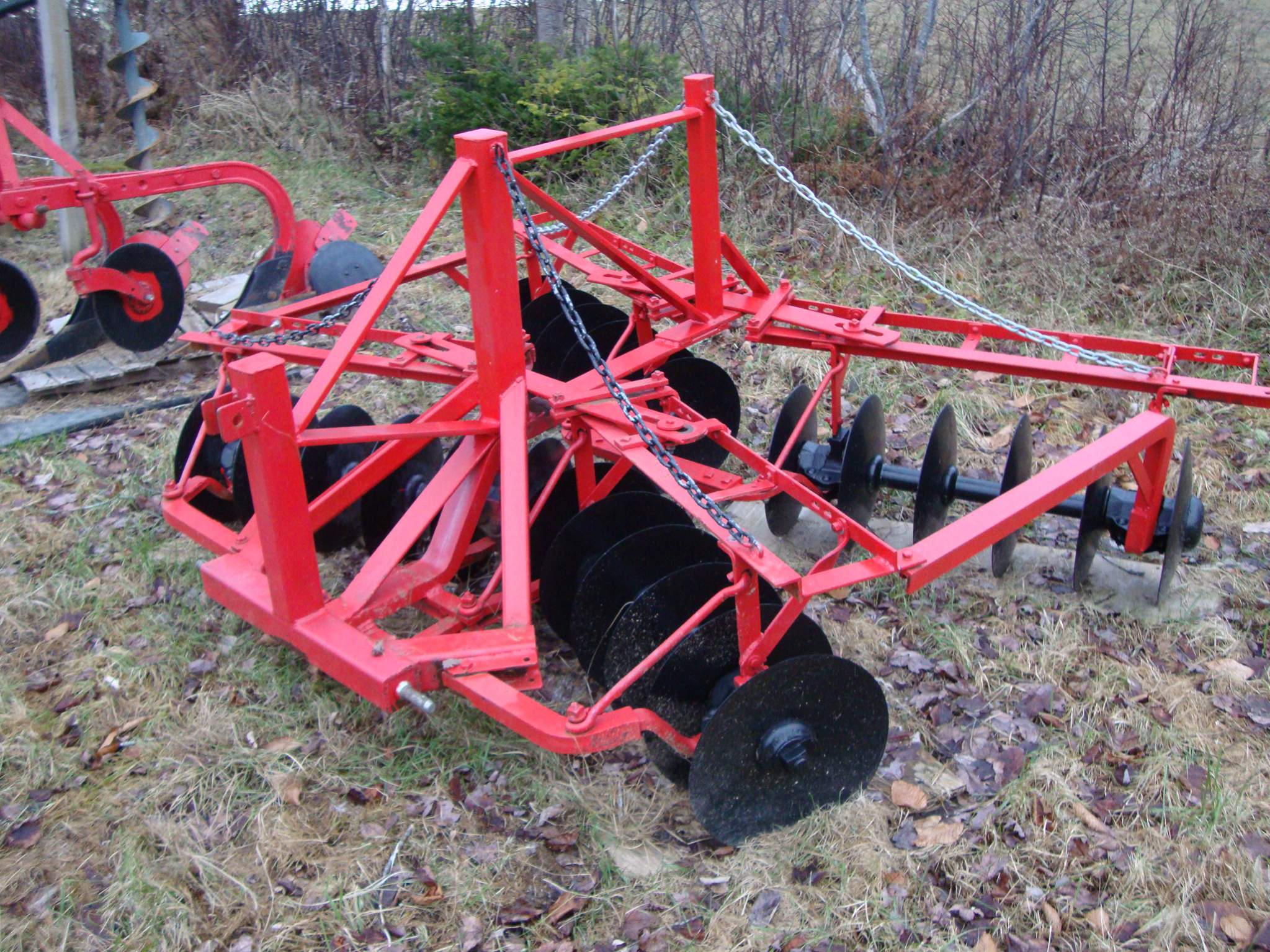

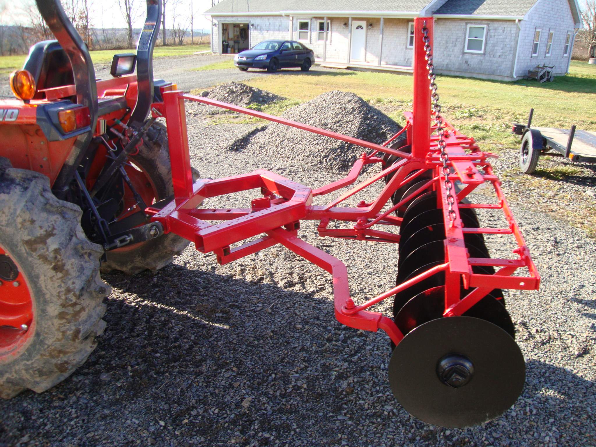

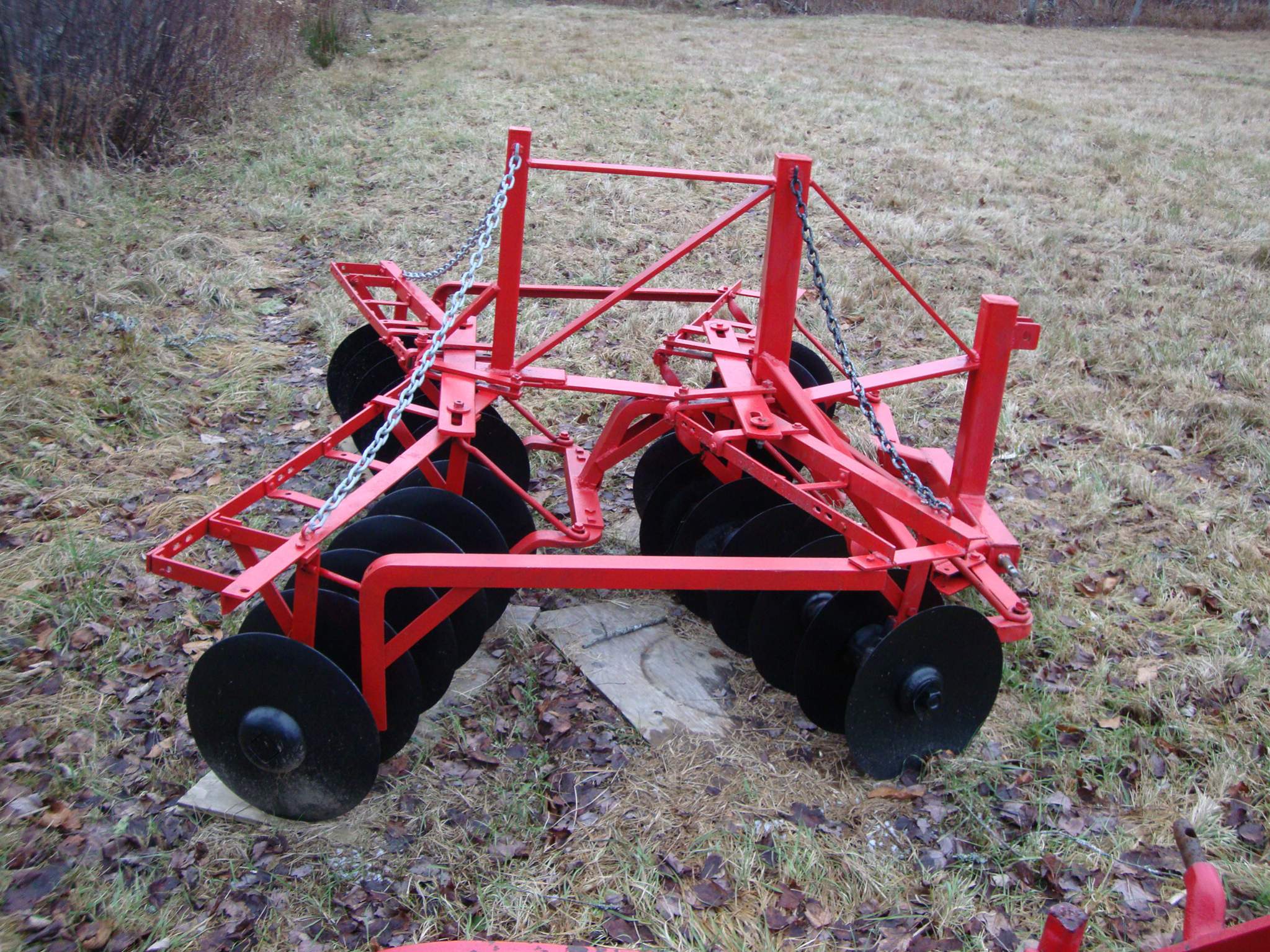

So this spring, I decided to try adding the second row of discs as a last resort before scrapping it and buying a rigid frame model. The chains support the weight of the gangs while being transported, they're slack while it's working. All the cross bracing and hangers seem to keep everything fairly stiff, which was the intent. The weight of the second row keeps the front row digging, much better results. Both gangs are raked at roughly 21 degrees from square and seem to work well there.
Not sure exactly what it weighs, but I made it as short as I possibly could, removed one disc from each gang to get more ground pressure and make it easier to pull. As it is, the Kubota will just lift it and that's about it.

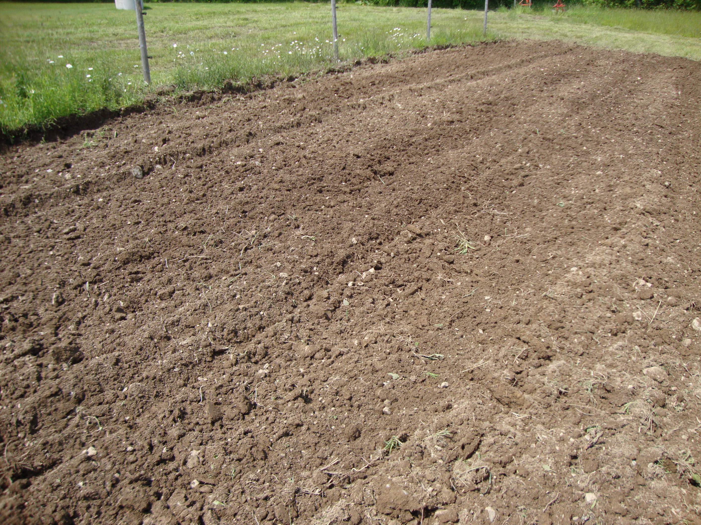

While the soil we have is still a work in progress, the improved disc makes garden prep a lot easier and quicker. I need to add a piece to level out the strip between the gangs, as it still leaves a ridge on every pass.
Sean
