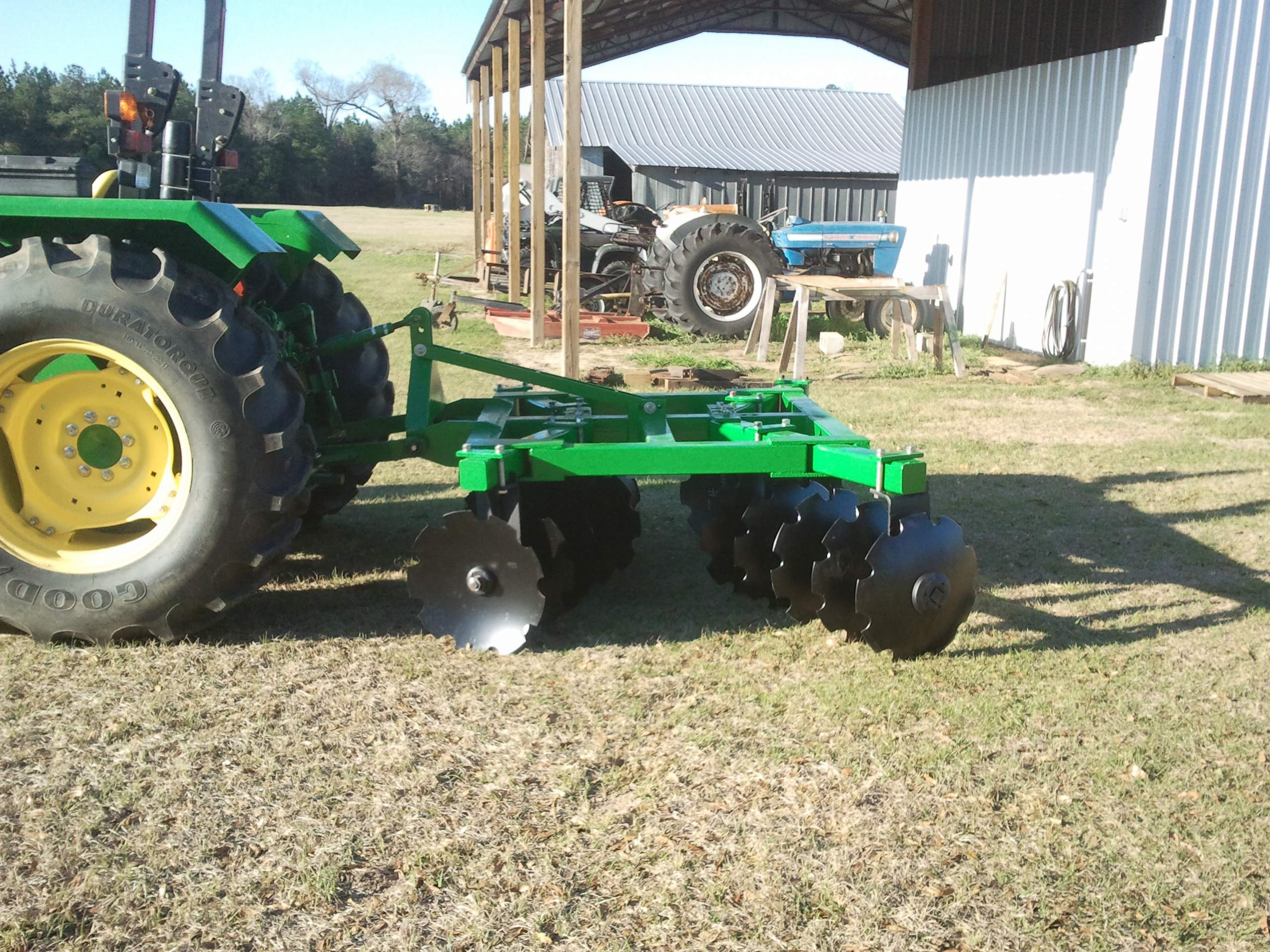

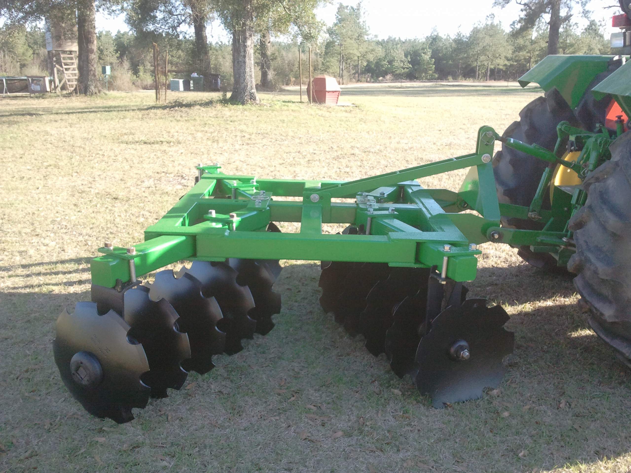

Blades came in Friday and was able to get it finished up today. Measured it across at 96". Got a chance to try it out and it seems to do just fine. Wind here today is blowing 20 mph or so and around 40 degrees. Cool for my part of the country. Will get a little more time to really try it out when it warms up and dries up some. Thanks for all the suggestions and recommendations along the way.

Sure looks nice !
What ya think it weighs with that 4" frame almost 1100 maybe ?
Boone
   / Disc Harrow Alterations
#76
Good question. Not sure. May have to see about weighing it at some point. The blades were around 450 lbs and the gang tubes are 1/4" x 4". That is probably a close figure.

Great job on the restoration.:thumbsup:
Can't wait to see how it does this spring, couple of passes and it will sink to the axles. Let us know how it goes.:)
