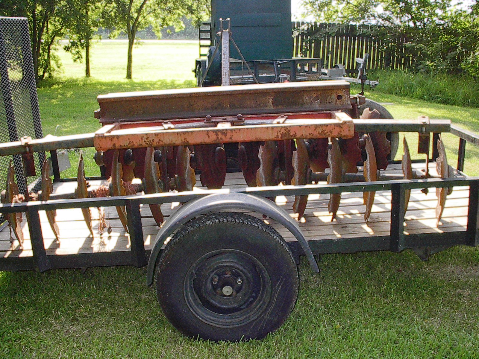

I have recently purchased a used Long disc harrow. Have just now gotten a chance to look it over. Got a few things I am wanting to do to it.
#1) It measured 9' across the back disc gangs. I prefer it to be 8' since it would make it easier to transport and get around in the woods with. After looking it over this morning I determined I could unbolt the hangers and slide them in. The rear is now adjusted to 8' wide. I noticed I do not now have the typical wide gap between the rear gangs. I used it this afternoon and turned under about 4 acres with no noticeable issues. Anyone ever dealt with this and is there any reason for concern? Should I just move it back?
#2) Took the outside disc blade off on each of the front axles to verify the axle size. According to my measurements they are 1-1/8" axles. The blades right now are very worn 20" blades and I am entertaining the possibility of going back with 22" blades as this was what I was wanting on a new one. I figure they will be a little heavier and taller and should cut better. Any reason not to pursue this?

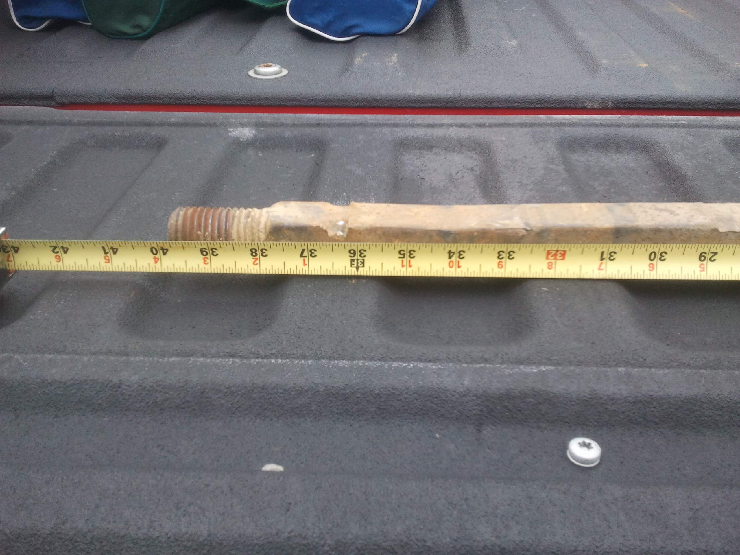

#3) Recently replaced a worn axle on another disc, see attached picture. The blades wouldn't ever tighten up and would spin on the axle. While checking mine I found the axles also showed similiar signs of wear, but have no issue tightening up. One of the axles is slightly bent and I plan on changing it anyway. As long as the blades tighten up and don't spin on axle is it worth changing out all of them while I have it apart?
Thanks in advance for all suggestions.

I would adjust the rear gangs to collect the dirt thrown outwards by the front gangs, no more and no less. I would pick a gear around 5 mph which would allow the front gangs to throw the dirt outwards. If you set them too far out you will leave a rut in the middle, what you want is to adjust them where they leave the ground reasonably level.
For the 22" blades, just make sure you have enough clearance for them. Recognize that larger thicker and heavier blades will put more stress on the axles too.
Might be able to weld up the notches in the axles but I would be concerned about loosing the temper. If you add some spacers (think thick washers) to the inside end of the axle you should be able to offset the notches enough to expose the blade centers to a new portion of the axle that isn't worn. I would consider adding about 3/8" spacer to accomplish this.
I wouldn't change out all of the axles, I would try to straighten the bent axle and if I didn't have success I would change only the bent axle. When you tighten the axle and hub assemblies around the blades the axle should be in tension. For this reason if it has a slight bend in it you should be able to straighten it and reuse it. The blade spacers play an important role in keeping the blades aligned as well as keeping the axle from bending, so keep the axle end nut tight.

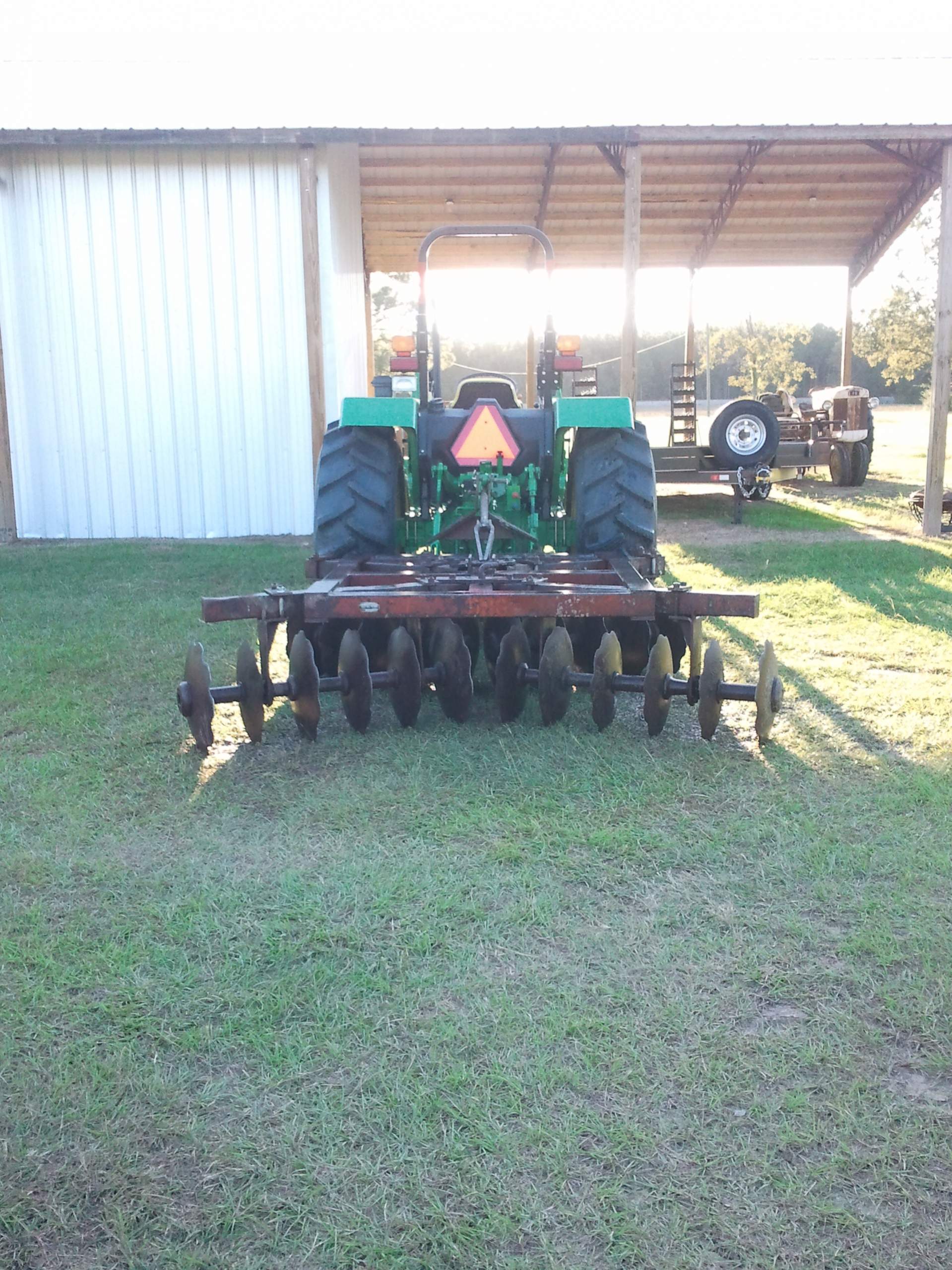

Speed wise that is about where I am running. Current settings is leaving a smooth and level bed. I am not satisfied with the 3 pt hitch set up. It is allowing to much movement and allowing the rear to rise. By the time I extend the top link it isn't leaving much clearance when lifting to turn or transport.
As for the 22" blades, I don't think I will have a problem with clearance. Most of what I am seeing with 22" blades is on 1-1/8" axles. It appears a popular combination that must be holding up pretty good???
Good idea on the axles. Had not considered the washers as spacers to get to a new part of the axle.
I got this disc for what I felt like was a good price and don't mind spending a little on it to get it right. The frame is 4" square. I even considered replacing some of them. One of them is rusting on the inside. Picked this disc up last week in Summit. You probably familiar with Summit just outside of McComb.

I intended to take a picture yesterday of the finished product after using with the rear gangs moved in. I could not tell any noticeable difference in the plowed area, other than the 1' less turned. In my thinking as long as it is pulling in what is thrown out, the extra set of inside blades will only cut more, give more weight and still allow me to move it back out to 9' wide if I ever see a need to. It looks different than most as all that I have seen have a greater separation between the inmost rear gang blades. I thought I would put this out to see if anyone had ever done this and had a bad experience due to something I was overlooking.
Think for time being will leave at it's new position and begin looking into the blade replacements and 3pt hitch. Once I get the structural like I want it I plan to finish it up with a new coat of paint.

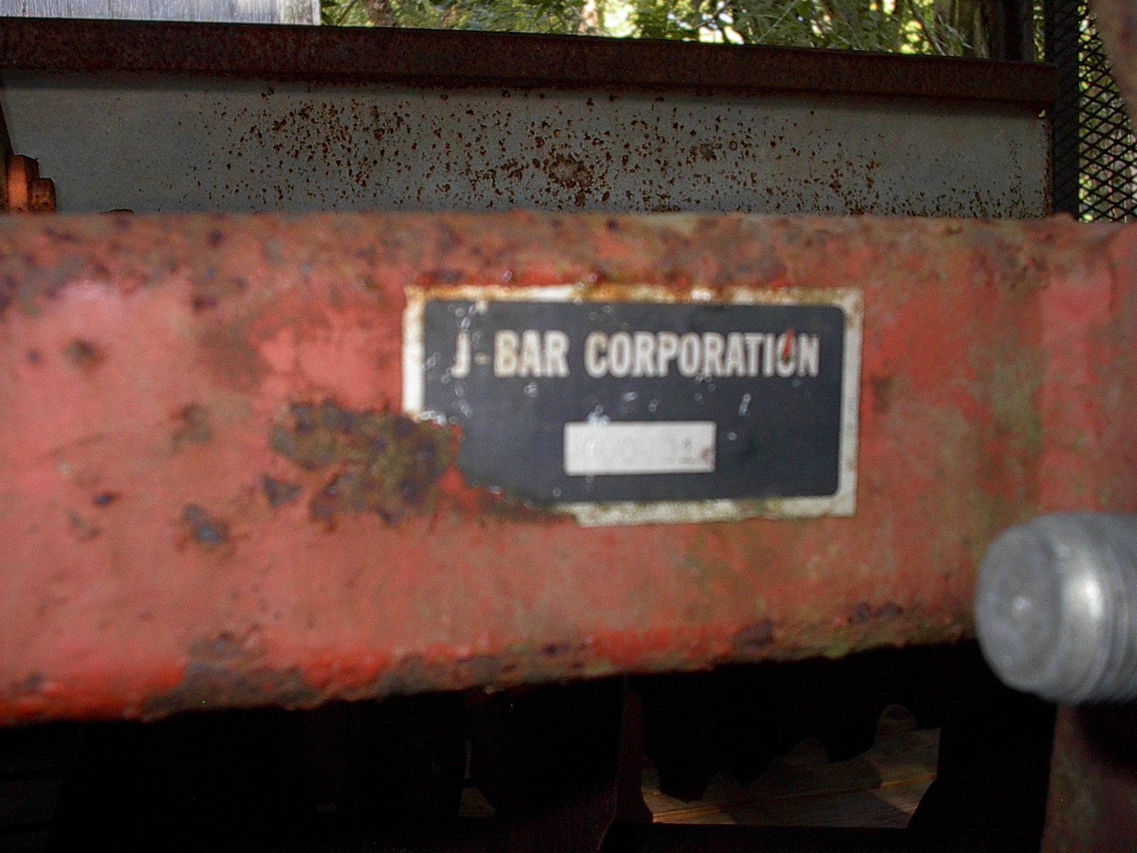

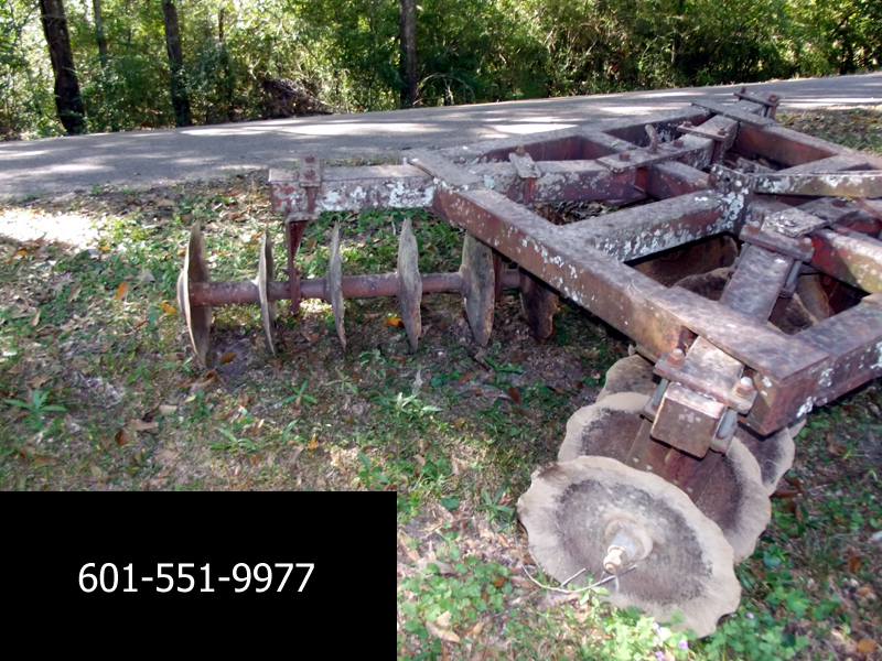

I have about that same model Long disk that my dad bought new in 64, except mine has the hinged frame so you flop the back gangs up over the top. It came from the factory with 22 in 7 ga scalloped disks. I usually run it with less gang angle than you show but with one or two railroad track sections bolted to it, more cut less throw I guess.
/ Disc Harrow Alterations
#18
I tried to track down the manufacturer and found out they changed names once and then went out of business. I found W R Long in the same town and was able to speak to someone there that verified they were no longer in business. I would like to find out what the specifications were on this unit when it was new, but doubt I will be able to track that down. How did you determine this information on the unit you have?
