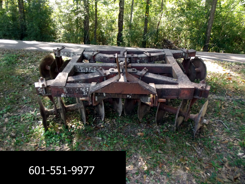

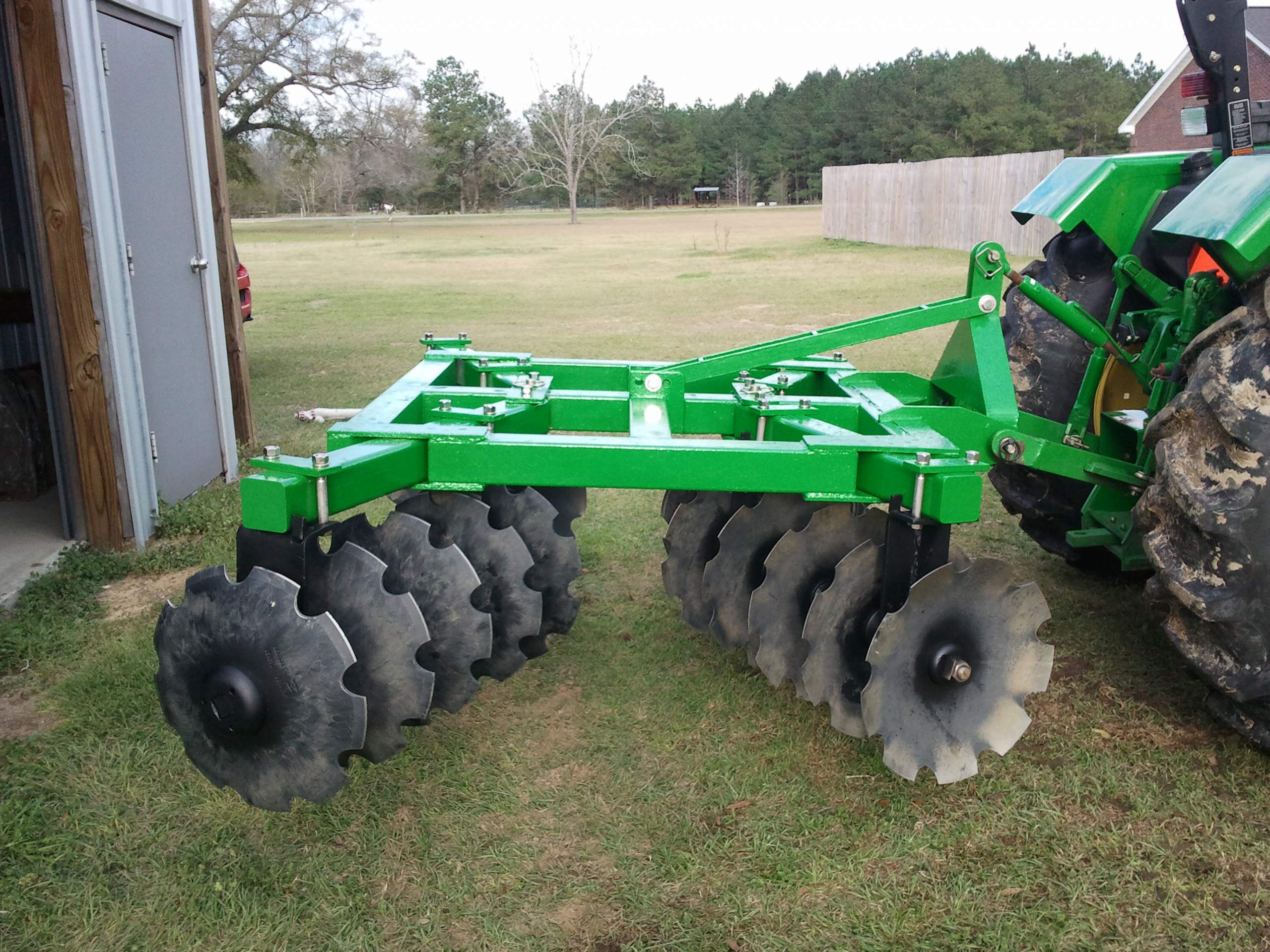

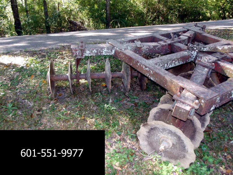

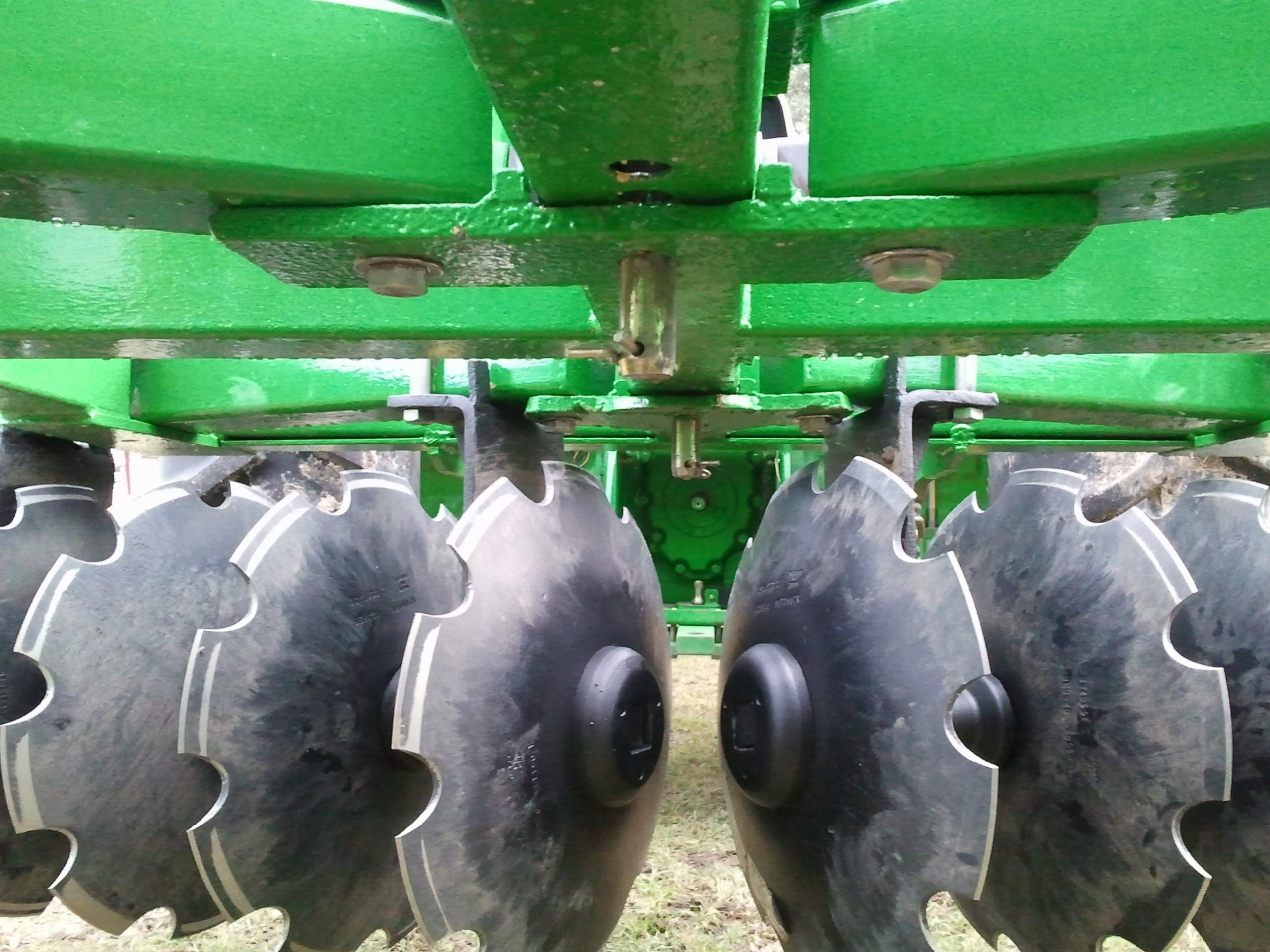

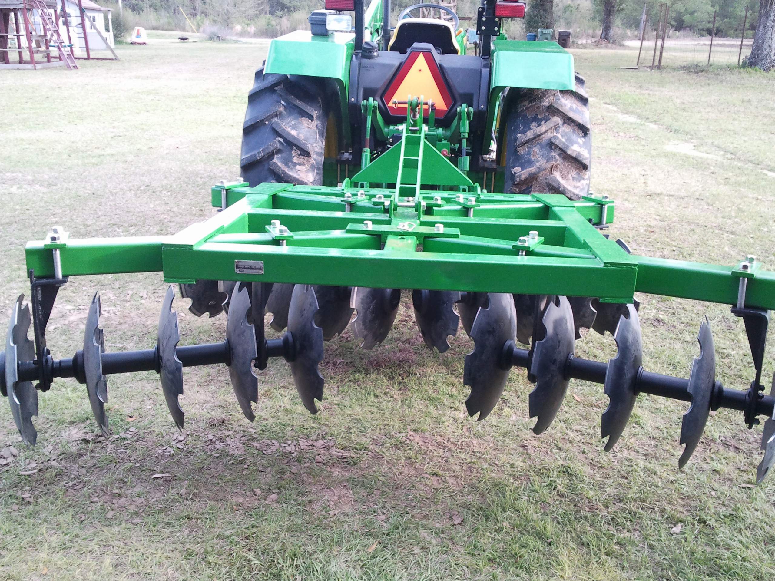

While reassembling I had to add a 1" spacer to get my 9" spacing on one section on one axle. Was able to take it back apart this morning and found the correct single piece locally to correct having to have two. Tightened everything good and turned under about 4 acres. Tightened everything again and am getting little to no movement. Everything seems to be tight and staying that way so I folded over the keepers. I made an adjustment to the rear gang and it seems to have helped with cutting more level. Thought I would need the rear as aggressive as I could, but works better moved out one position.
This is the final post I plan to make on this thread. Thanks for all of the input, advice and suggestions along the way. I am very satisfied with the end results of this project. I spent a little more than I planned to, but in the end believe the numbers work out to be around half of what a comparable new disc harrow would run. Here are a few pictures of before and after. I took one of the bottom to show how close it is with the 20" blades and how 22" blades may have been too tight. I think they would have cleared, but not by much.

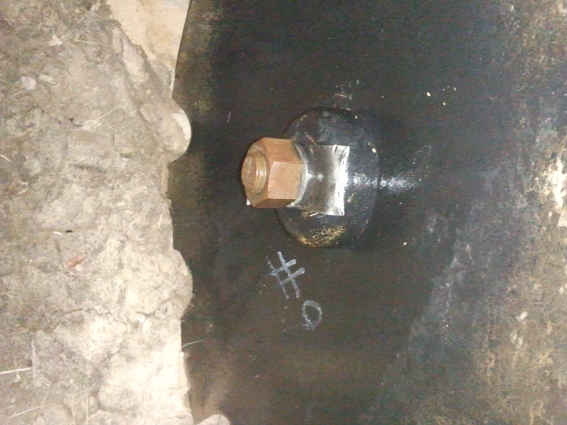

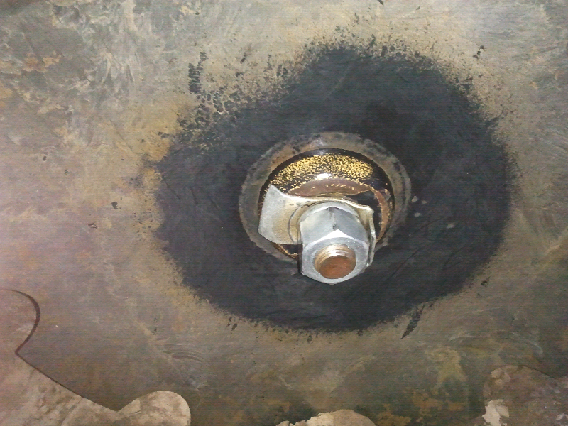

Have had opportunity past few weeks to do a good bit of disking. Last weekend while on my last location for the day after four or so hours of disking I noticed my front left blade had come off. After checking closer I noticed the threads on the end of the axle were damaged. Re-cut the threads and reassembled with impact wrench again. Turned under about an acre, checked again and still tight so I folded over the tab.
Did about another four hours or today and noticed it was loose again. Any suggestions?
   / Disc Harrow Alterations #89
........Did about another four hours or today and noticed it was loose again. Any suggestions
Clean the threads and apply some medium strength (or high strength...just have to heat to remove in the future) Loctite and tighten it up again. I have a suspicion your lock tab is moving.
   / Disc Harrow Alterations #90
I agree. The tab lock you have is too soft and not holding on the big hex. Also, I suspect looking at it, someone made it and it is too thin. If too thin, it will act as if too soft and move to allow rotation.
