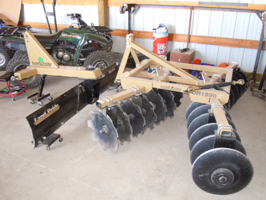

I have a 66 Hp tractor and pull a disc similar to what you are looking at. (mine is land pride) Like the other posters have said it will work fine. I too could go much faster but I just cruise at a nice speed and let the disc work. DSCN1960.JPG

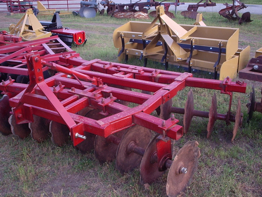

A little more information.....I had about 10 acres clear cut and stumped. Trees were hardwoods from about 10-30". The guy that cleared it used a Dozer with a single ripper behind and then went back with a root rake blade. So the land is in pretty good shape but lots of smaller roots in the 1-2" range and maybe 3" max.
We've had a bunch of heavy rain followed by blistering heat kinda weeks. So the land is crusting back over and starting to get a lot of plants shooting back up. I want to disk it up, rake the rocks and roots, and then get some amendments and some kind of ground cover back on it.

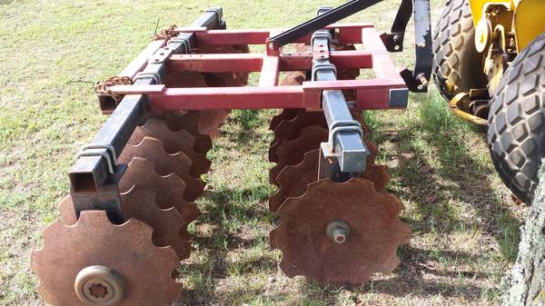

Ideally, I'd like a drawbar type but most of those are out of my price range even used. So the ones I'm looking at are the Howse for $850... Howse.jpg
It can fold up like a bog harrow and actually looks a little more beefy but I think it's only a 6 foot and the guy wants $1000. Other than that, I can't find any specs on it.

Howse is a fair Disc Harrow. I owned a Howse 16/18". However, a Howse is not really that strong, it is a hobby-farm disc. I think you have a good probability of bending pans in collision with subsurface rocks or breaking the frame should you weight it AND pull it behind your heavy tractor. Strapping 350 pounds of concrete on a 900 pound Disc Harrow is ludicrous. Note that Howse gang angle adjustment pins penetrate through the main frame, weakening it.
Is it possible to have too much hp for pulling a disc harrow? I have a Mahindra 6530 4wd with Ag tires.
I've been looking for a good used disc for some recently cleared land and found a Howse model# HTR22022B.
It's 22 notched 20" discs and weighs 887lbs. I realize this is a top of the ground vs in the ground implement so I don't see a lot to bend or break.
With 22 pans, spaced at 7", this Disc Harrow will have a lot of float. My guess would be that max penetration of the soil will be about 6" with the gangs set aggressively, after 3 to 5 passes. It requires a MINIMUM of forty pounds total Disc Harrow weight bearing on each pan to accomplish much. Fifty pounds plus bearing on each pan is much better.
Is about 6" soil penetration enough for your needs?
How much patience and restraint is in your character?

@jeff9366 Also, I'm not 100% certain but I think it has 9" spacing. You mentioning the adjustment pins through the main frame does give me second thoughts though. I looked back at the King Plow harrow picture that I posted and saw that it DIDN'T pin through the frame. But, again, it's a foot and a half narrower, $200 more, and the disc are much more worn.
As for soil penetration, 6-7" is probably enough. If I have to make several passes then it is what it is. Once I get this done I doubt I'll have much need to work it that hard again.
