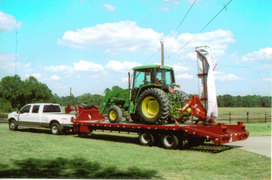

I have a Kuhn GMD700HD mower. It's the second Kuhn I've had, first one lasted 15 years. They are a very well-made mower. Expensive. Cuts good, easy to hook up when you get everything adjusted. I've seen the mower caddys. It would be a good thing to use on a lighter high horsepower tractor. I don't need one because my 6400 handles the Kuhn like it's not even there.

That's the 8 rotor version of my mower. If it's mounted on the tractor and loaded on a trailer the height becomes an issue. If you never leave your property then it wouldn't be a problem.

Ok - when it is in transport mode - it will hit bridges eh?
I am planning on only doing my place.

I think the bigger worry is power lines or tree limbs. My mower is a 7 rotor and I have to be careful where I drive with it. When you raise them vertical and then load them on a trailer they're a good ways off the ground.

I don't think anyone around here uses a mo-co for coastal. If anything, buy a tedder to fluff the hay if it's extra thick or if it's been rained on. Under normal conditions, I can cut one day, tedder that evening and then be able to bale on the second or third day. This year I usually baled on the next day.

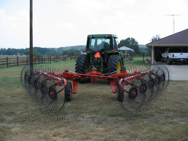

What kind of rake are you using?

I bale coastal bermuda, sometimes mixed with bahia. I bought a Kuhn SR110 speedrake when I bought the mower. Does an excellent job, and very fast.

Jesse, very nice setup. When you say you can hook up your cutter easy once its setup, How easy do you mean? Do you have a particular way of parking it on a stand or something? Reason I ask is, my buddy doesn't hardly bother cussing and fighting his in position unless his FORKLIFT is broke. Yes, he uses a Clark forklift to help position it so he can hook up the 3 pt. He would like to have a caddy but keeps needing other stuff more.

I built a stand out of treated lumber so the mower stays off the ground. As long as it stays level I don't have any trouble hooking it up.
