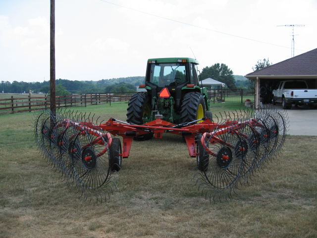

I bale coastal bermuda, sometimes mixed with bahia. I bought a Kuhn SR110 speedrake when I bought the mower. Does an excellent job, and very fast.
