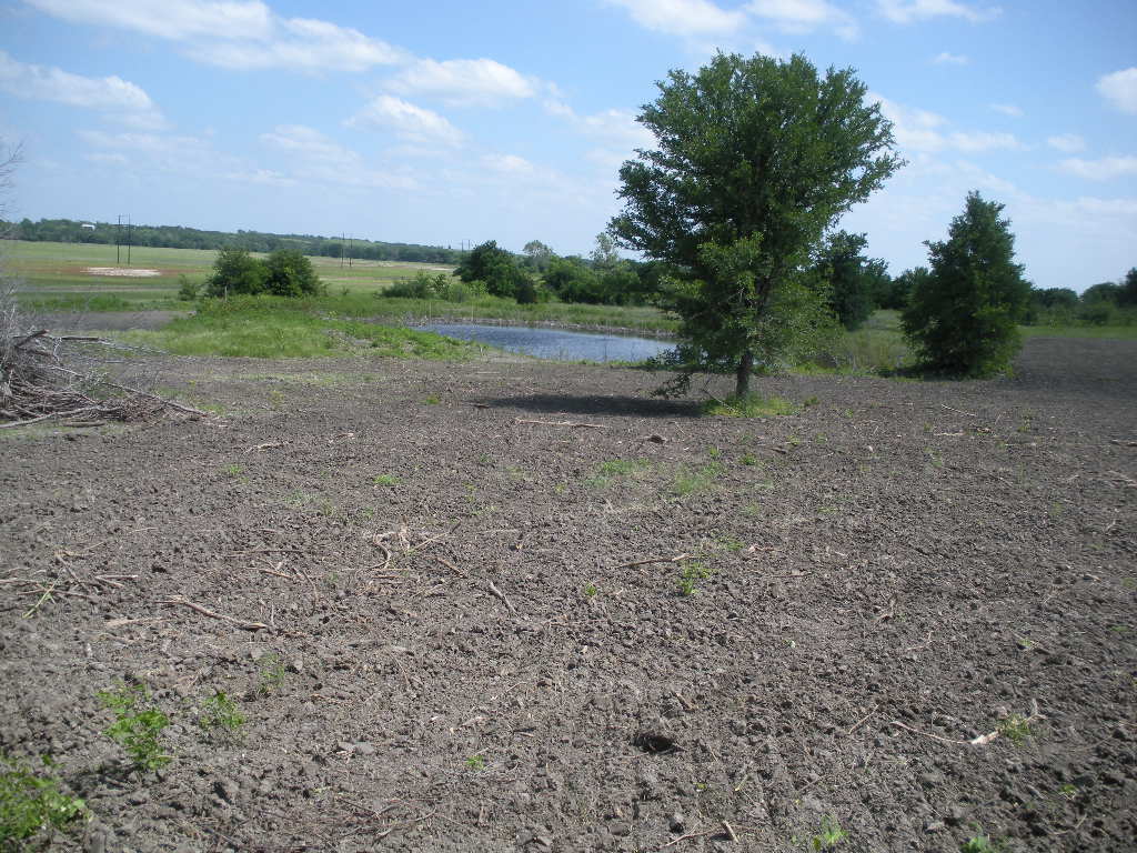

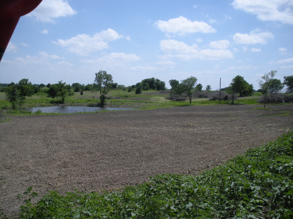

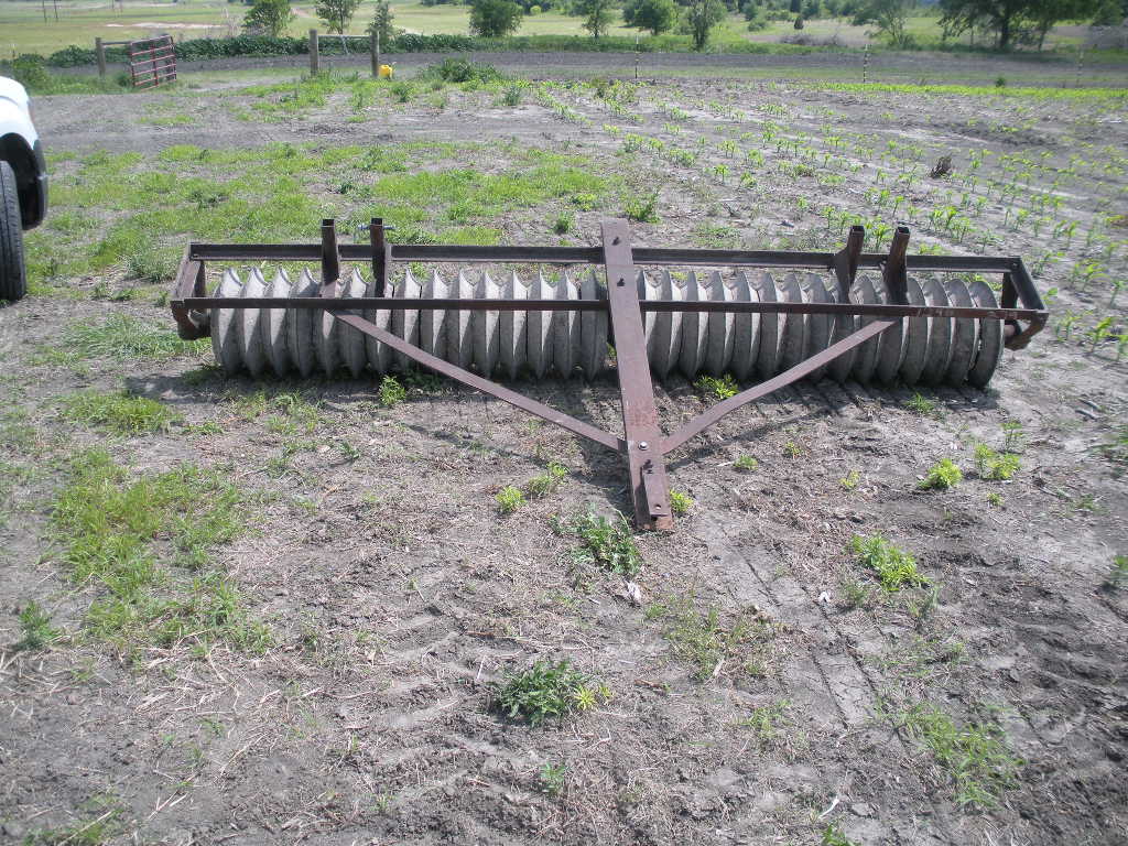

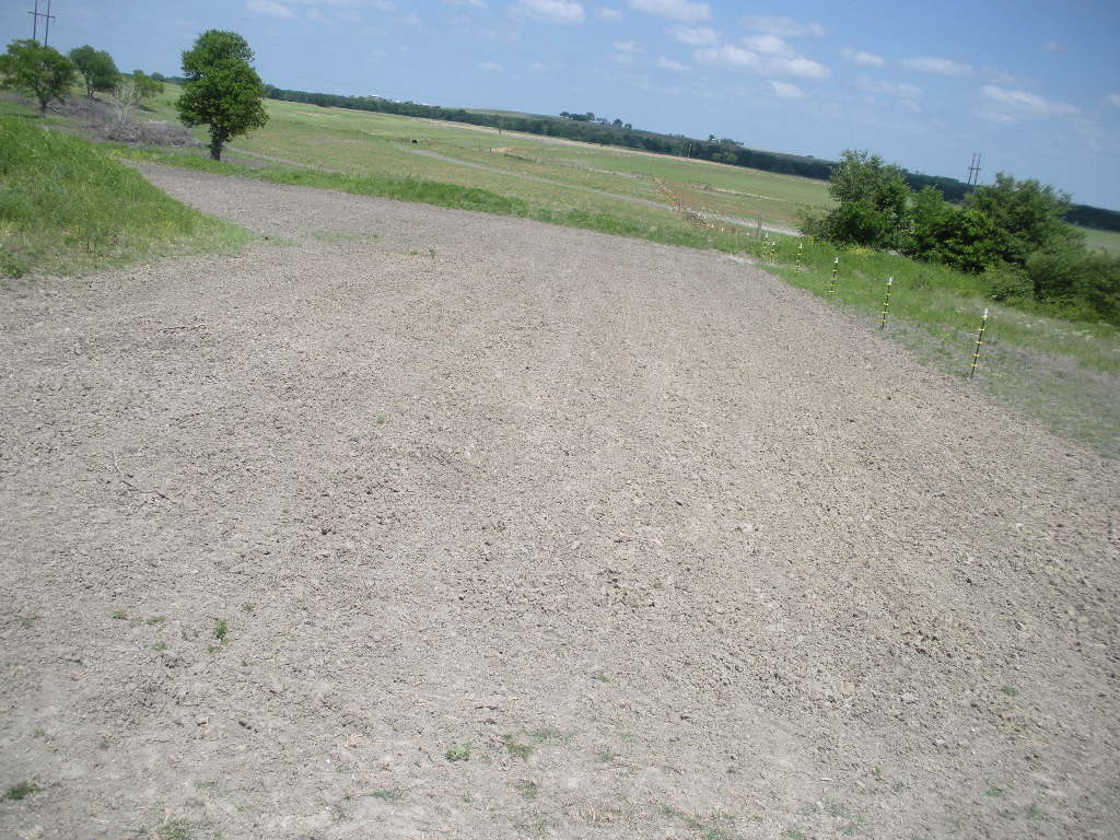

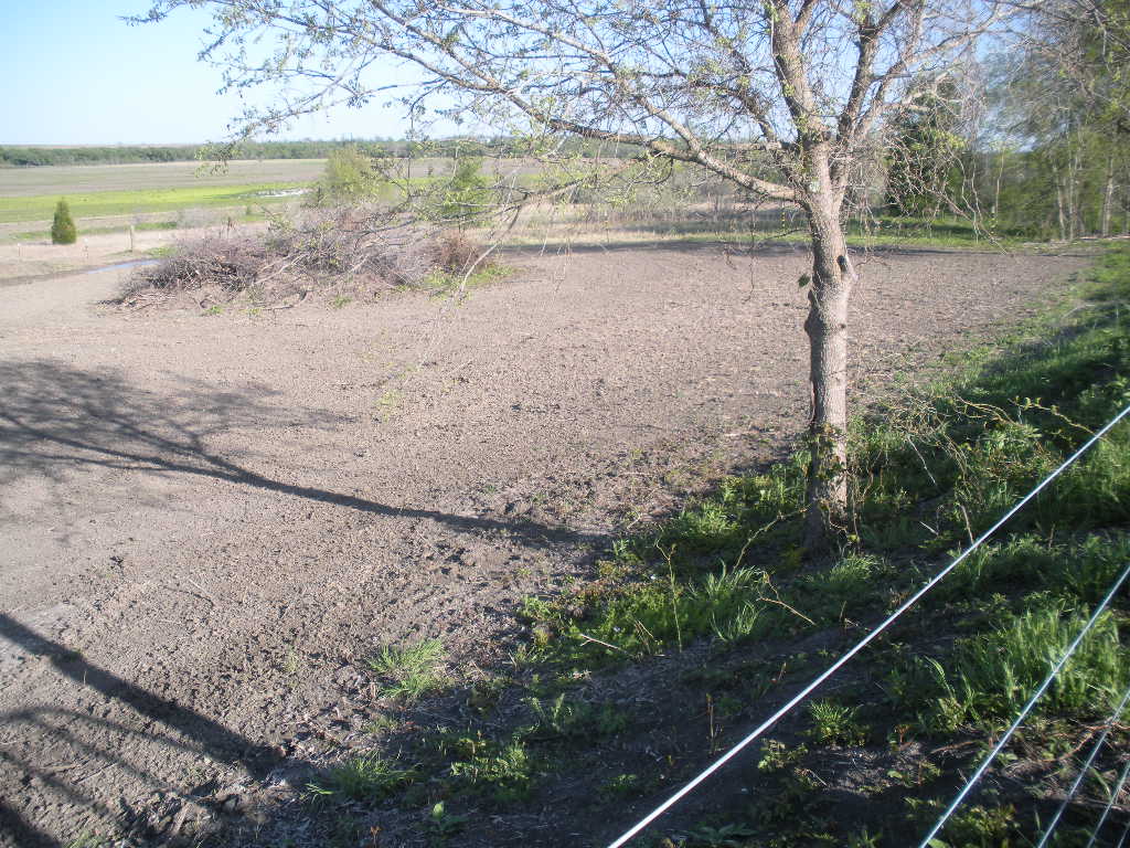

The acreage I am working on is all sloped and terraced and had not been worked in any way for at least 30-40 years. When I mowed there were many spots where you had to crawl over it or get rattled to death.
I have attached some pics at what I have arrived at as seedbed.
To get to this state I subsoiled with a Fred Cain Subsolier I got from Everything Attachments, Disced several passes in different directions and then Cultipacked in two directions.
I did not get much penetration with the old disc I started with. The Hay King disc I got to replace it only required 2 passes to get 6-7 inches deep. Discing levels things out to a surprising degree. The old cultipacker I bought did a good job of breaking up the clods from the discing and firming the seedbeds up.
If we get some rain that should finish melting the small resulting clods . I am wanting to get the Bermuda seed in the ground but I think the dirt needs to be a bit more broken down to do so.
