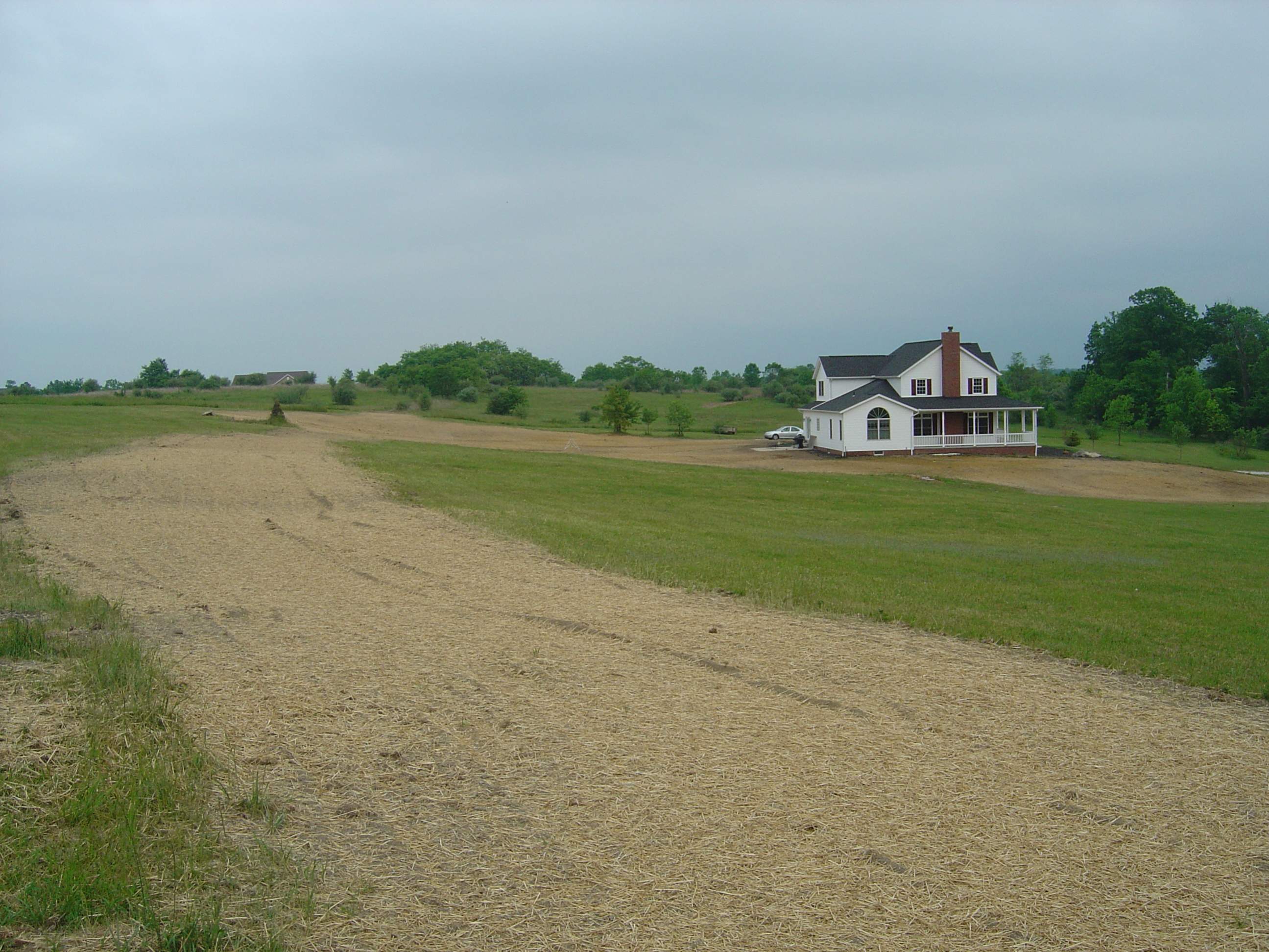

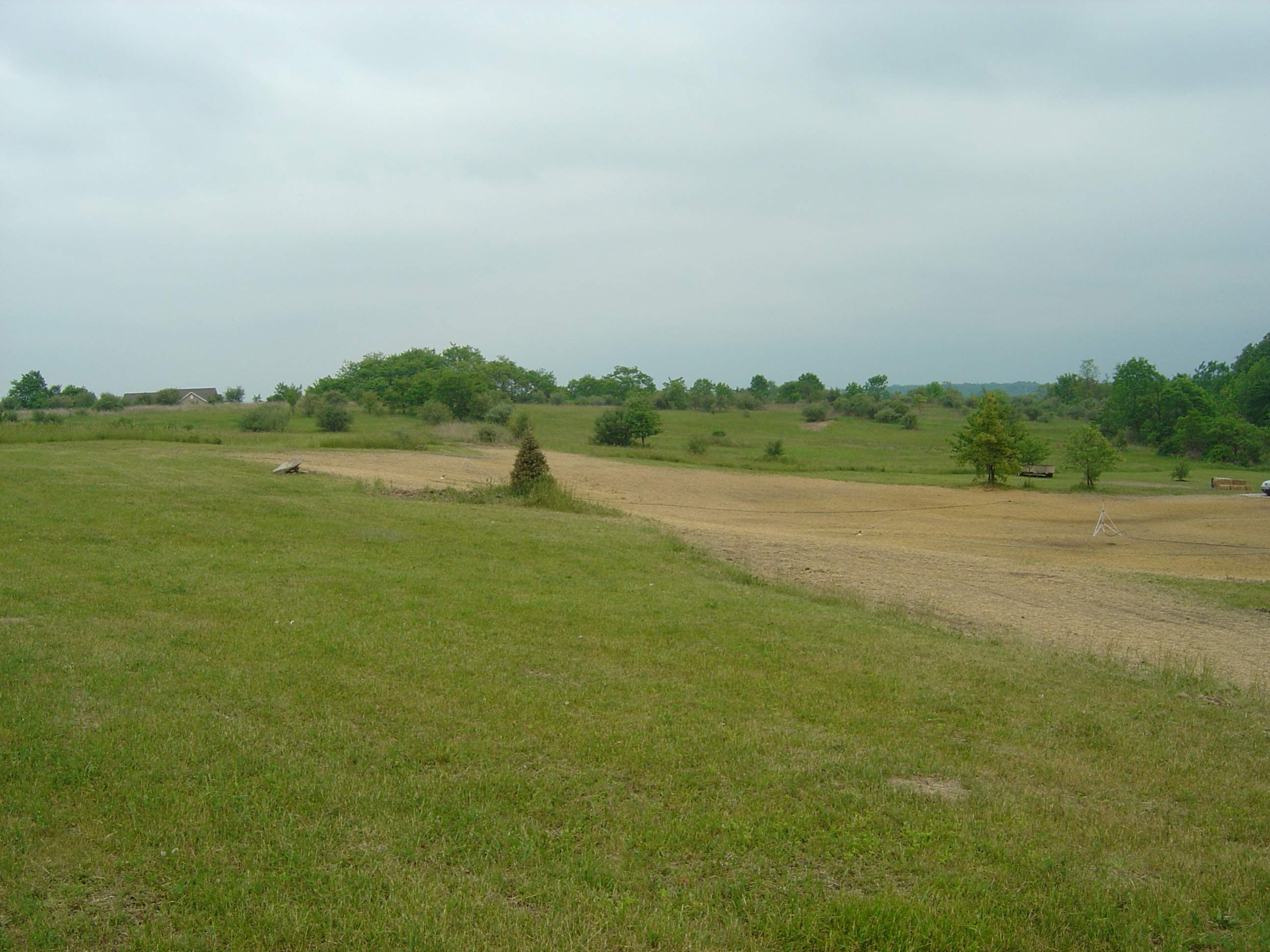

I used a New Holland TZ24DA to pull everything. It's a 24hp Hydro, 4 wheel drive. I initially tried to run the plow thought the clay soil, but the fact that it had not been touched in roughly 50 years, it was pretty compacted and tough for that little tractor to pull the plow through. I used a middlebuster to loosen the soil, and then I had good success with the plow.
Funny you should mention about the implements...I'm actually "upgrading" this week to a New Holland T2320 (should be delivered Friday), which is 45 HP, with an 84" Bush Hog rear finish mower, FEL, etc. I currently have a 60" MMM. Like everyone else replying to this thread, I get bounced around quite a bit on the areas I haven't smoothed yet, and I would like a little more hp to help with future projects, such as the one we are talking about on this thread, so I am hanging on to the implements as they will be needed in the near future.
I have a landscape rake that I used for a variety of projects (and I have used it for smoothing, works really well), but for this project, I used a homemade drag that is essentially a rectangle made of 4 pieces of I-beam iron. It's quite heavy, but the NH pulled it with no trouble (I am going to miss the little tractor). I disced the ever living heck out of it before using the drag, which seemed to help with the large clumps. I used a small boxblade for the final grading.
As far as the rain making ruts, I rented a straw-blower (~$90 a day), which covered the areas I had worked in minutes, not hours. It was quite a wonderful piece of equipment, and very efficient in its use of the material as well. I have attached a few pictures of the last time I used the straw blower, and you can see the large area it covered. If you can't seed right away, it's easy enough to run over the area just before seeding, once you have the ground worked to your satisfaction, with the disc or landscape rake to loosen/smooth the soil.
I live just south of Navarre, not too far from you, about an hour or so.
