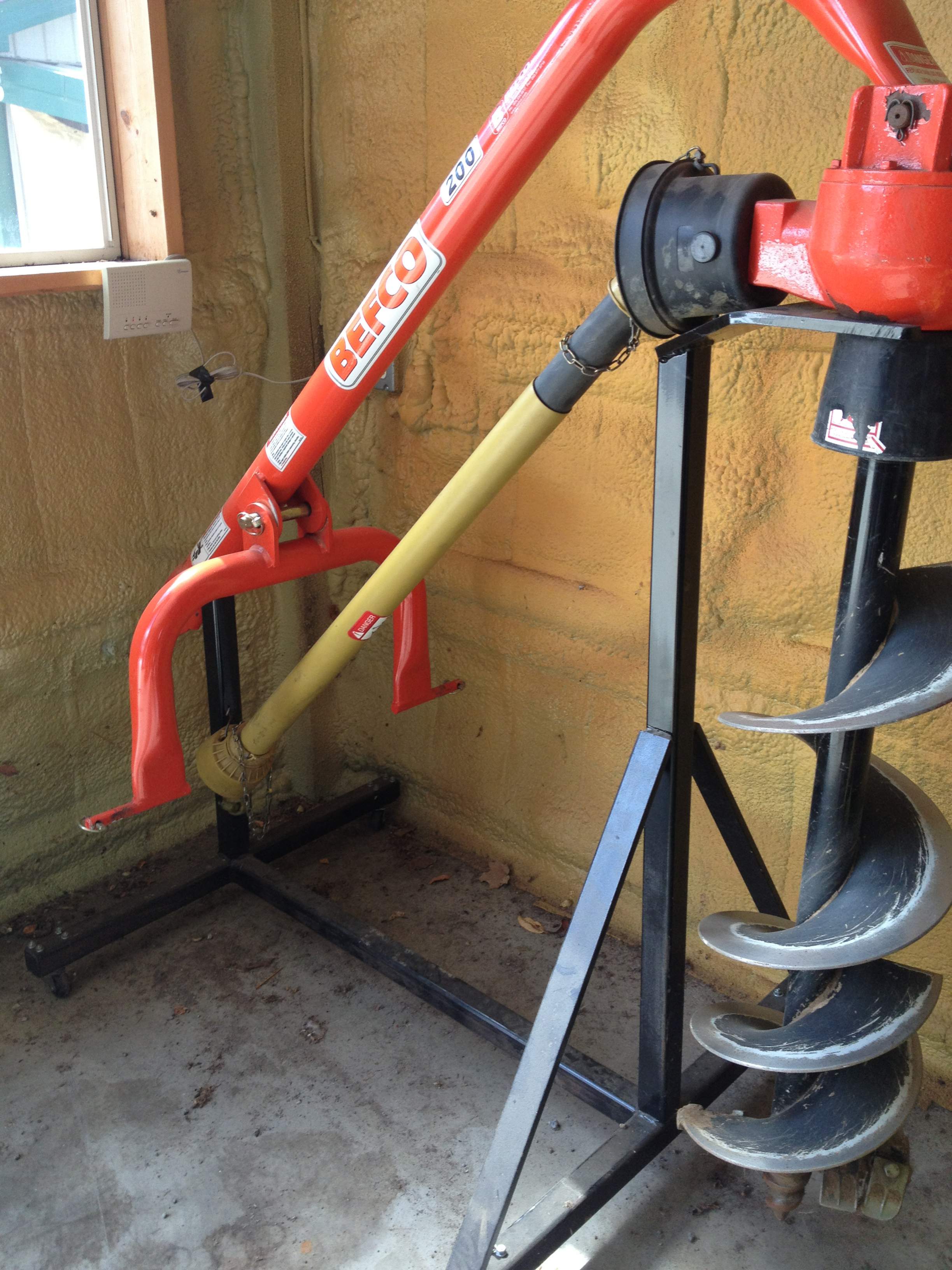

The post hole digger is the one that kills me. I hang it from a tree limb now by the middle of the boom and it seems to help allot.
Here is a few pics of my post digger stand with wheels & land plane cart.
I like that. Pretty small footprint too.
