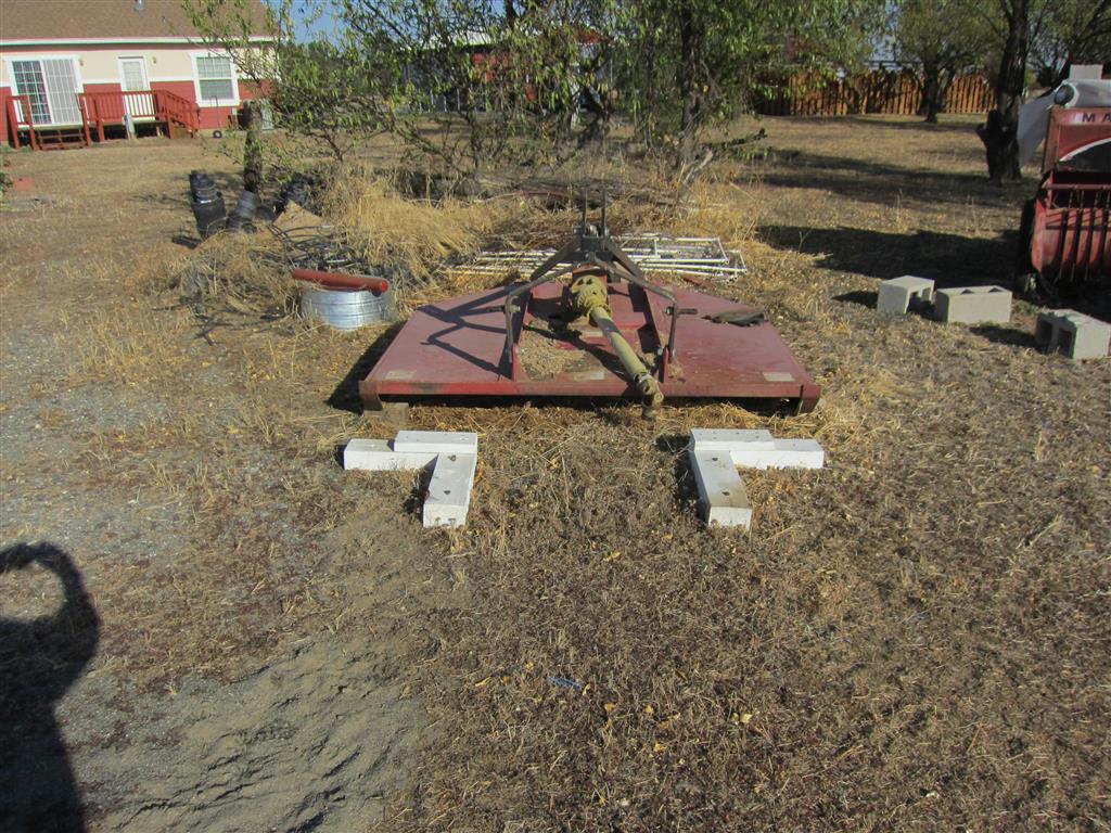

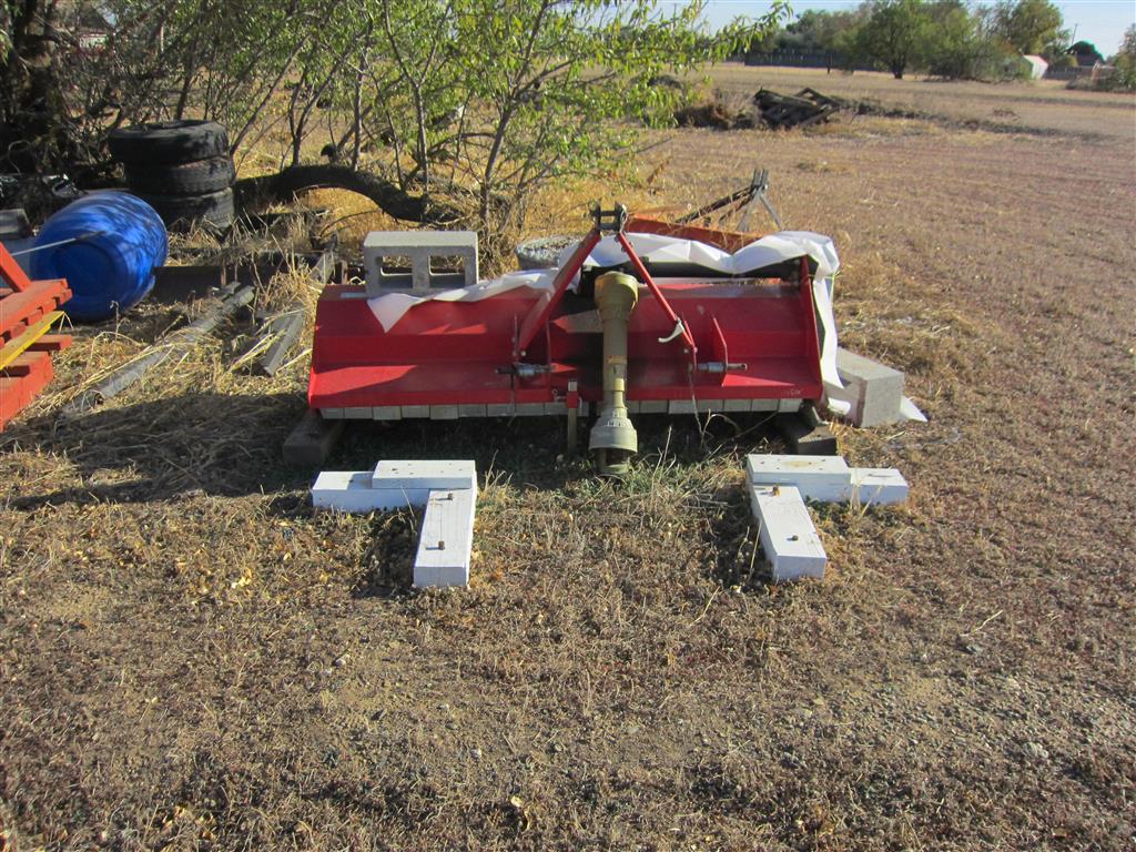

I'm a old geezer and can feel my age creeping up on me. So to make life easier when attaching implements to my tractors, I use wheel guides like these to get the 3 pt hitch aligned to the implement pins.
A few lengths of 4x6 lumber, holes drilled for round metal stakes to keep them in place, painted white for visibility. Get the rear wheels of my Mahindra 5525 aligned nearly perfectly to reattach these mowers. Only a minimum amount of levering needed via the 5-ft pry bar to finish the hookup.
