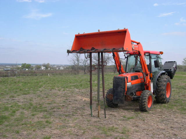

bassin20, if you are intending to drive T posts, you already have a post driver... your FEL... or FLE as your public information says:D

YES, Your absolutely right about the FEL being used to drive "T" post. My biggest problem is having extra help needed to do it using the FEL. Most of the time I am working alone so I have to figure out ways one person can accomplish the task with out getting hurt. althought the exercise climbing up and down off the tractor isn't a bad thing either. Thanks for pointing out my spelling error, when you open up your profile box it doesn't let you see evrything you have written. So up until now I didn't know I typed it in wrong. thanks.

Well this may be more fun. If you are down south, this time of year where the gound is damp, bed rock is 1000+ feet down, and your not in that red clay, you can actually drive T-posts probably 5 to 1 and it be just about as easy. About 3 decent wacks to cover the blade thingy and move on. In 1999 we had a real long hard drout and were putting up some fence around deer feeders. This was not hard soil. Took 3 guys rotating about 25 wacks to put one down(and Frank goes about 280). these were the standard cast type T's. While a FEL would have helped, I could see some post getting bent going into the ground...maybe all being bent. That same soil after the rains came...about 3 wacks to get into the top soil. I've never punished my hands more than that weekend.
